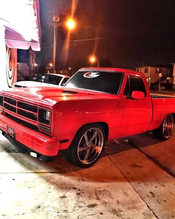

Hey guys! I recently bought a 1986 d150 and I’m planning on making it into an R/T. It has a 318 with headers and four barrel Edelbrock Carb. I’m looking to find out which idea us better.
1. To stroke the 318 into a 390 and change the Edelbrock carb for a holley efi to make it more reliable.
2. Look for a durango like a 2005 with the 5.7 hemi and move everything onto the 86.
I don’t want a race truck, just something that will hold its own on the street and be reliable enough to be a daily.
