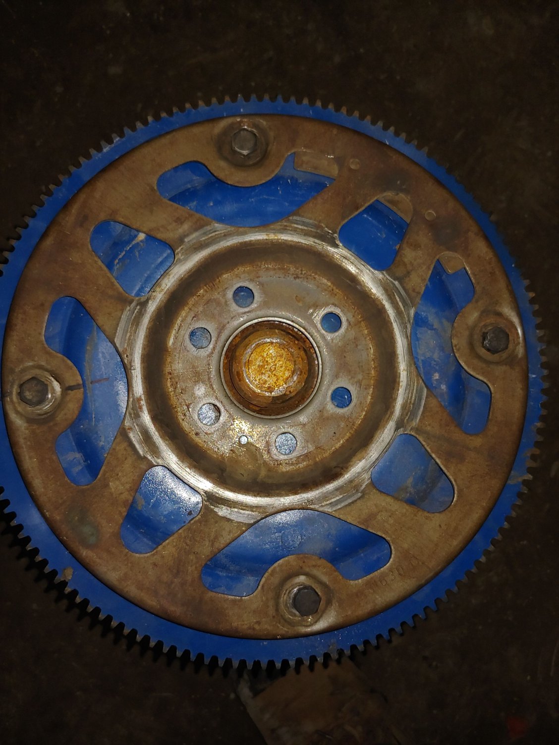

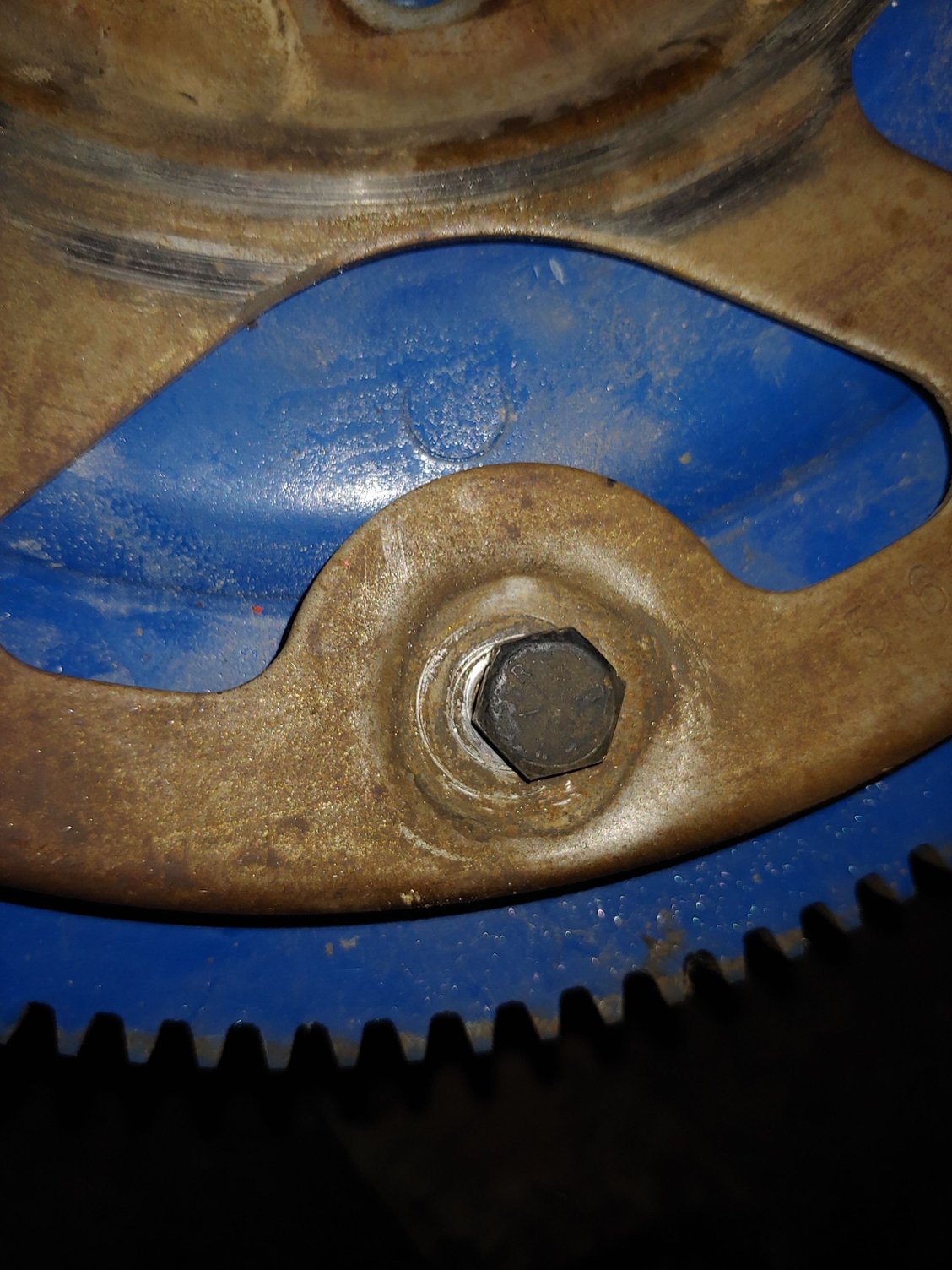

Just wrapping up a similar swap right now except I used a 727. You need a 96 and up engine. Get it with all the bells and whistles on it including the harmonic balancer on the front and the flexplate on the back. You'll know its a 96 and up because there will be 2 weights welded onto the flex plate. Your 904 should have a neutrally balanced TC (you'll see weights welded on it if it isnt neutrally balanced). Take the flex plate off the motor and sit it on the TC and youre going to notice that you will need to widen one of the holes a little bit in order to make it bolt up but nothing too crazy. Took me like a half hour and that was taking mm at a time and then checking how it lined up.
