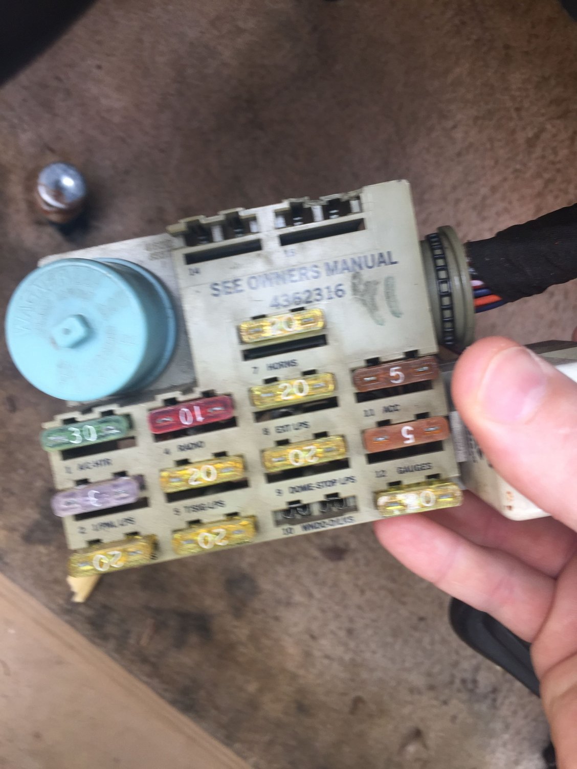

Here is the under column fuse box, and my brake light switch.

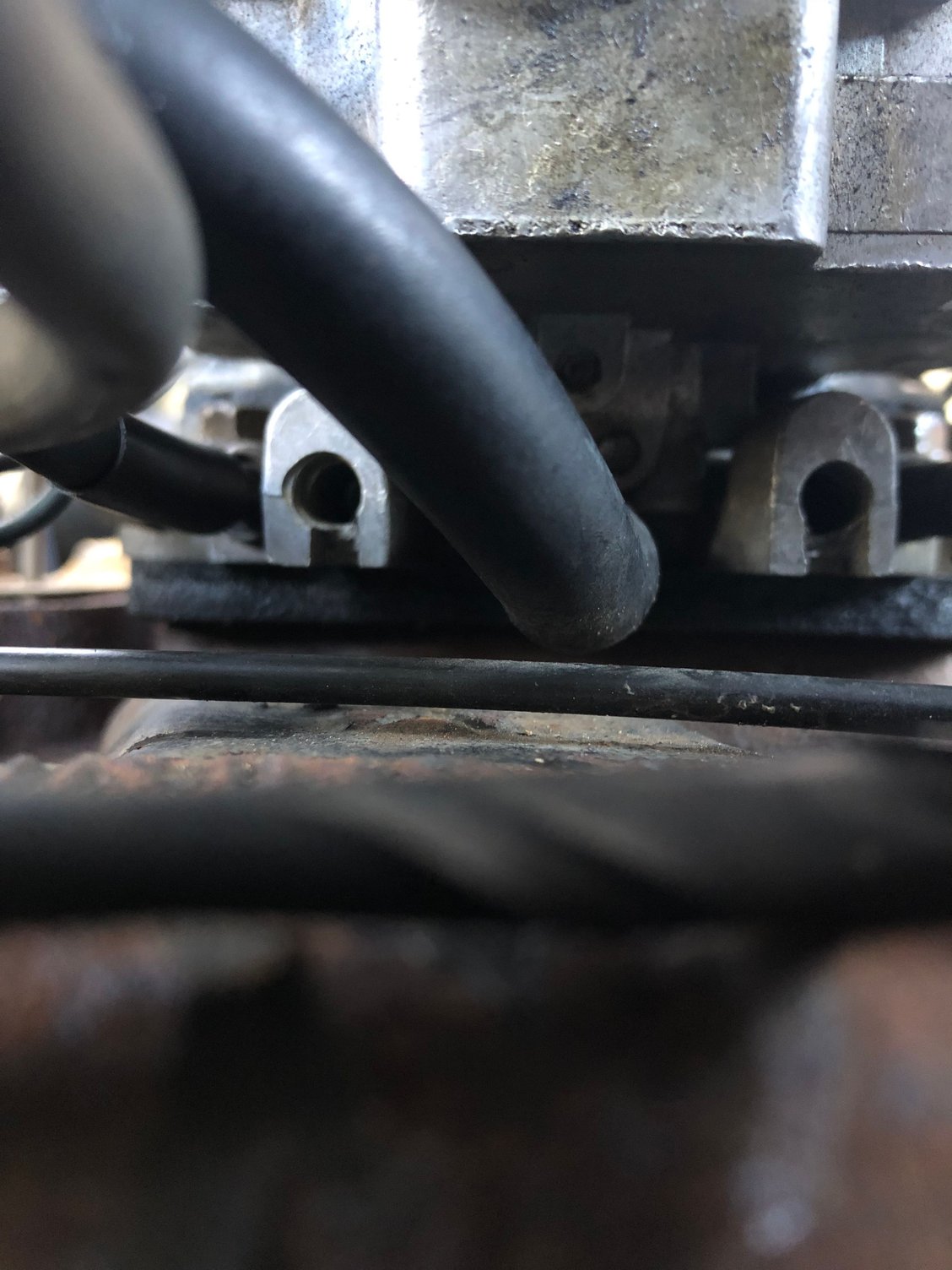

I still have EGR, and ESA, that are both functional. Although I believe one issue is the inconsistent vacuum reading causing the ESA to be trying to constantly stabilize the timing? The plugs over the idle screws have been removed long ago and can be adjusted with an Allen key. Truth be told though, if I wanted to be 100% sure I need to get a cheap tach so I have an RPM reading rather then basing it off of audible idle quality. As well as toss one of my old stand alone wide band O2 sensors in the Y pipe before the catalytic converter to measure idle AFRs since the lean burn carb is SUPPOSED to be non adjustable. Here’s an engine picture and the unblock idle mix ports. If someone needs a picture of something specific, let me know.

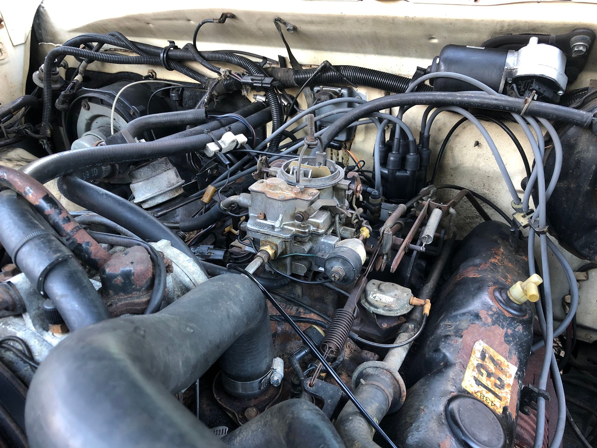

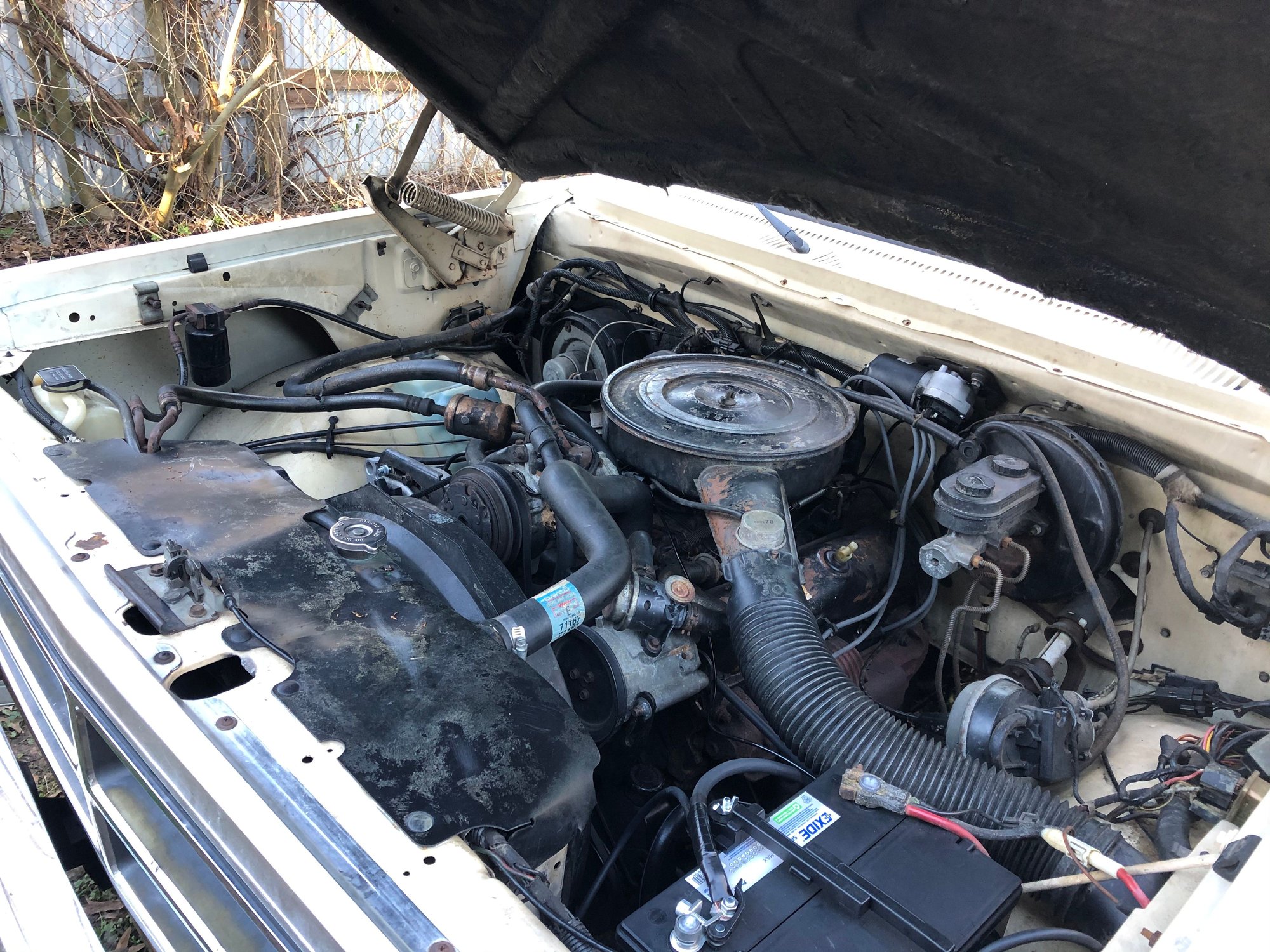

Complete engine picture,

Unplugged idle screw ports,
Old Jan 23, 2021 | 01:25 PM
