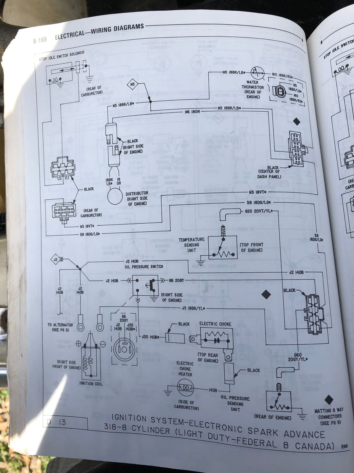

Default Here is another part of that ballast area.
When I looked at what my engine wiring should be, it doesn’t show to have a resistor, I just haven’t figured out how to solve the discrepancy correctly yet. Because it doesn’t look added in. 🤔
and as kind of a side thought, what are your recommendations as far as rebuild kits, or refresh kits? Brands to go with, or stay away from for sure sort of thing?
Not 100% on the white plug, anyone know for sure? Could simply be for a component that’s no equipped on my engine?
The ignition ballast resistor is usually on the firewall. The resistor in your photo is wired to the choke pull off heater. This gets the choke open faster for better economy. It's usually a little button resistor to act like a timer.
then my question becomes does my system even require on sense it’s not on my wiring diagram are there aren’t any vacant bolt hole on my firewall?
Old Jan 25, 2021 | 05:44 PM
  #28
Posts: 87,475
Seems to me a resistor in the line would reduce voltage going to the electric choke, therefore, it would take longer to open.....
