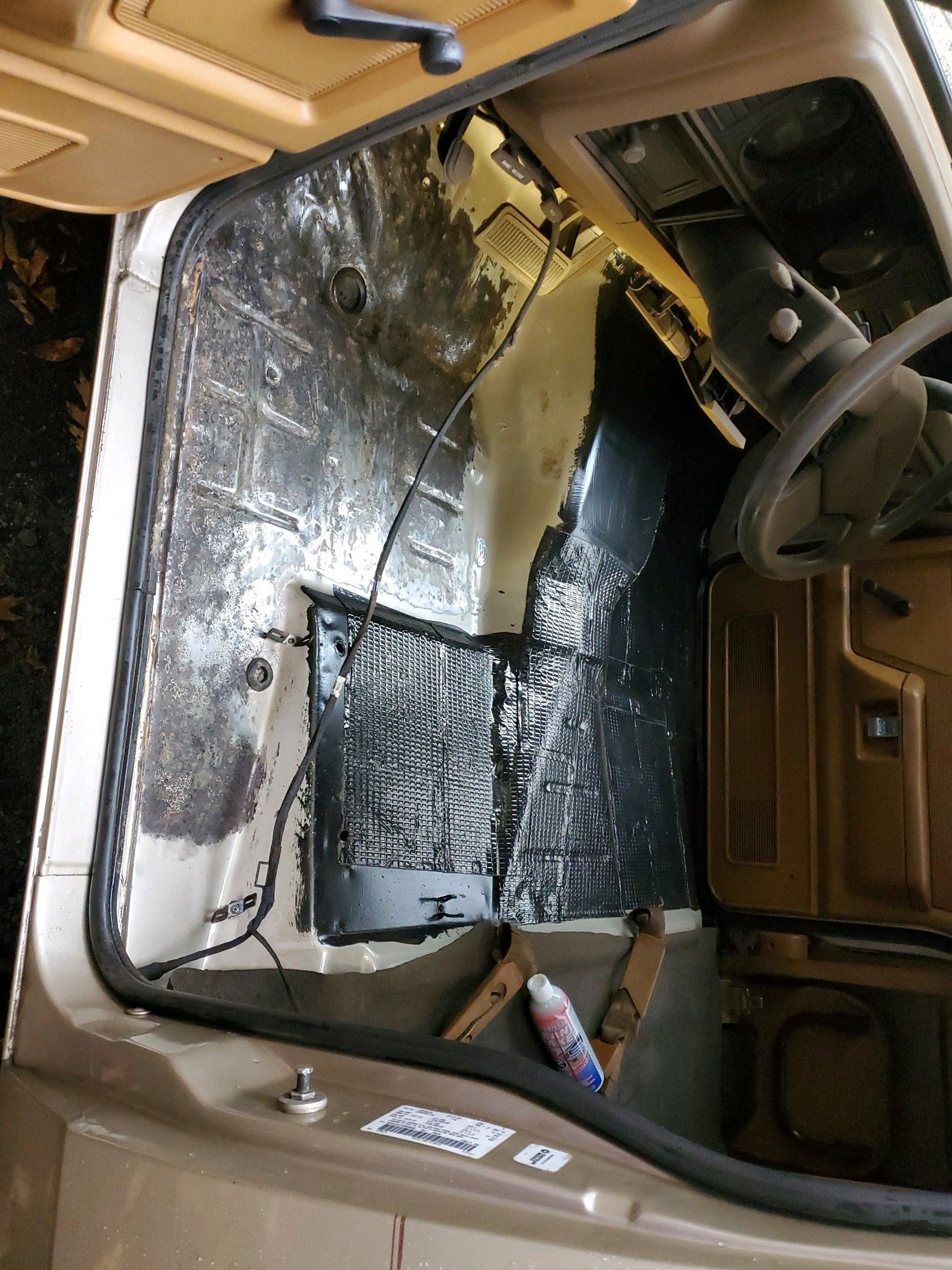

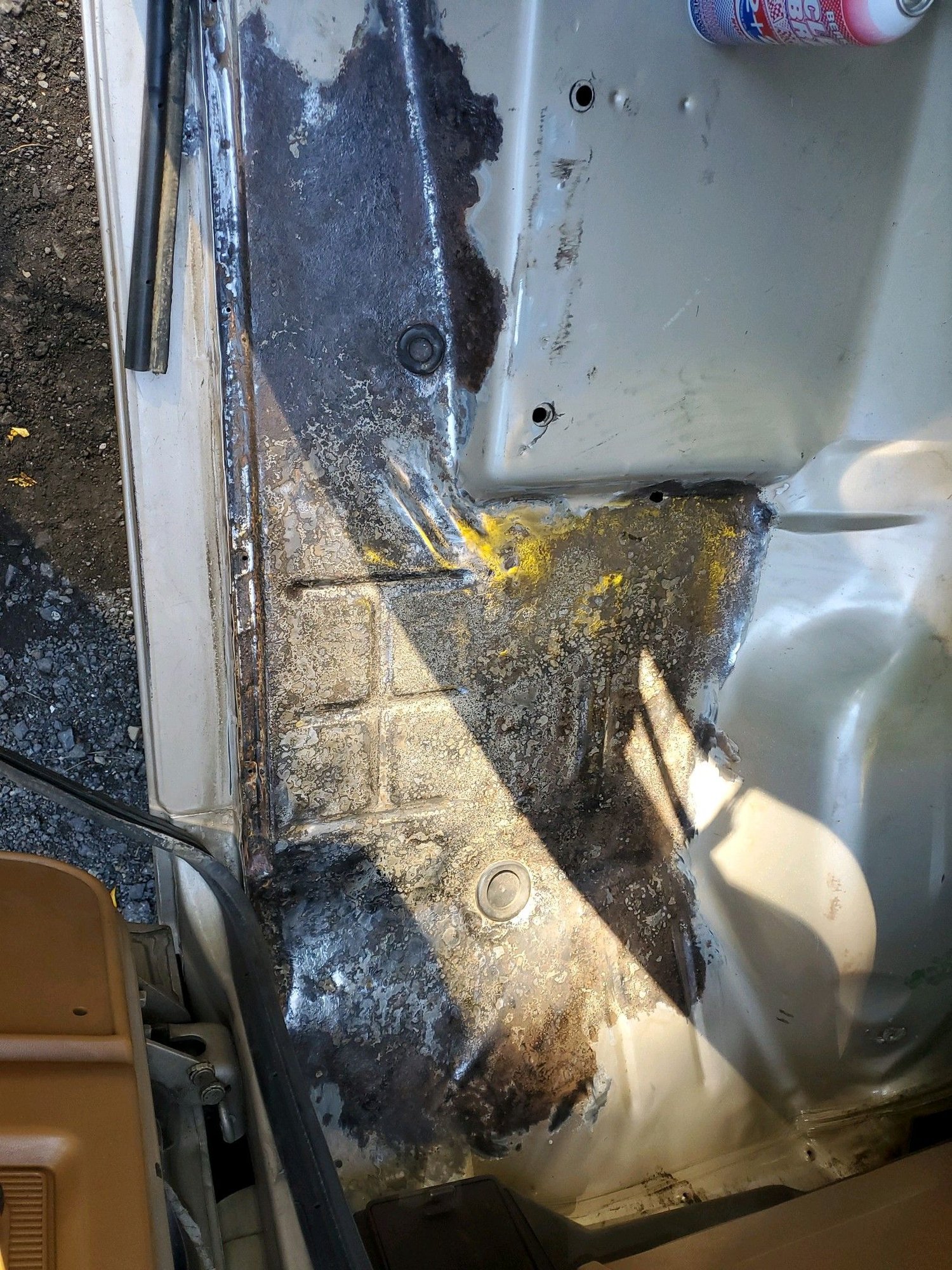

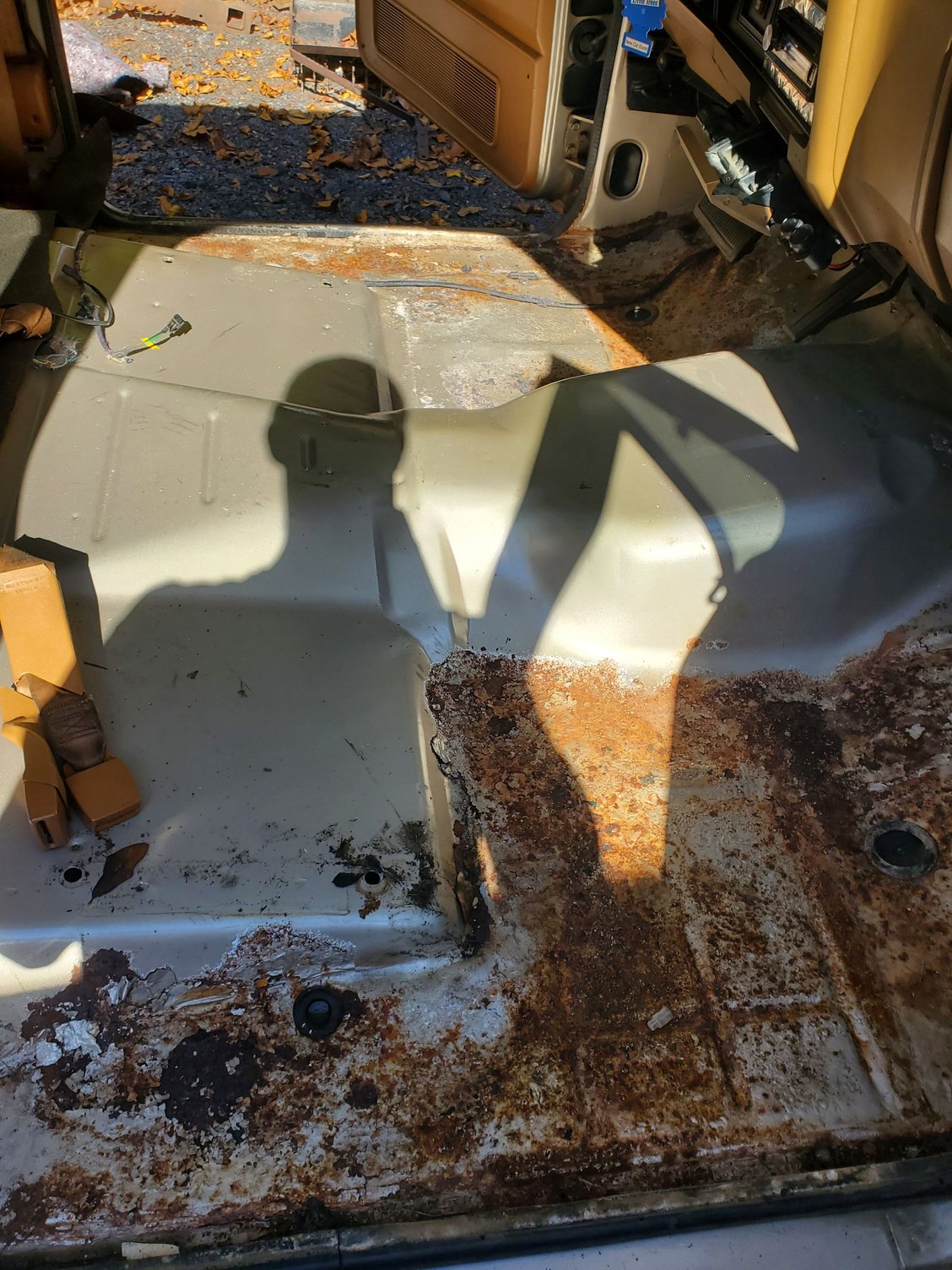

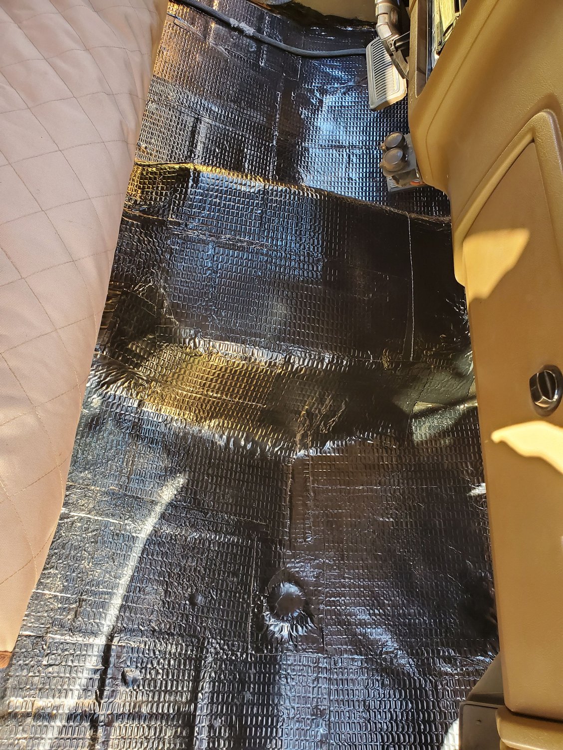

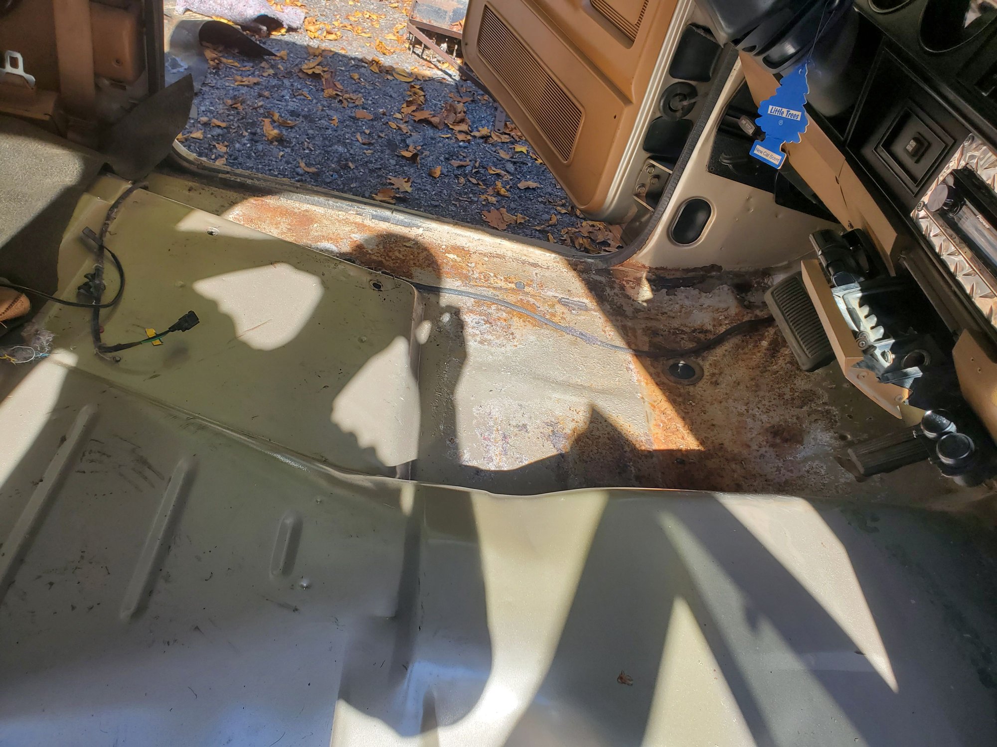

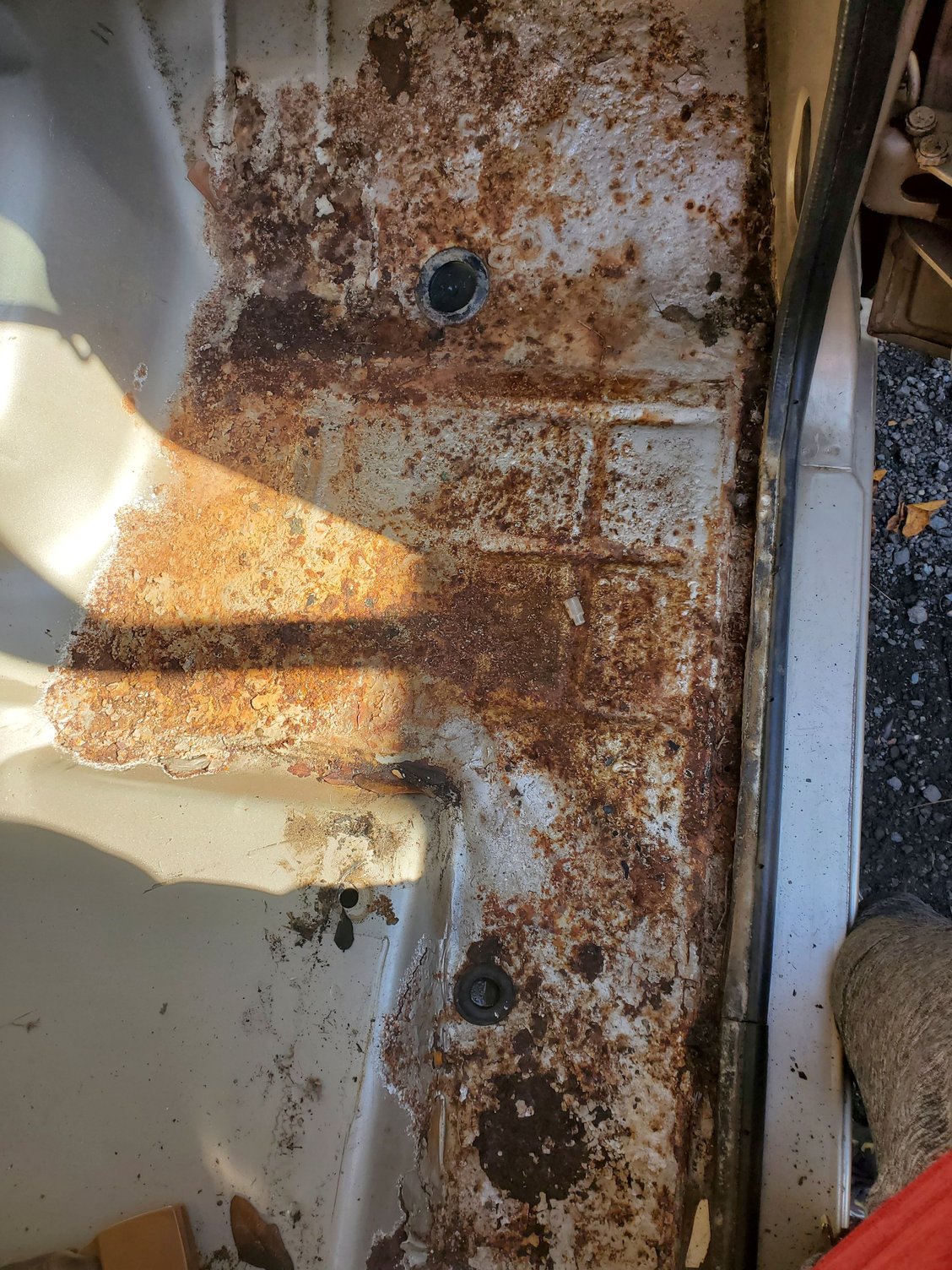

Hi everybody so usually I'm posting in the 2nd gen forums, but about 2 months ago I picked up a 92 D250 extended(club) cab Cummins and im loving it. So far I've ripped up the floor and sanded and wire wheeled the floor pans and I got lucky they only have surface rust once I got them down to bare metal I put down a thick rustoleum(weatherproof/rust preventive) paint with a paint brush then sound deadner all throughout the floor. I've put 2500 miles on it already when I got it it only had 113,000 miles. Was in Florida for 26 years so this thing is as clean as they come. I had to go to Ohio about 400 miles away to pick it up it was garage kept in ohio for 2 years. The only thing that has been bothering me lately is the wind whistle, it really drives me nuts. I tried tightening up the latches for the vent windows took both latches apart and tightened up the screws, I took off the original rain deflectors and put new avs deflectors on that go all the way down the vent windows and up over the windows. It won't go away though has just been the passenger side that is whistling, but I can't figure out where from. Anybody have a solid solution? I packed in change too between the latches and the surface that connect too and still no luck. Might just buy the vent window seals, but I've kinda ruled them out at this point because even if I crack them open the whistle still doesn't go away. I've tried like every different window open combination lol.

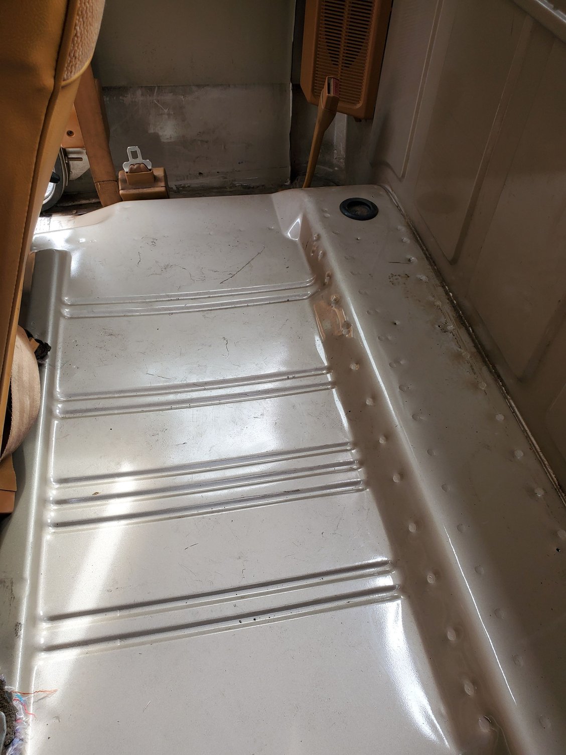

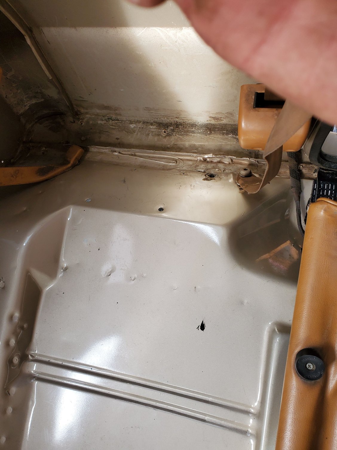

Took me 20 hours to do front floor and 5 hours to do the rear. I only did sound deadner in the rear because its so clean. Had to order more though, 52 square feet wasn't enough for the front, under the bench seat, and the rear floor.
To be honest the hardest part of doing all this was getting the bench seat out by myself lol.
