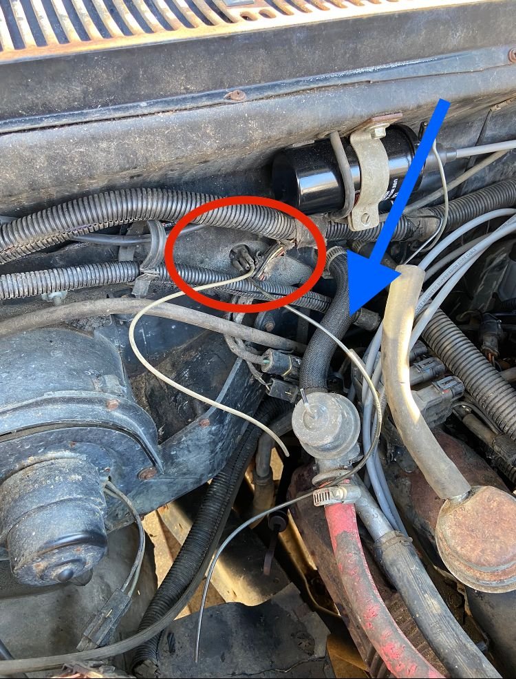

Look under hood on firewall. Should see 2 small hard vacuum lines. One goes to heater control actuator and the other goes to a vacuum junction point if you will, normally behind throttle body on intake manifold.

find this black hose under your hood. Trust me, I just fixed this problem on my 89. If it doesn’t have a good vacuum, you’ll never get the blend door to move between zones.

Thanks Langston! So I have found these two small vacuum lines, neither seems to be broken or have damage, what is my next step?
