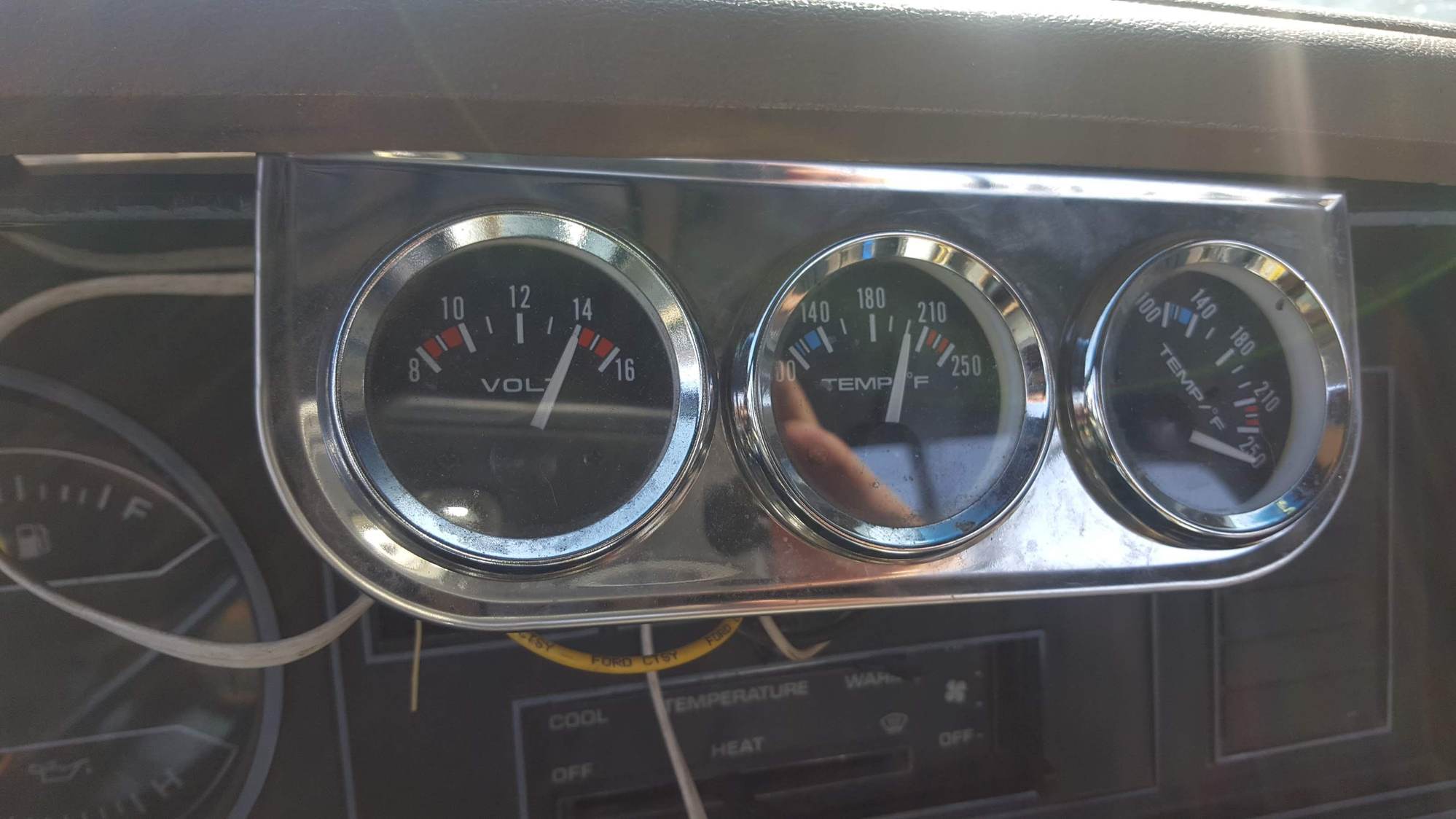

@"HeyYou":
It is a single wire connector with a rubber elbow connector onto the switch/sender.
if you want to know the engine temp best to install a aftermarket gauge. stock temp gauge is not remotely reliable along with the amp gauge barely ever moving.
Spoiler
Spoiler
Where did you wire in the temp gauge sensor? I know there are two sensors in the coolant block in the top of the motor. One with that single wire boot connector and one with the two wire pigtail connector. I am leaning towards installing aftermarket gauges.
