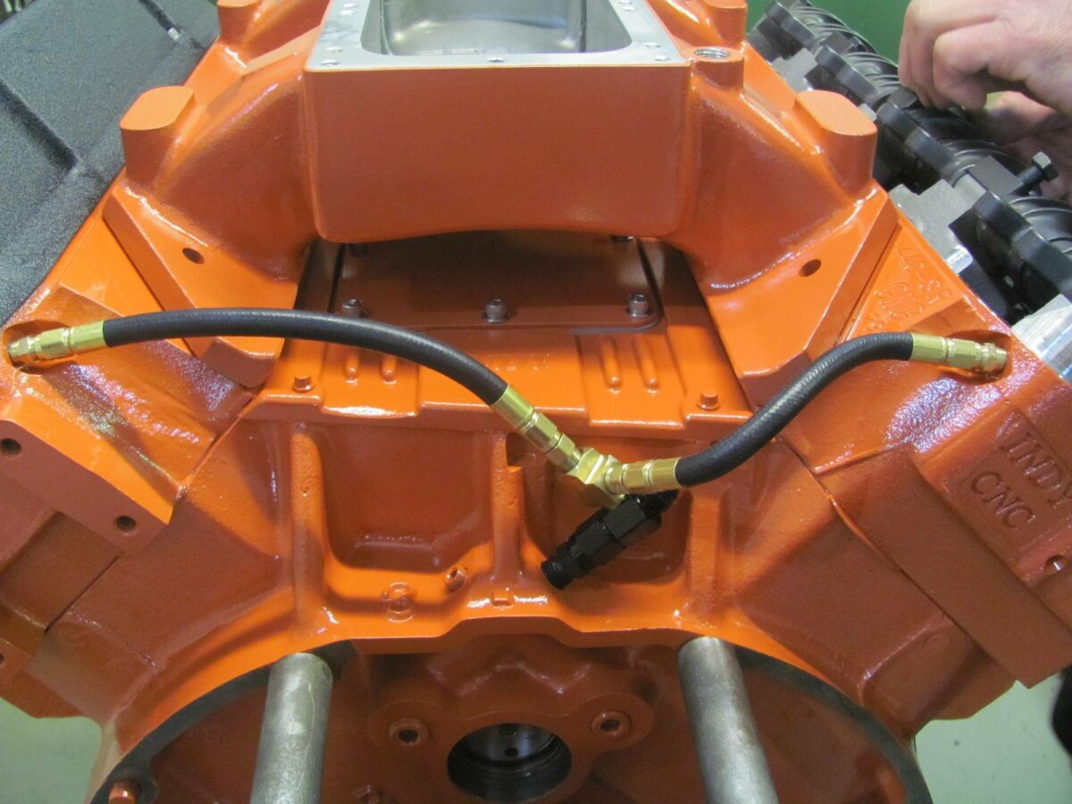

You can get stroker kit's that will bring up the displacement to 500+ ci for big blocks. Now that would be a fun motor! The only thing i don't like about the big blocks is the oiling system. The cams have two holes drilled into them and when it turns it will feed oil to one head at a time not constant. That's why you see people run external oil lines from the oil pressure port in the back of the motor. These are indy heads but you get the idea.
