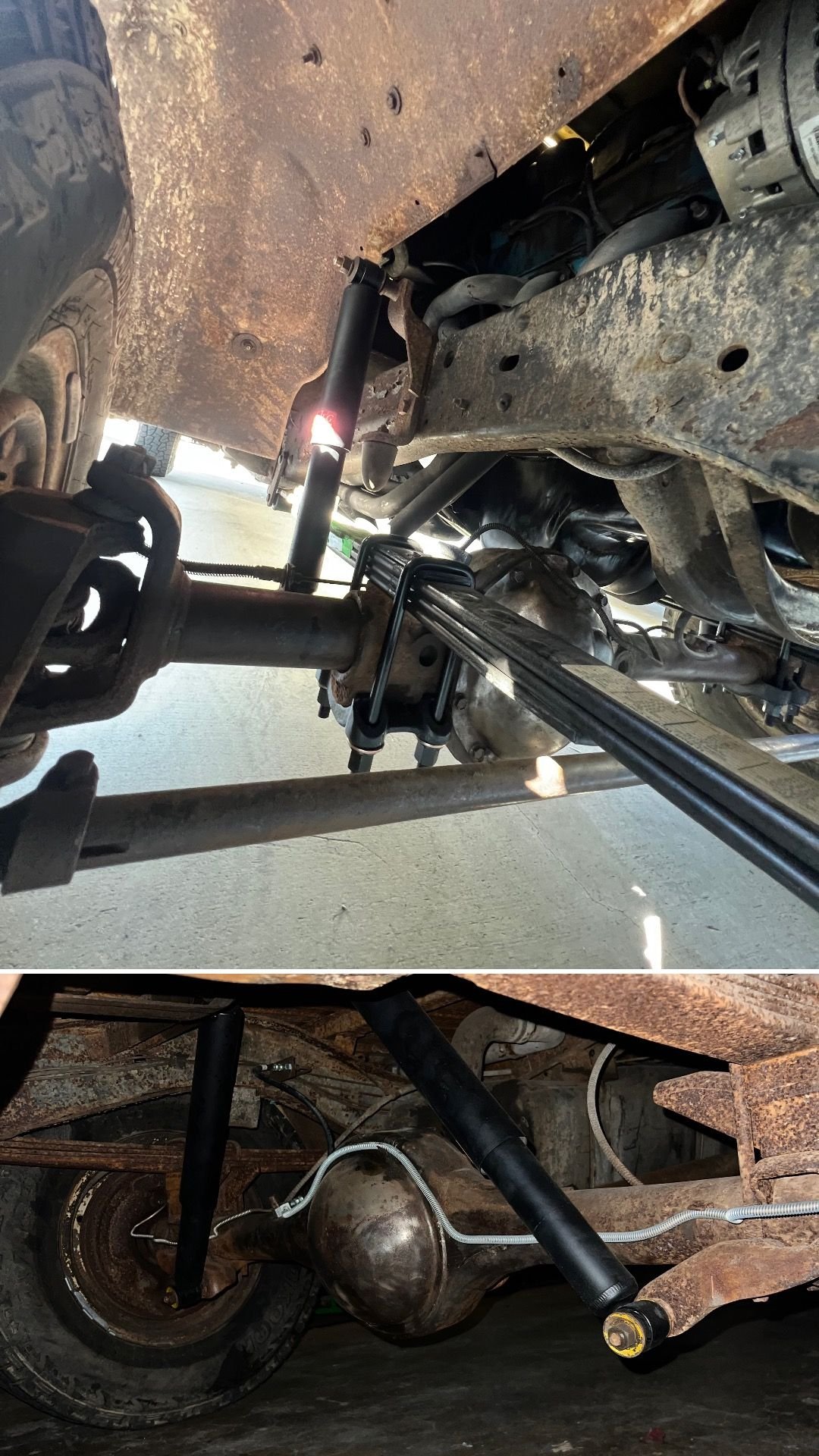

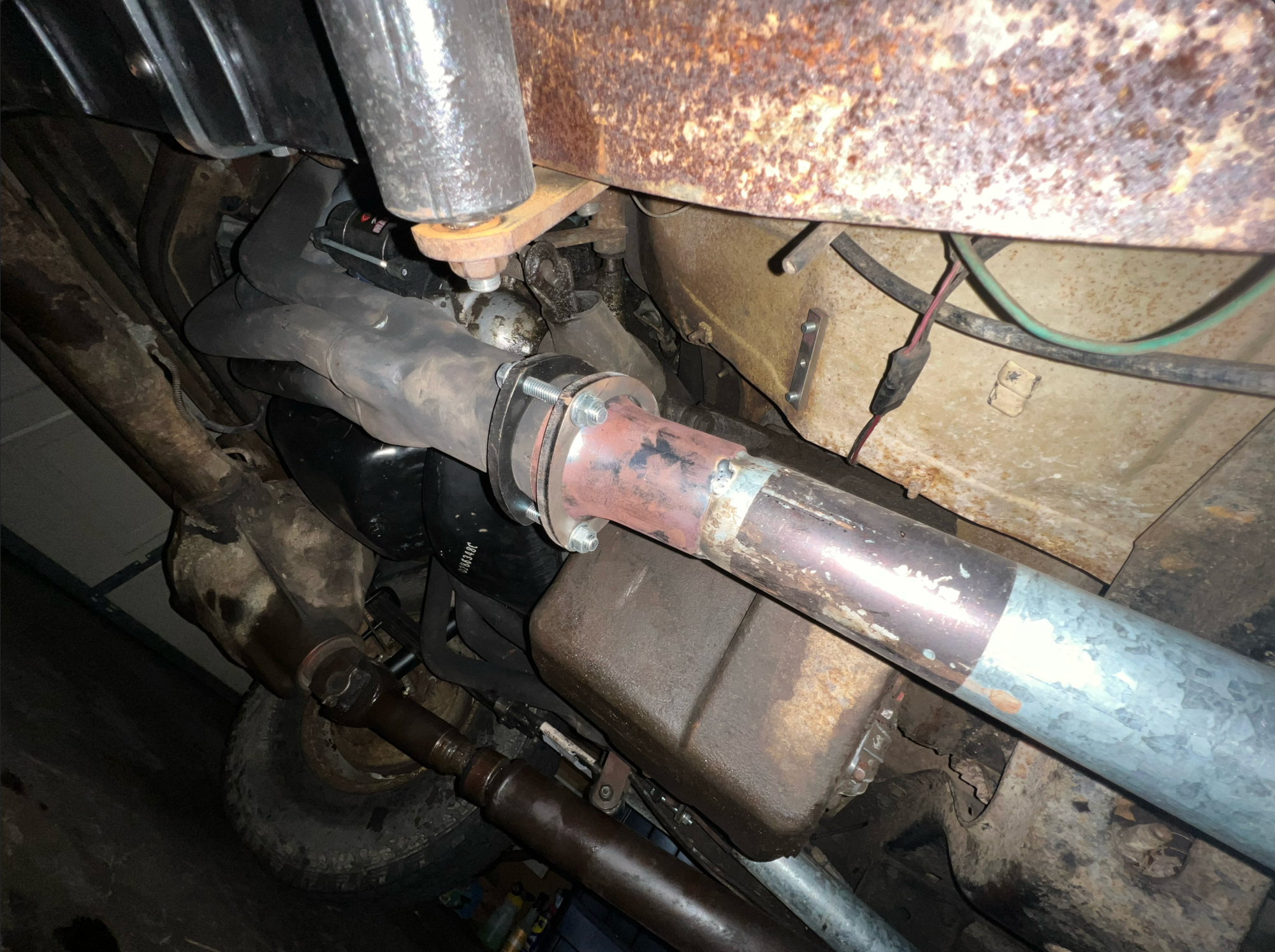

Happy Thanksgiving Everyone! Taking the downtime to drop an update on the truck. Did a lot of work over the last few weeks including:
  • Replaced leaf springs with new U-bolts.
  • Replaced steering wheel with aftermarket steering wheel and adapter
  • Replaced oil pan gasket and re-painted pan.
  • Installed new headers, had to remove starter and oil filter to install.
  • Replaced starter with new high torque, smaller version to clear headers.
  • Replaced all four shocks and fabricated new mounts in the front due to the
    old ones rusted out.
  • Troubleshoot and rewire fuel gauge to work properly.
  • Relocate and mount fuel pump away from headers.
  • Replaced rear brake lines and new flex line.
  • Bleed brakes.
  • Fabricated extended pipes from headers to prevent burning valves.
  • Inspected steering column and determined needs new steering box.
New Starter
top: suspension leafs, new ubolts, new shocks bottom: New brake lines and rear shocks
Next its time for body and paint! After that, the interior and full rewire.

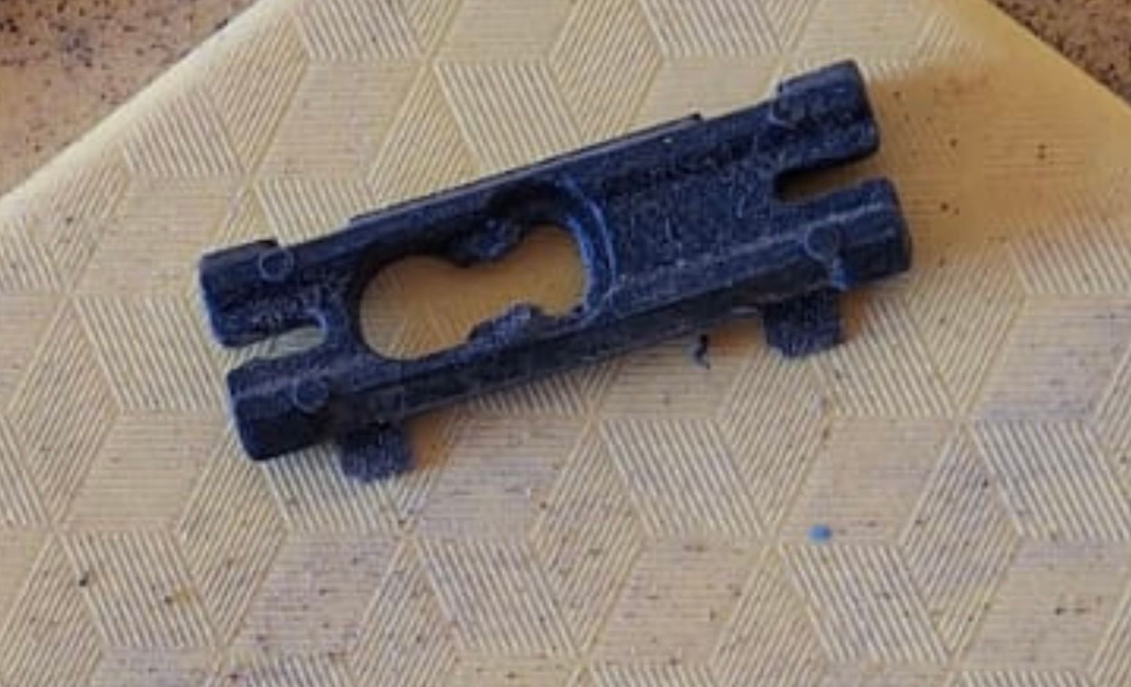

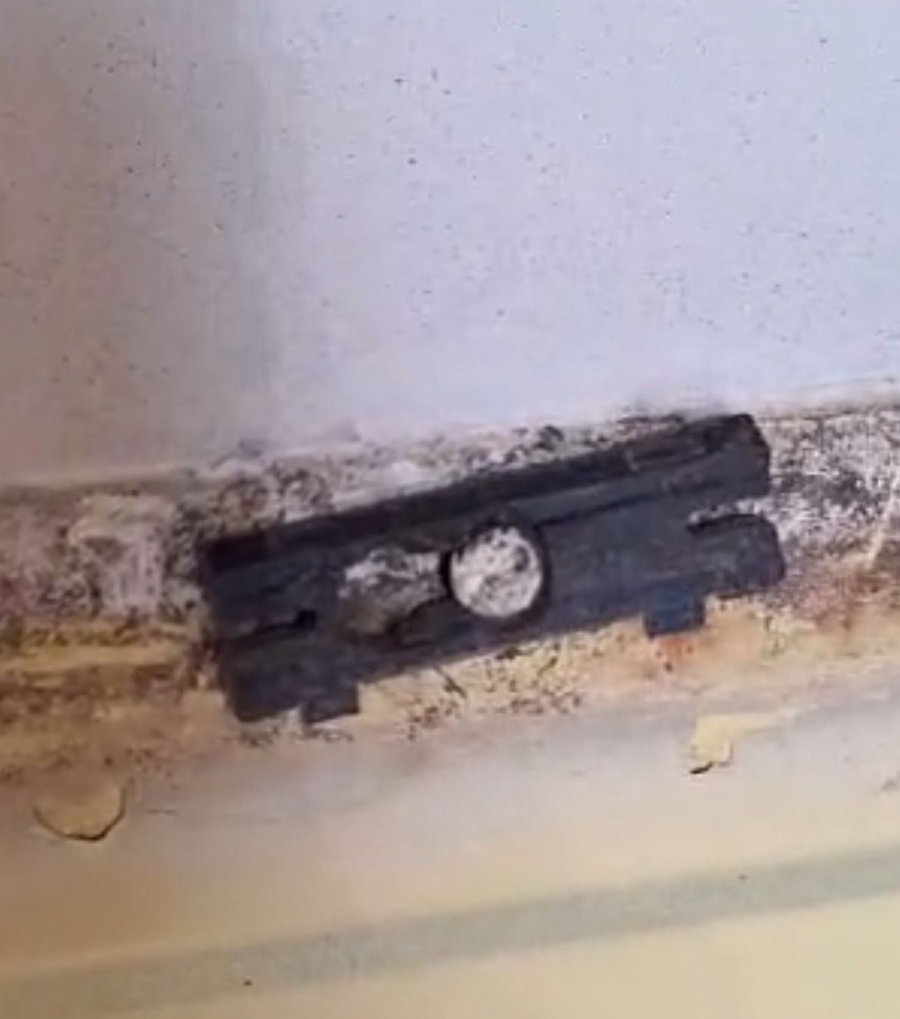

I’ve found all the clips I need except for these ones. I can’t find them on any of the typical aftermarket sites
Old Apr 15, 2024 | 12:01 AM
  #40
ol' grouch's Avatar
ol' grouch
Joined: May 2019
Posts: 5,158
Likes: 724
From: S.W. Indiana
I haven't restored cars with those clips for years. There are all sorts of clips on those puppies. These are close;
https://www.ebay.com/itm/23477052658...PJYFRZ0Z282F3F
These aren't exactly what you have, but they're close and you can probably poke around and find what you need.
