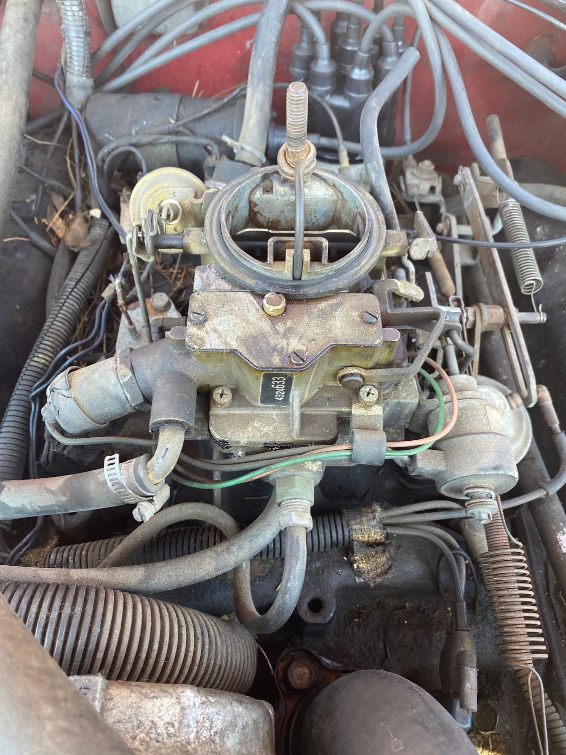

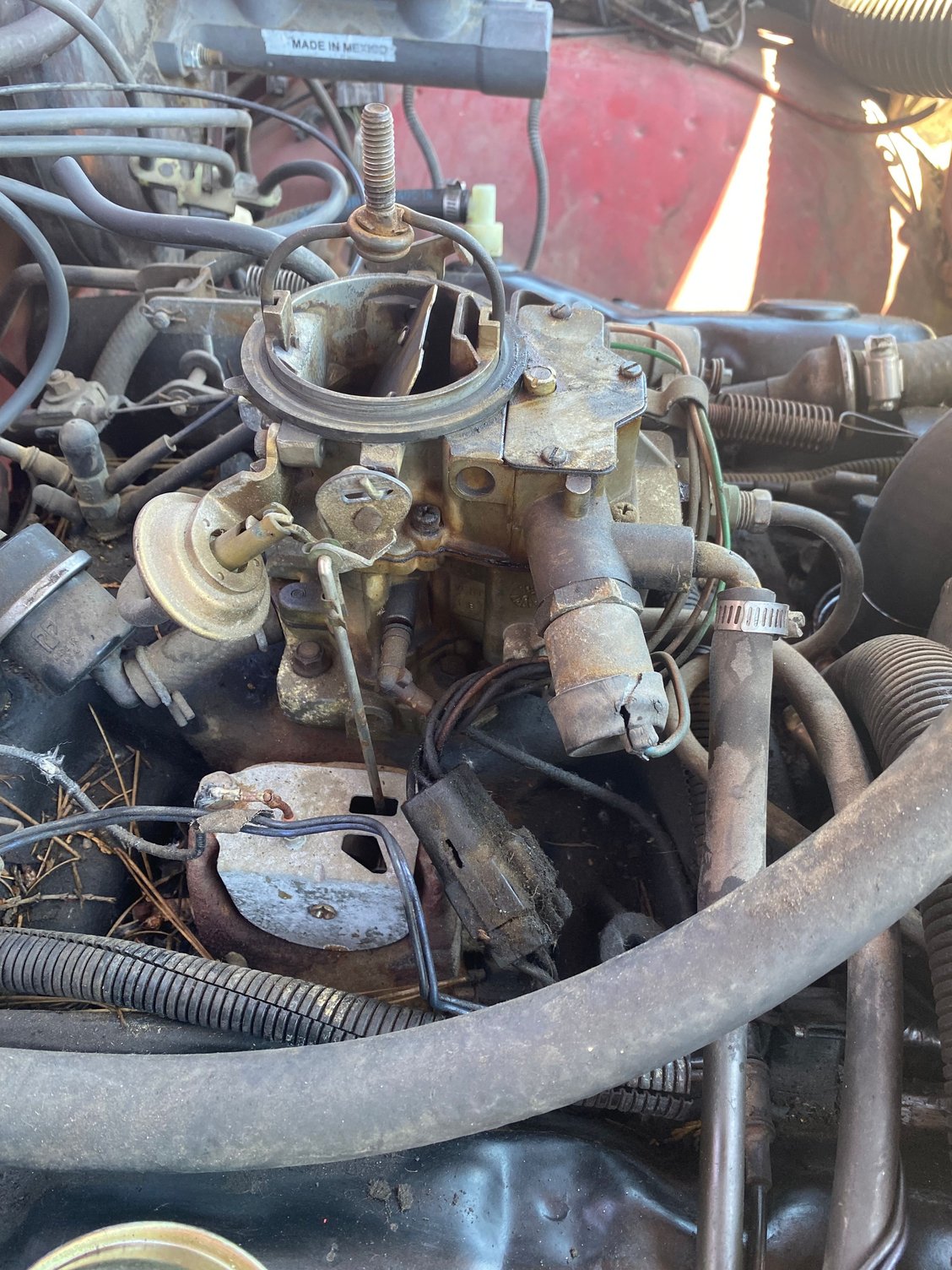

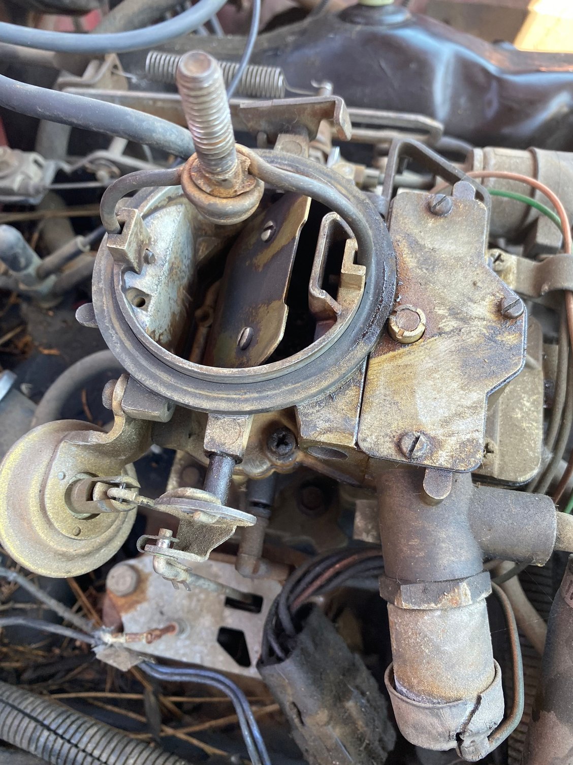

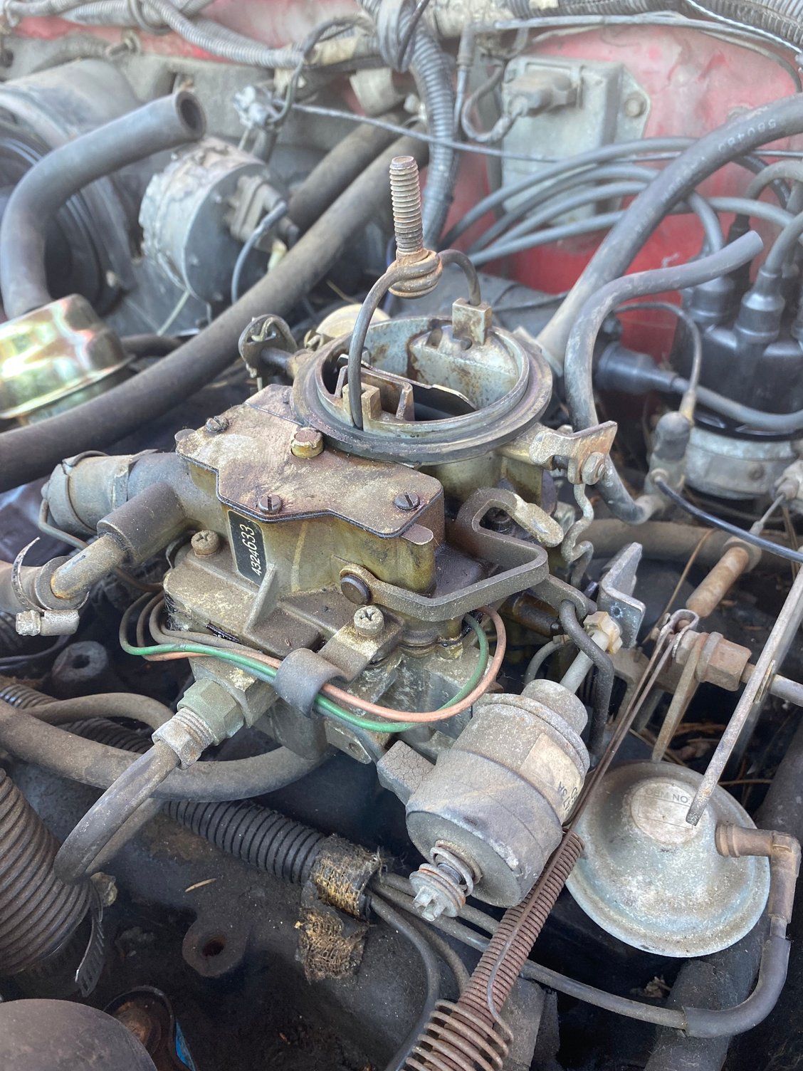

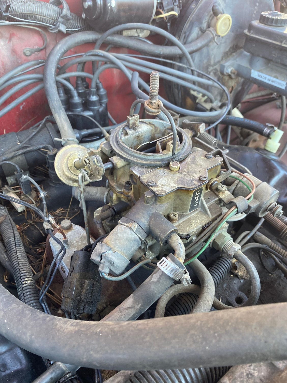

Fairly certain it’s a Holley 6280. It’s marked R40222 in a ‘87 D150 318.
I jiggled the choke plate a bit and got it to close as far as seen in the photo.

don't try to force the choke closed. you usually need to open the throttle to close the choke. as far as carbs go you have the lean burn system so i really don't have a ton of knowledge on them. i do see the throttle is not touching the sensor so i would assume that it may be part of the issue unless the choke is causing this. may have to hold the choke open while opening the throttle to see if you can get it to return the the sensor. if that doesn't work i would keep turning the throttle stop screw out till they touch.

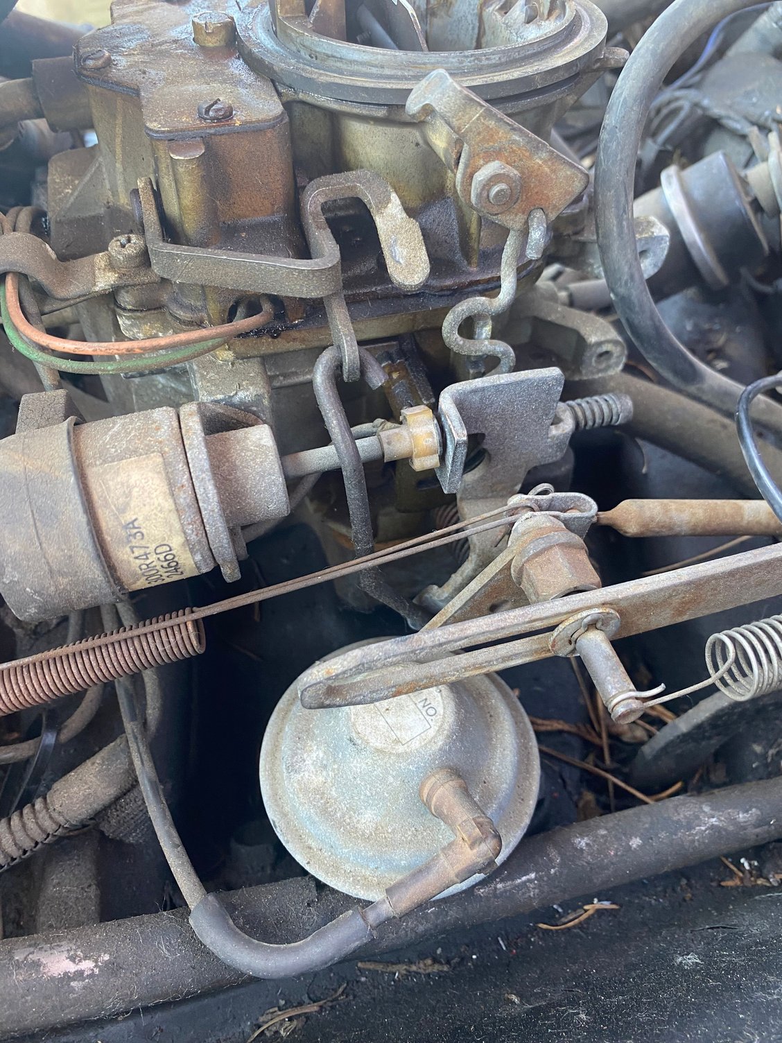

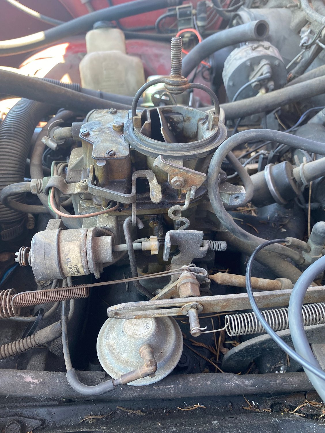

I’m assuming you’re referring to what’s in this photo. I was operating the throttle by hand with the truck off. I let go of the throttle and it released, “slammed” forward, and the throttle is now touching that plunger looking device on the solenoid (name?).

ok as long as the throttle is returning to it. i believe it is a sensor so the computer knows when the throttle is closed but like i said i am not super familiar with this system. most people toss the system in the garbage unless they live in California.
This is a California truck I picked up before I moved to Washington. It idles amazing now. I wonder if something was just gummed up and stuck.
