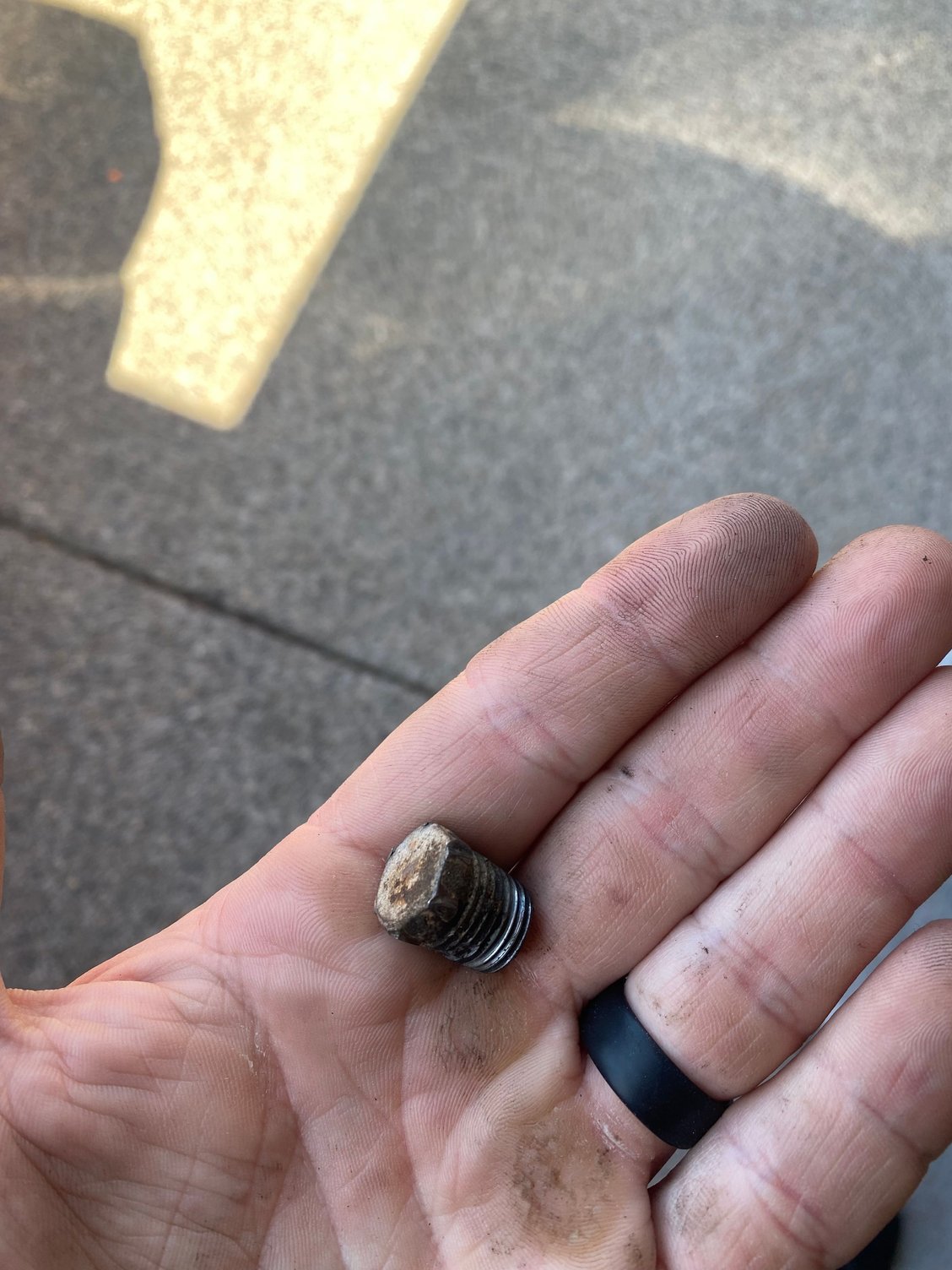

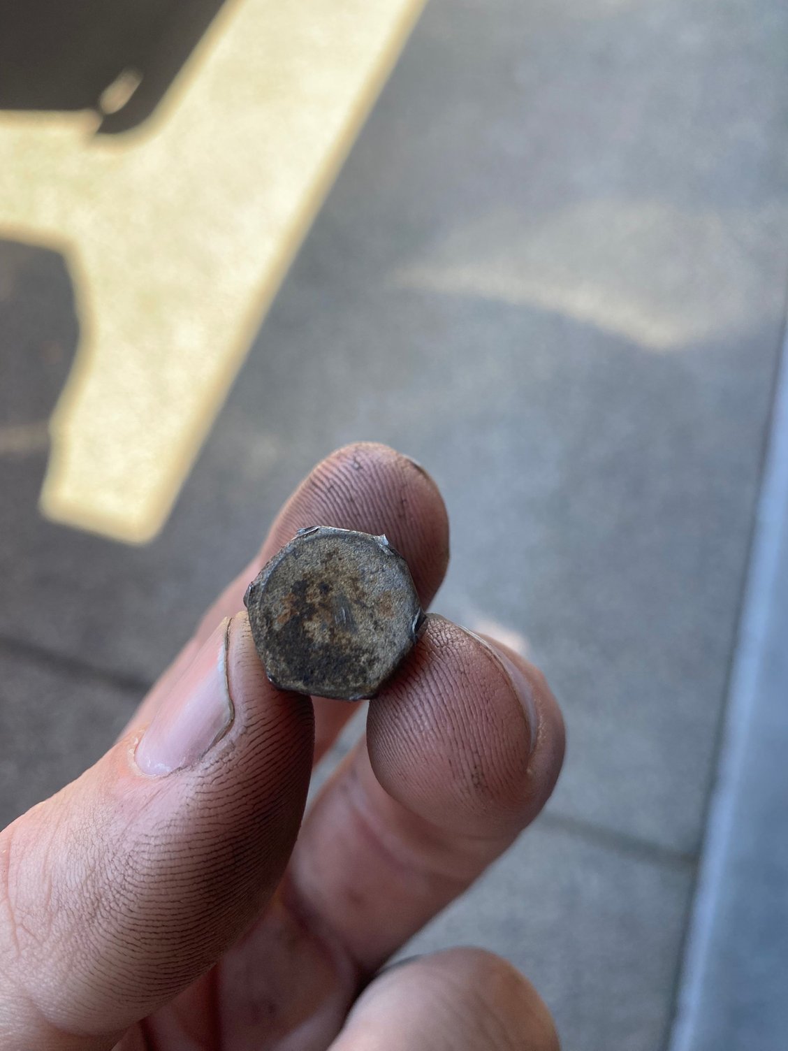

I recently did a coolant flush on my 1987 D150 318. I noticed the engine block coolant drain plugs are starting to round and the threads are damaged. I’ve looked everywhere I can think, does anyone know where I can order new ones?

Damaged threads
Rounding off

should be able to find something at any decent hardware store. i am guessing it is likely just a 1/4" fitting. make sure to check the area where you would find air lines/fitting or plumbing section at the hardware store. i personally wouldn't worry about them damaged threads. it would likely still seal with enough teflon tap but the rounded off bolt head would be main reason i would replace it.

Thanks! They look like a 1/2” fitting. I didn’t know if I needed a certain grade of metal fitting to withstand the temperatures. Should I use Teflon tape or could I use anti-seize lubricant? Those things were so tight I was worried I would shear the head off.

Its an NPT pipe plug. So, 1/4 or 3/8ths.... any hardware store should have 'em on the shelf. Take your old one in with you, get some to match. Doesn't matter about grade, they are metal, don't deal with high pressures, or temps... (so far as steel is concerned....) Some thread sealer, and yer good to go.

So the metric didn’t work. I bought multiple sizes of plugs, a 1/2 drain plug, a 1/4” pipe fitting, etc. I am 99.9% certain is the right size. I can’t thread anything into the holes, not even the original plugs. I think I’ve just encountered a big problem.
The pipe fitting will go about half way in before I would really have to force it, and I really don’t want to do that. The original plugs were a nightmare to remove. I didn’t think it would be more of a nightmare to reinstall them!

Get a pipe tap, and clean up the threads.
