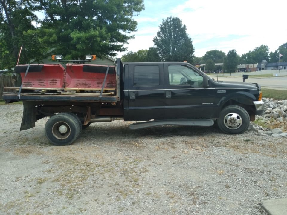

Snow plows are heavier than you might think. I recently bought an F-350 Superduty with the 7.3 Powerstroke and a Boss RT3 Vee blade plow.
The truck is a major hauler but it knows something is back there. The blade long with the hydraulics are about 1700 pounds. I think the braces still on the truck are around 200-300 pounds. So that's close to a ton in front.
Old Sep 14, 2024 | 08:33 PM
ol' grouch's Avatar

By the way, anybody that needs a snow plow, it's for sale. I don't like shoveling my own sidewalk. I'm not about to plow parking lots.
I just have to ask, was that plow really on that truck?
I once had a E250 3/4 ton van that had factory 1 ton suspension on it .... Father in law has a chevy 3/4 ton with 1 ton suspension ..... it is a common thing for the dealers to do.
Father pulls a 5th wheel trailer with 1 ton suspension and pays taxes on a 3/4 ton truck. .... It is a option customers like.
So your truck is a heavy duty 1 ton .... is that 1.5 ton suspension or a 2 ton?
That plow looks like it should be on a semi truck platform like the big dump trucks the cities use. ..... That plow is huge!
