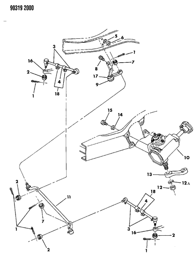

I would check the steering gear for center. Where is the pitman arm at? Not sure if they have the notch in them for "center". If it was put on wrong it has to be removed and "centered" before any other components can be adjusted.

Already centered the steering gear, the pitman arm does have an alignment notch so there is one obvious way it can go, the other I'm guessing is for 4x4 and it's so far off you can't even connect a 2wd.

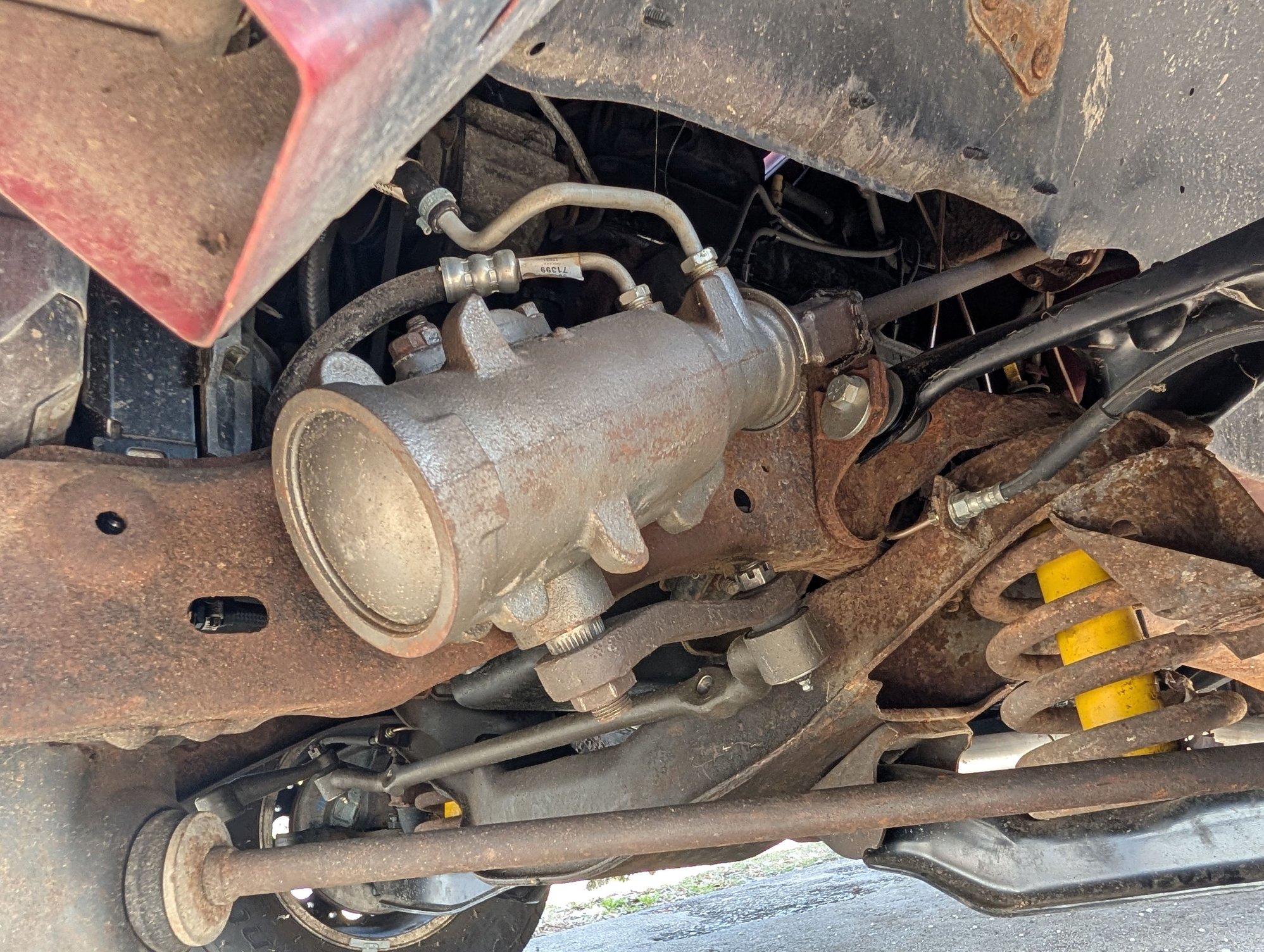

Here's what the front end looks like without the tie rods
