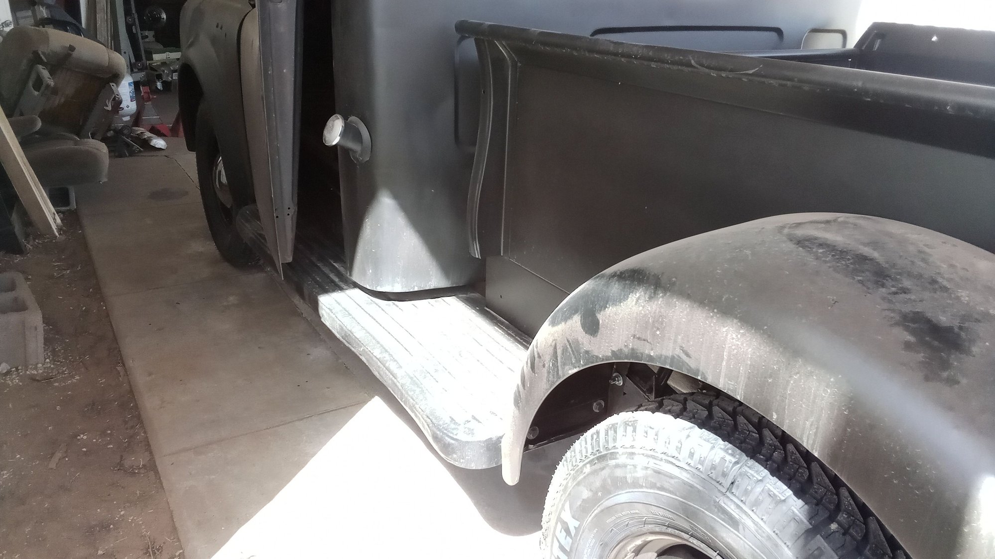

Here is a difficult dent, it has been hit hard.
You can work them so far and get it close
And because the metal was so stretched, this is as close as I could get it. I would like to take my time and hammer/dolly it smooth.... when I touch it, it just gets worse.
The only thing left to do is cut out the metal and weld in a new piece, or putty it up and drive it the way it is. .... I'm fine to use it as is.
In the end it will be fine. ... just take it one dent at a time ... in this photo I can point out 3 dings that I left, just fixed the big ugly ones ... it is a truck and should have dings.
