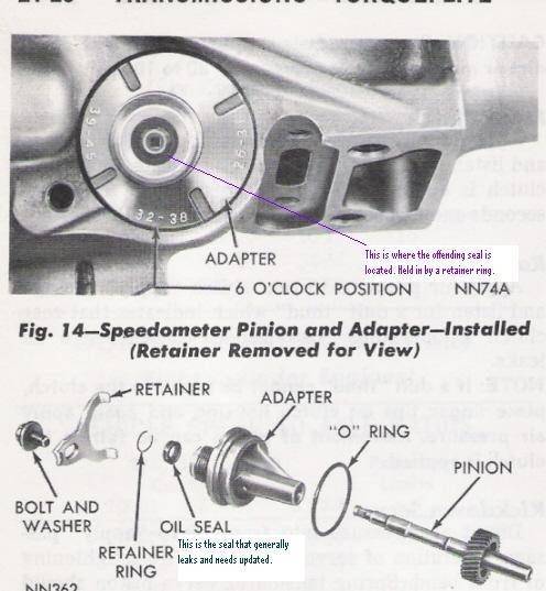

If you drive on the freeway with 3.55 gears you will be doing 3K rpms just to keep up. Clip on cable driven? I would have to agree with HayYou, Compare the two.
This is the old cable style.
If you look at the early 91-92 design it's the same as the cable driven.
