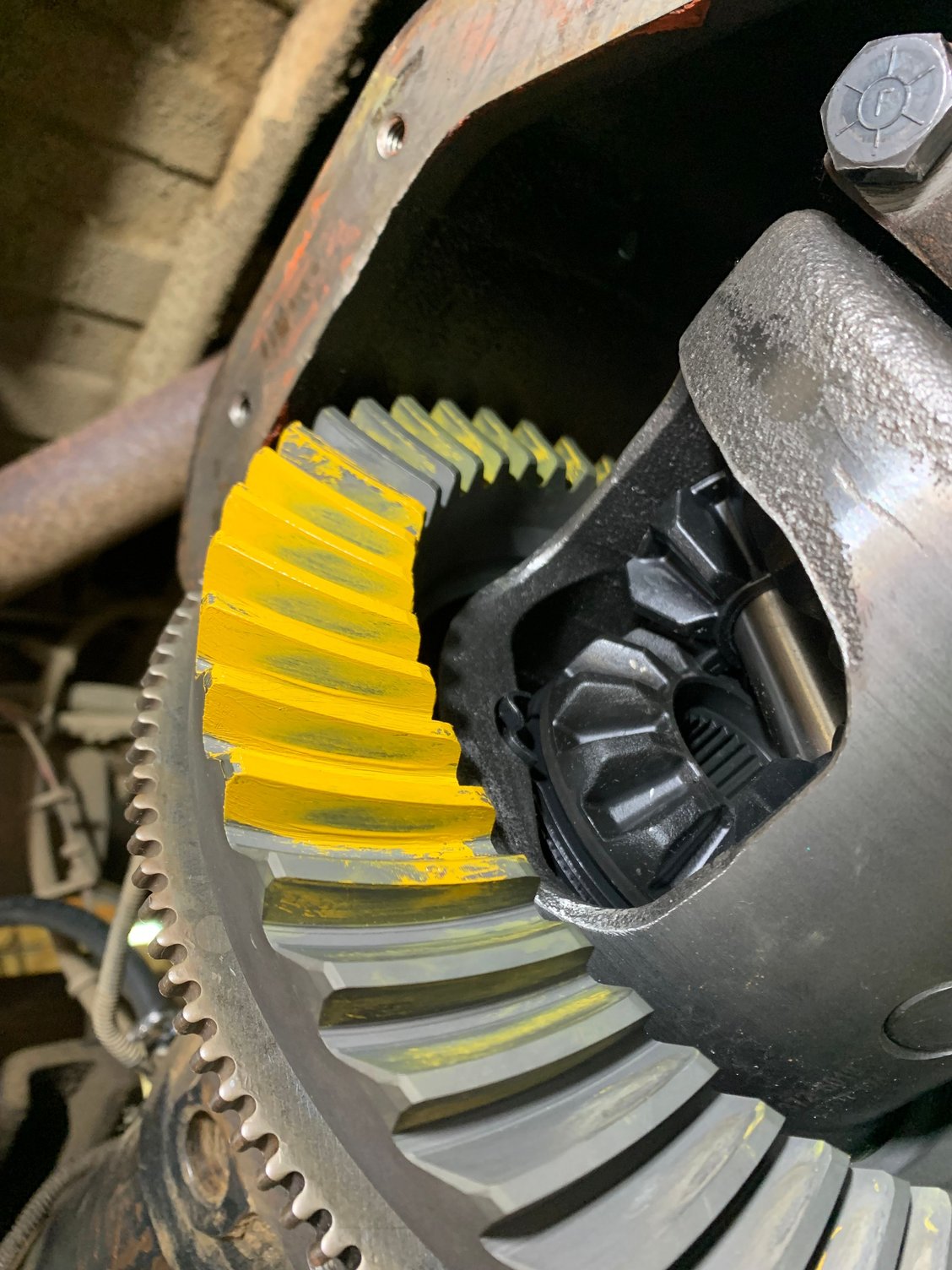

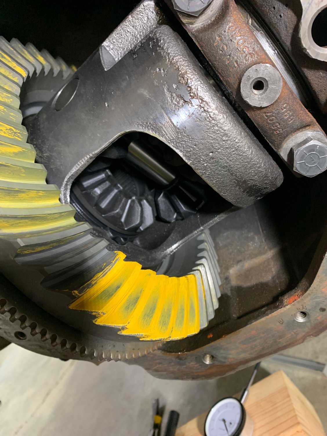

Hello. Can someone tell me whether or not this is a good gear contact pattern? Thank you!
This is the coast side
This is the drive side

That actually looks pretty good to me......

Aim to get the drive side in the center of the gear, Yours looks a bit to the toe side.
https://www.crawlpedia.com/gear_tooth_pattern.htm
So do you think I should remove some shims on the pinion, and if so how much? Maybe 0.003?
