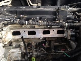

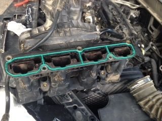

rmesax's Avatar
rmesax
Joined: Jul 2014
Posts: 4
I had the same issue and after spending money on a new throttle-body, the problem ended up being a leaking intake manifold gasket which i found out after getting the 2173 code. I did this repair myself paying $7.00 for the gasket. The dealer wanted to replace the intake manifold and gasket for around $900.00. I tested by spraying carb cleaner near the area where the intake meets the engine and the car stumbled at idle.
Update! I have put over 30,000 miles on car since the repair and the problem never returned. The car now has over 160,000 miles on it and running fine. I attached before and after pics. I hope they are viewable.
