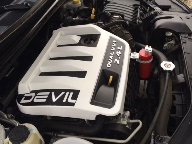

this is where one guy mounted his
This is where I mounted mine
Its pretty easy to do and it doesn't really matter which one you get (as long as they are made right), the function is the same.
The one I have has two top openings instead of one top and one side and a level indicator to let me know when it need to empty it... but the function is the same...
Some where on the head you should have a hose that comes off and goes into your intake. Some where in the middle of that hose is where you want to install your catch can. I mounted mine on the firewall and used longer hoses to connect to the catch can and the intake.
