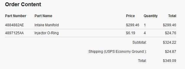

Yesterday afternoon I ordered the Intake Manifold and new O-Rings for the Fuel Injectors as I don't want to have any Fire episode!
Grand Total: $349.09
