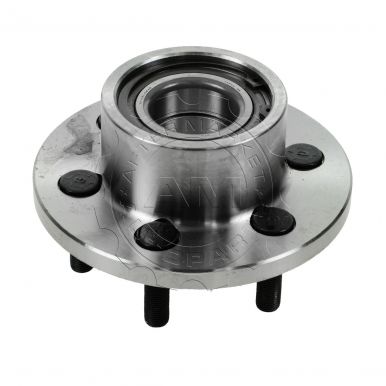

They have a hub assembly which looks like it goes onto a spindle, with a bolt holding it in. A unit bearing assembly has three or four bolts holding the entire assembly to the steering knuckle. I was thinking that it had an old style assembly requiring bearing packing, where it looks like it's like a hybrid - no need to pack bearings, still using a spindle. My whole reason for starting this thread was I don't like to pack bearings and making sure everything is just so, and I don't see that getting any better the older I get. I love unit bearings because they're just bolt and go, but I'm fine with a hub assembly that bolts to a spindle as it's also bolt and go, and with only one bolt to boot. Win win.
Spindle style hub, with tone ring
Unit bearing hub
So anyway, I'd like to know if that tone ring is going to cause an issue for a truck that has 2 wheel ABS, and no tone ring up front. That tone ring is fairly large in a tightish area, so I just want to make sure one isn't a problem if the truck doesn't actually need it on there.
No tone ring
I suppose the tone ring could be removed, would need to see one in person unless someone knows...
