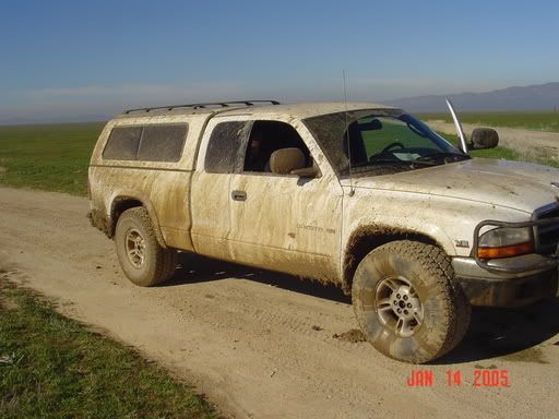

STOCK 4x4 with 33s. its mine so i KNOW they fit. very very slight triming of the plastic otherwise no rubbing. this tire will only work with the stock rim or a aftermarket rim with stock offset and backspacing. a 2wd can run 31s with no problems ( depending on how saggy the suspension is) my buddys 2wd durango has 31s

can you turn lock to lock, that reminds me of the tractortubes we go down the river on lol
