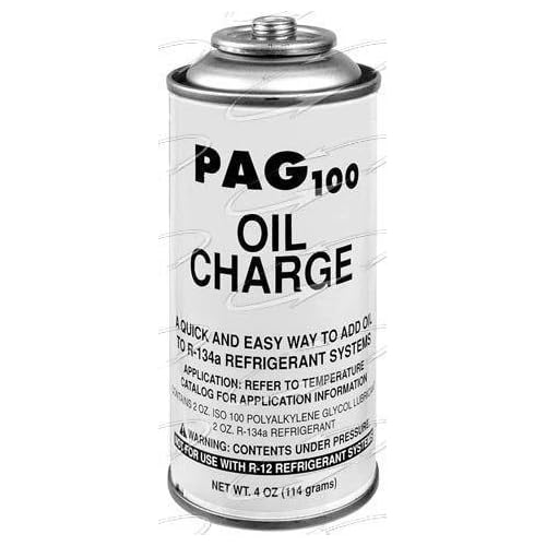

To start you should of measured it and pored it directly into the compressor then you inject the remaining needed oil with an oil charge.
I found this in my manual a table of needed oil for the A/C system
When I redid my compleat system I filled the compressor with the needed oil and then injected one 4 oz. oil charge and have never had any problems.

I don’t know what brand of compressor he purchased they may all have different oil needs.
This is my understanding find out what the compressor lists as needed oil then add what’s on the chart the rest of the oil needed for the total oil needed. I think you can be off an ounce or two with no problems. When I redid my system that’s how I did it oil needed for the compressor and oil for the system all I did was inject 4 oz. You will be better off being a bit low because the Freon will work better not being so saturated with oil.
When I say oil for the system all that means is this the oil will get distributed throughout the whole system so you need extra or you will not have the needed oil to keep the compressor running its just extra oil or think of the rest of the system as an oil reserve/tank.
The exact oil needed does not need to be perfect just within range is fine.
Better to be a little low than too much oil and kill the cooling performance of the Freon. Same with using any leak dye dont use any it kills the cooling performance of the Freon by 10%.
My understanding is the dye is old school the best is leak detection sniffers way better the dye will degrade the performance of the Freon but all shops will say it will not.
Remember the oil needed is what the compressor lists the oil is for the compressor that is only part that needs lubrication.
