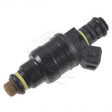

I needed to replace an injector on my 97 5.2 and the new injector at 3 different patrs stores seem to be different than what I pulled out of my intake. The O-Ring on the bottom of the injector is smaller and it fits pretty loose in the intake compared to the original. THIS is the new:
It has the yellow plastic band above the O-Ring where as the one I pulled out does not:
What is the difference? AND can I use the newer one without it leaking?
I ended up just cleaning all of mine and replacing the O-Rings and that seems to solve my misfire problem for now. But I would like to replace them all, as they look like the original injectors from 1997...
Anyone care to enlighten me? I would greatly appreciate it.

Should all be 21# general DCX injectors. As far as fitment I dont know, but User's fire was due to a failed injector O-ring.
