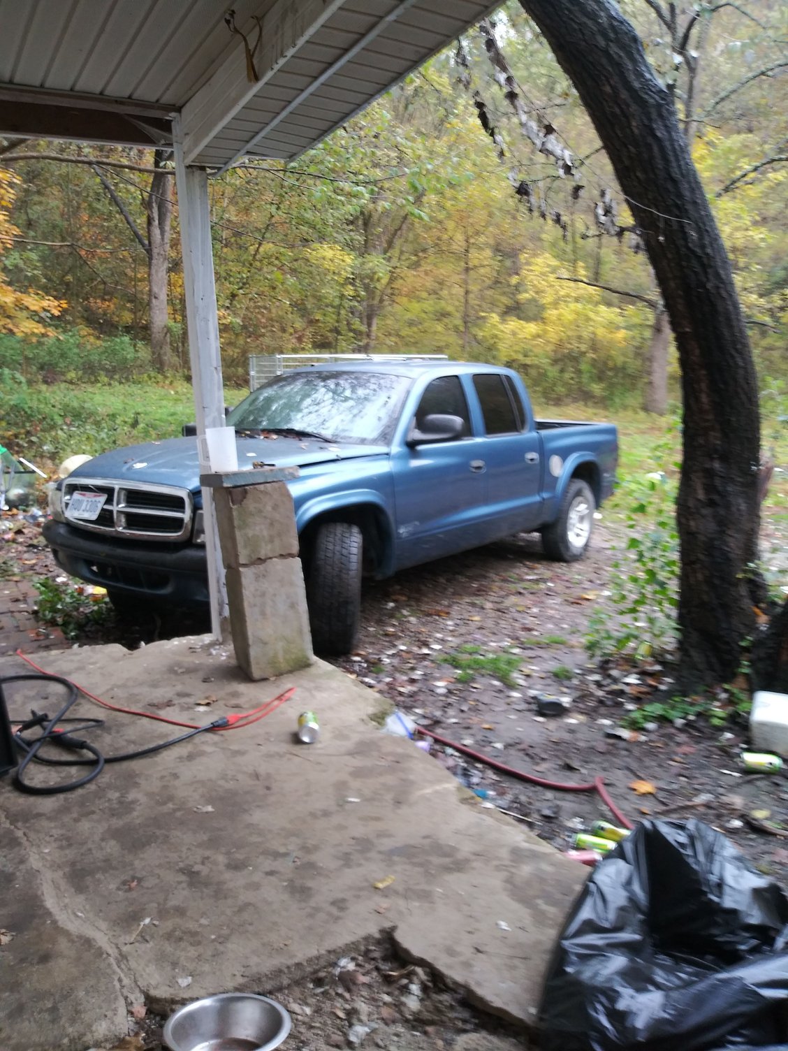

Here is the pic of my truck but i cant find a 2nd gen dakota 3.7l manual 2wd crew cab

The 2nd gens came with a 3.7???
All you really need is a 3.7 with a manual, doesn't matter what cab style it came out of.
