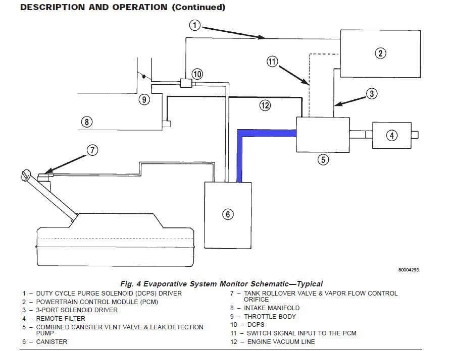

This is number 5 with the S tube coming out of it this should be between the battery and power block I think this is the one you are talking about
I will say if you have the SMOG stuff turned off disconnected I don't think its going to matter it should have nothing to do with how bad your engine is running you may get a dash warning light but that's it.
If anything unplug # 10 and see what happens this should shut down all smog its next to the A/C drier tank in the below Pic just above my blue intake hose.

Another test is either unplug #5 or pull off #12 the vacuum hose from #5 and plug up the vacuum hose see if things get better or worse in regards to how your engine runs.
Do you need SMOG testing in your State?
If not you could unplug all this and see if your 2.5 runs better but you will get a lot of dash warnings.
