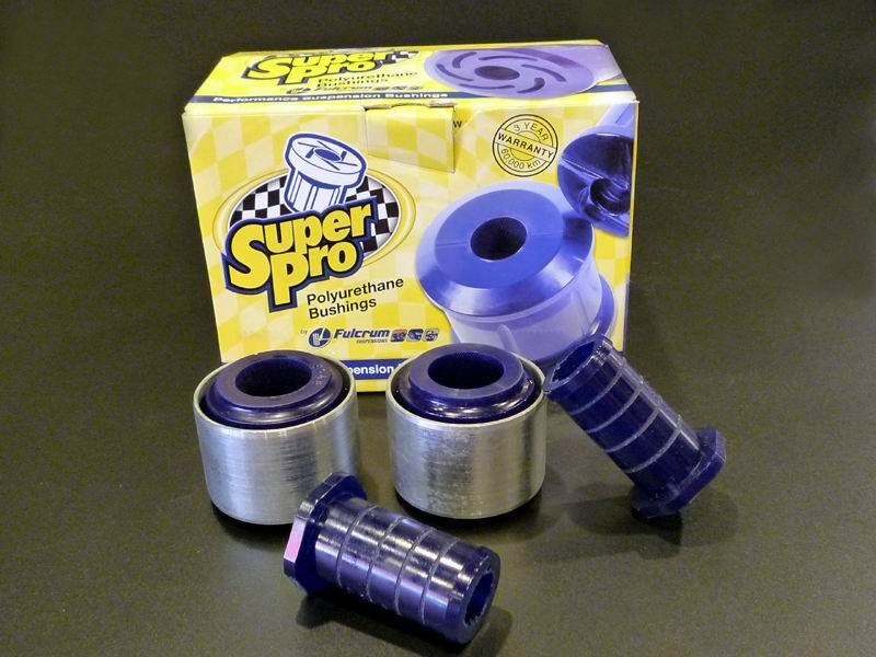

oh, and by the way- it may not be a problem. you could just have poly bushings...which will never wear out, but due to their chemical composition, will squeak your ear off...I'd take that over the other option.

See first Magnethead's comment - I've got poly, and if I don't keep them lubed, they squeak, especially in damp weather.

I would never install poly bushings they float in the bushing shell and turn into squeak monsters. If they were molded into the shell that would be better but I'm not sure that's possible they may snap.
I'll take squeak over changing everything every couple years

It would be nice if we had more options the stock are a bit to soft but quiet.
I have seen molded poly bushings for other cars mainly European cars but not the Dakota.

I have seen slotted poly bushings with oil groves
