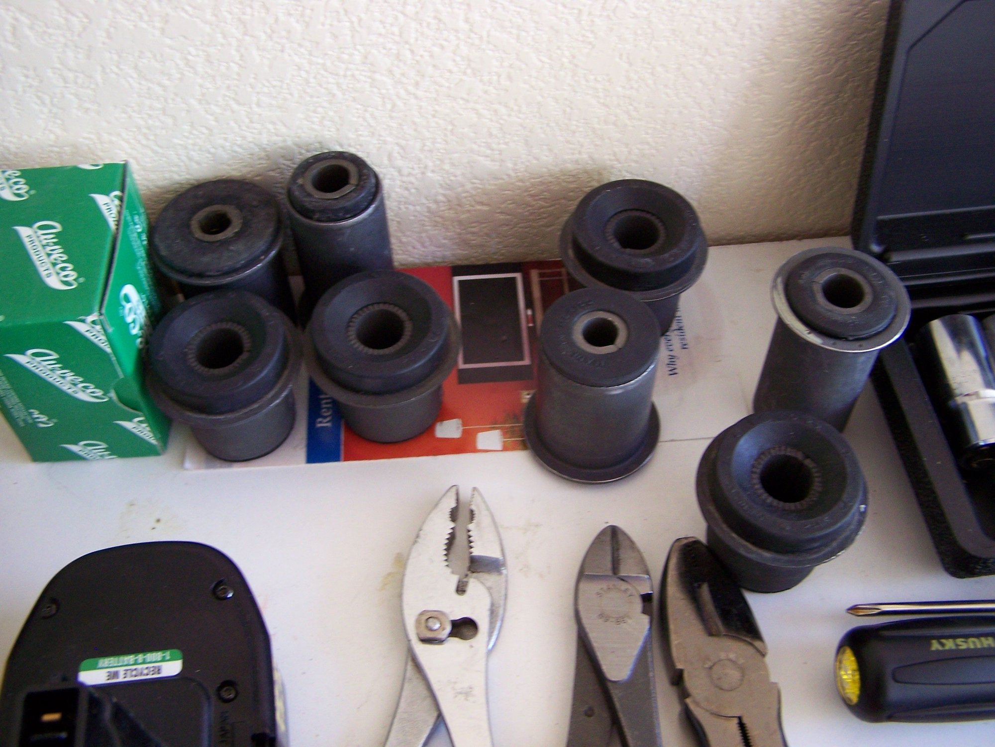

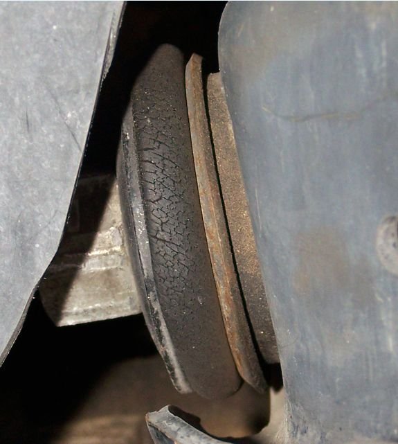

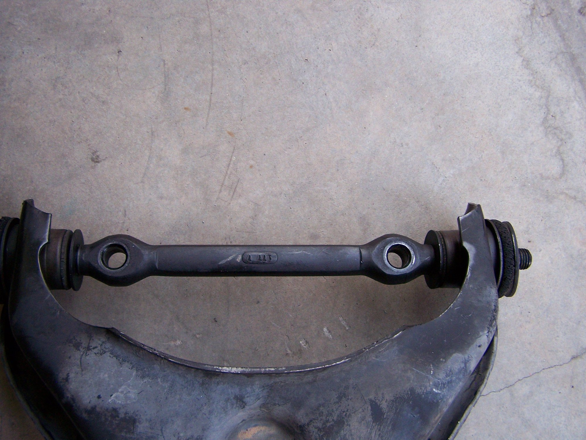

If he was a Dodge tech why did he install the ball joints without checking the bushings and preformed an alignment? If he was any good he would have told you to get new bushings before he started especially an alignment. I will say the bushings always look like they are bulging out of the bushing that's normal.
My bushings looked like this they were a bit mushy but not exactly bad just mushy I replaced them and it did tighten my front end up like it was new. But after 2 years they started cracking and looking almost like the old bushing did.
Old Mar 31, 2015 | 06:02 PM
98DAKAZ's Avatar
98DAKAZ
Joined: Jul 2011
Posts: 4,895
Likes: 35
From: Gilbert, Arizona
This is the new bushing before I had a machine shop press the new bushings on see all the rubber on them.
This is how they all look after two years. The rubber is squished out some during installation that's how its done.
