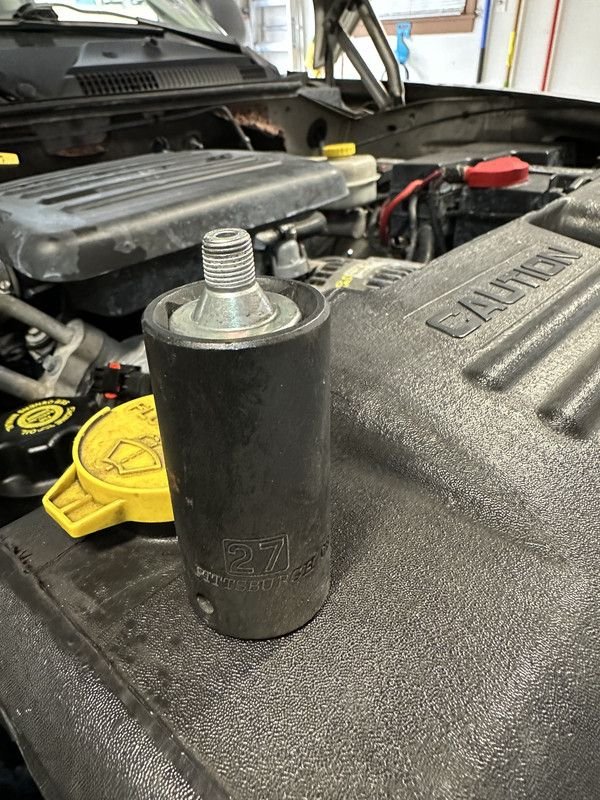

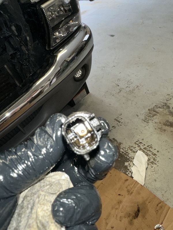

Got the new oil pressure switch installed today. Got it from the Chrysler store on Amazon, so it's OE.
For anyone doing this, I pulled it off using a deep 27mm impact socket with a 1/2" ratchet. You don't need a special slotted socket as the wire is attached to the harness, not the sender. Be very sparing with the torque esp when using a large wrench like I did. It's a lot of leverage on that small threaded tip. I'd be in a world of hurt if that broke off. Very tight area to work, being underneath on a 4.7.

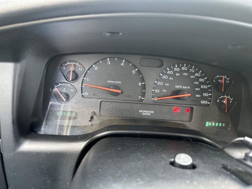

The old switch was leaking inside. They all go bad like this eventually. Gauge is back to half. No more dings!
341K, for my records.

341K and your oil pressure still looks like that? Wow.
