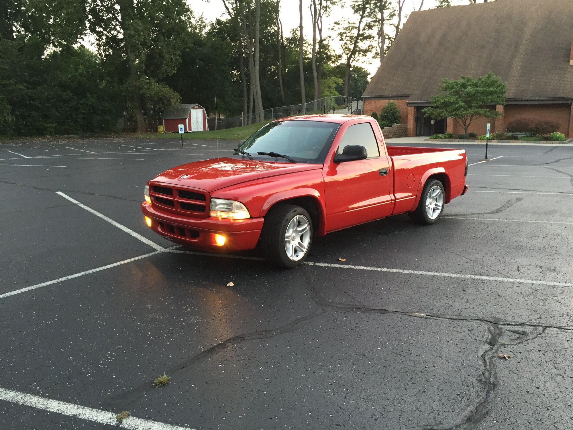

Both my turn signals and now my wipers won't work . Fuses seem to be fine . I have a 2001 dakota R/T RC .

Nice RT looks like you lowered the rear
How much did you lower it and what kit I'm going to lower my rear but was only going with a 1" kit so my Dak looks more like a street truck but yours looks great so did you lower it more than 1"?

I dropped it 3" in the rear and 2 " up front .
