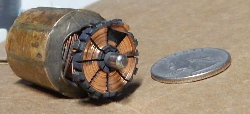

It's hard to tell by mileage, Would be nice if they had hour meters. No telling where most of the driving was done stuck in traffic or highway miles. I tent to get it changed around 160-175k with average everyday driving. My 90 ram almost made it to 200k but quit just before it. I did my 96 at 160K and this is a pic of the motor armature. That is thin copper on the commutator and no telling how much longer it would have lasted.

Thanks for that , seems like it is a no brainer .
any thing special to look out for new install ?
