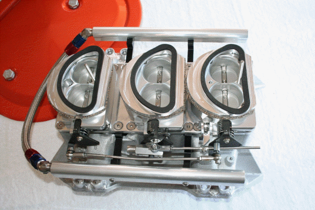

I forget who did the 6-pack EFI shown above. I do recall that it was an absolute pain, and they pretty much just hacked the top off an airgap manifold and CNC'd a new base plate and welded it on.
I'm probably going to end up with the hughes airgap and the FAST/Accufab throttle body. Alot of people liked the Accel throttle body, but it's been discontinued. There's a CCR model on ebay that some people have been flocking to that will accept stock throttle linkage. I'm not running a stock linkage so i'm not eligible.
