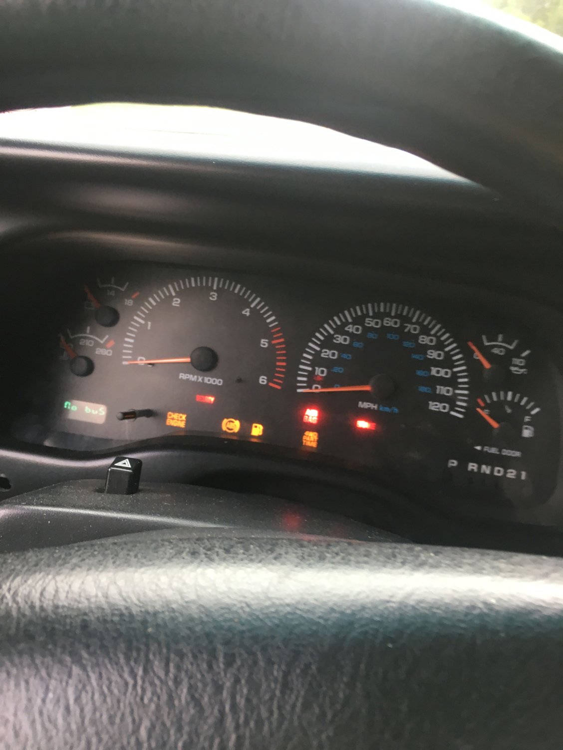

So I have a 97 dak 4x4 auto v8 magnum. I think the 5.2. Anyways, the previous owner really hacked it up.he put in HID lights. He took out the whole AC system I guess for more horsepower. Whatever. Also, the instrument cluster was FUBAR. Lights were missing, couldn't read milage or anything on trip meter. Totally bad.
I had a mechanic do some exhaust work on my truck and he did a good job except when I got truck back, none of gauges on cluster would work. The backlight and turn signals work plus abs light or brake light was on and has always been on. Mechanic said he didn't touch anything electrical and left it at that. I was pretty upset.
So I put in a second hand cluster and all seems well except the no bus comes on as well as check engine and abs and a bunch of lights. No gauges work either. Truck runs fine though. I just want to get the gauges working to make sure I don't overheat or run out of gas or speed and get a ticket....you know, have a normal running truck. I have noticed a drop in power (voltage?) sometimes on my wipers when raining to. I'm saying all this to ask, should I try: 1)a second hand PCM? 2) a new battery? I haven't checked the codes yet but will ASAP. Probably should have done that before writing all this. I'll follow up. Any help would be appreciated.

So I went to Oreiley's auto and guy had scan my 97 Dakota. He said there were no codes even though the check engine light was on. Also lit was the abs 4x4 part time (whatever that means) air bag, gas light, and security light (which stays on even when the key is in my pocket and I have no alarm on truck).
Again, no gauges work, it's a second hand cluster I have put in, and odometer still says no bus.
