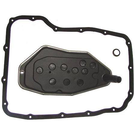

Are you sure the oil filter O-ring is in place? I'm talking the pick-up screen. I may be wrong, but I vaguely recall that with it missing, it wouldn't build enough pressure to shift??? You also want to be sure the old one came out and they aren't doubled up in there.
I changed to an aftermarket spin on filter then switched back to mopar. The mopar filter has an anti-drainback valve. AM does not.

What about the O-ring I mentioned? It goes on the neck that extends up into the tranny as pictured here. Without that tight seal, there is loss of suction for the fluid entering the tranny and therefore, starvation. Again, check to make sure the old O-ring didn't get stuck up in there too. Doubled up es no bueno. There should be a rubbery snap when you push it in and the o-ring seats. Coat it with ATF before installing.

Yes...all three times i removed the existing o ring and made sure the new one was seated properly and the filter popped in
