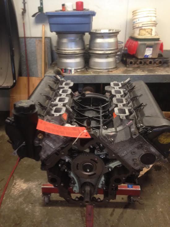

thanks guys, I'm going back to the shop tomorrow morning to complete the engine removal and preparing for the new one... have to say, pretty excited to be putting in a new heart into this thing... jesus will I be treating it like my 2nd born I guess.
I'll be sure to take lots of pictures and post them on this thread.
Again, thanks for the comments and advice.
Oil pickup tube (including crapp and chain guide pieces which continually fell out of the engine as we rotated the carrier)
Valve Cover (This is after much cleaning out of crap)
Buttoning up new engine
