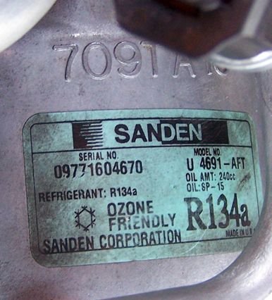

These Picks may help the top pic shows how much oil is needed the next shows a label on the compressor with how much oil it needs.
This is for a 98 Dakota yours will vary check your service manual but if I remember its only a little less oil for a 2004.
Oil should be pag 100 comes in a shot can and bottle
For oil how I did it was measure the needed amount of oil from a bottle pore how much oil the compressor needs into it install it close the system up then after a vacuum test is done inject a 3 oz. can of pag 100 into the system.
The amount of oil needed is very confusing but how I did it worked well as you will have oil still in the system how much is the unknown equation that is not easy to understand.
Too much oil is bad not enough is very very bad and will burn up the compressor so more is better but try not to do that.
