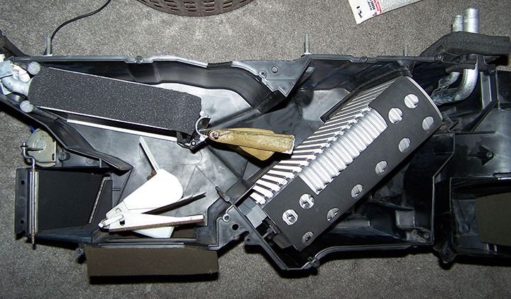

Old Oct 19, 2016 | 02:51 PM
98DAKAZ's Avatar
98DAKAZ
Joined: Jul 2011
Posts: 4,895
Likes: 35
From: Gilbert, Arizona
This is what a 97 to 00 Dakota HVAC box looks like I 100% rebuilt it way simple compared to a 2001 and up.
