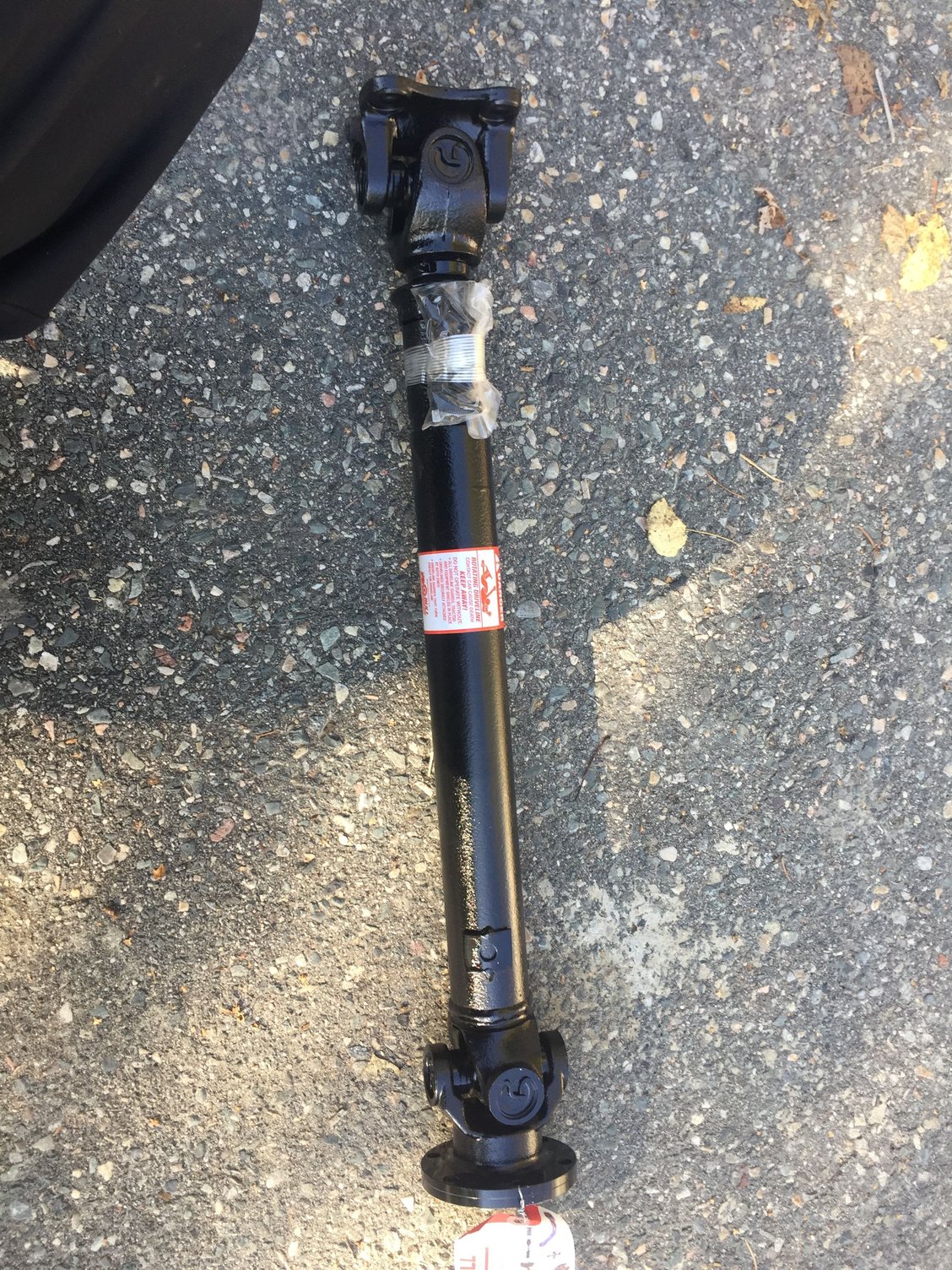

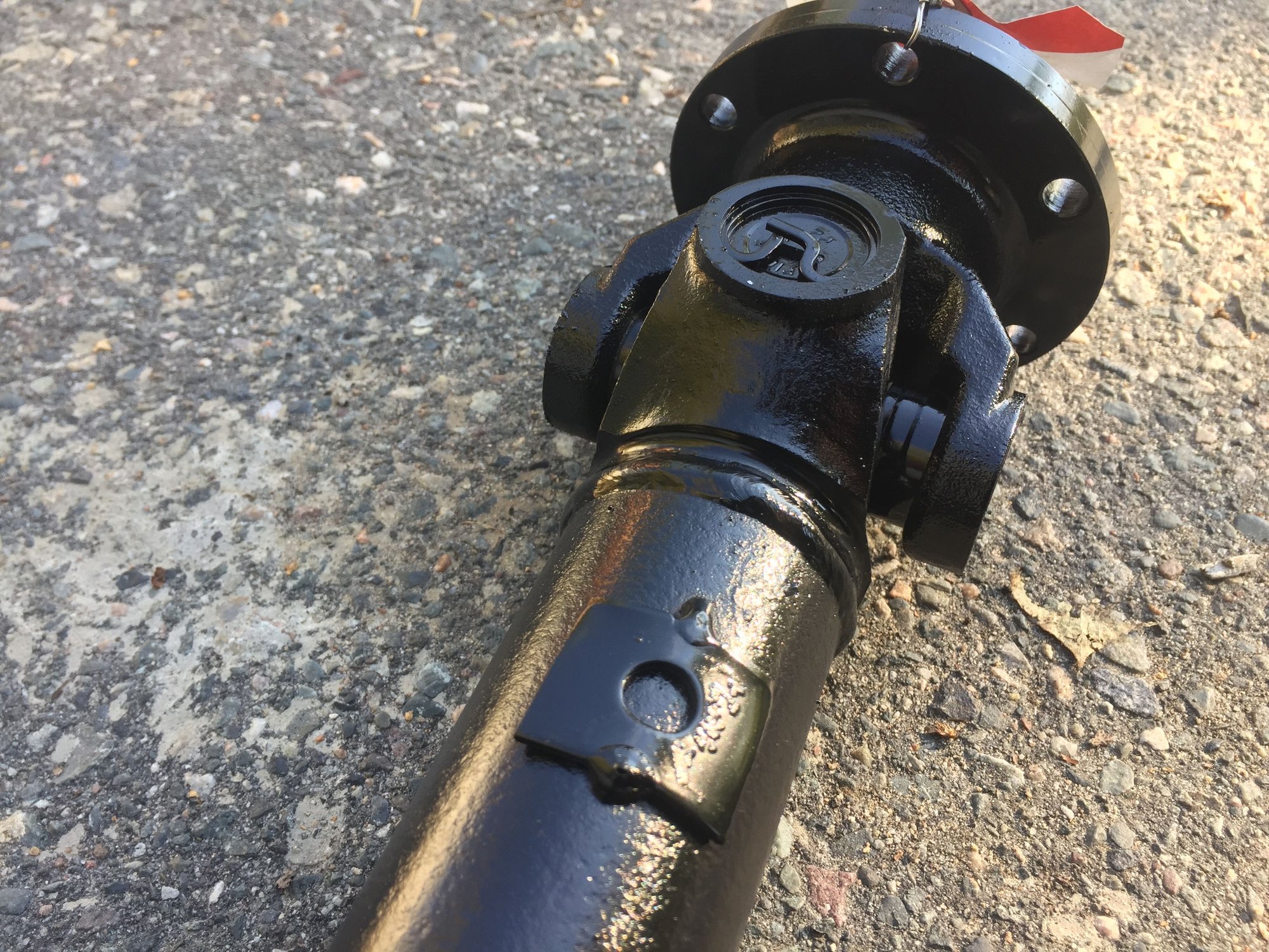

this was the outcome of scrapping the cv joint ... pic 1 is the replacement spicer 1310's greaseless and mounting to mount to stock t-case output..
sandblasted balanced and painted.. looks like a brand new shaft total cost was still cheaper then replacement shaft from rock auto and this is probably stronger then a cv joint.. who knows but atleast I can service this myself with a new u-joint if it does wear down..lol
