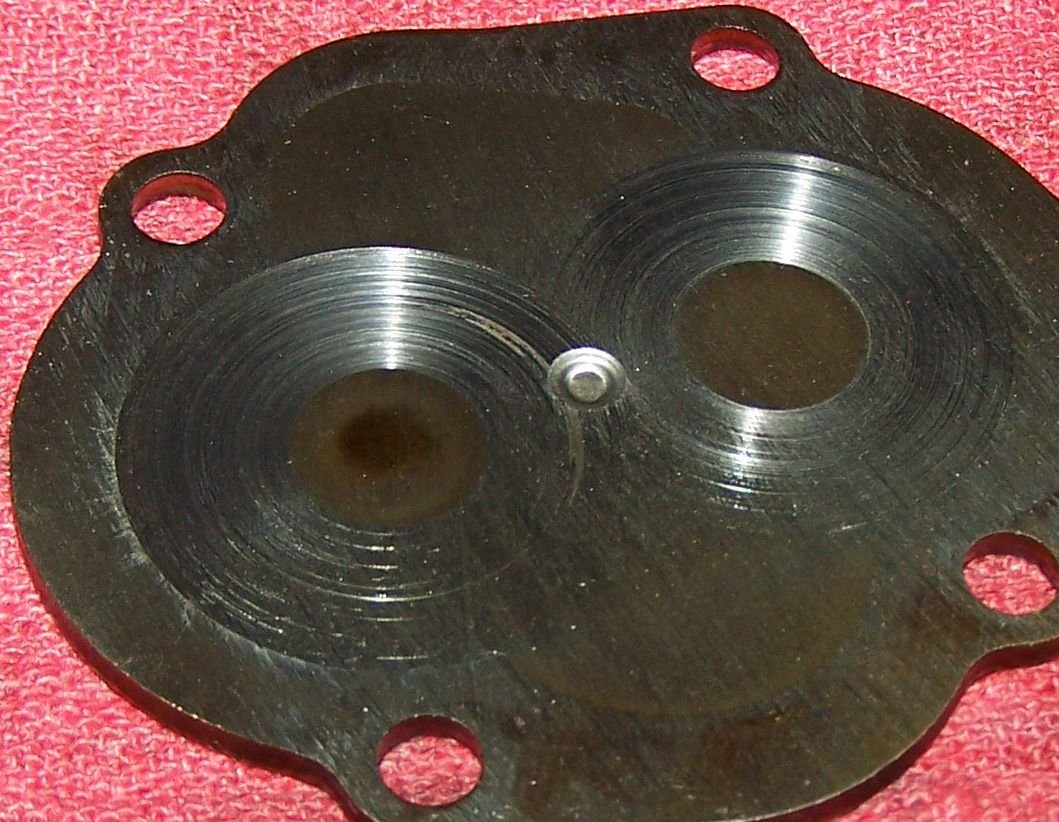

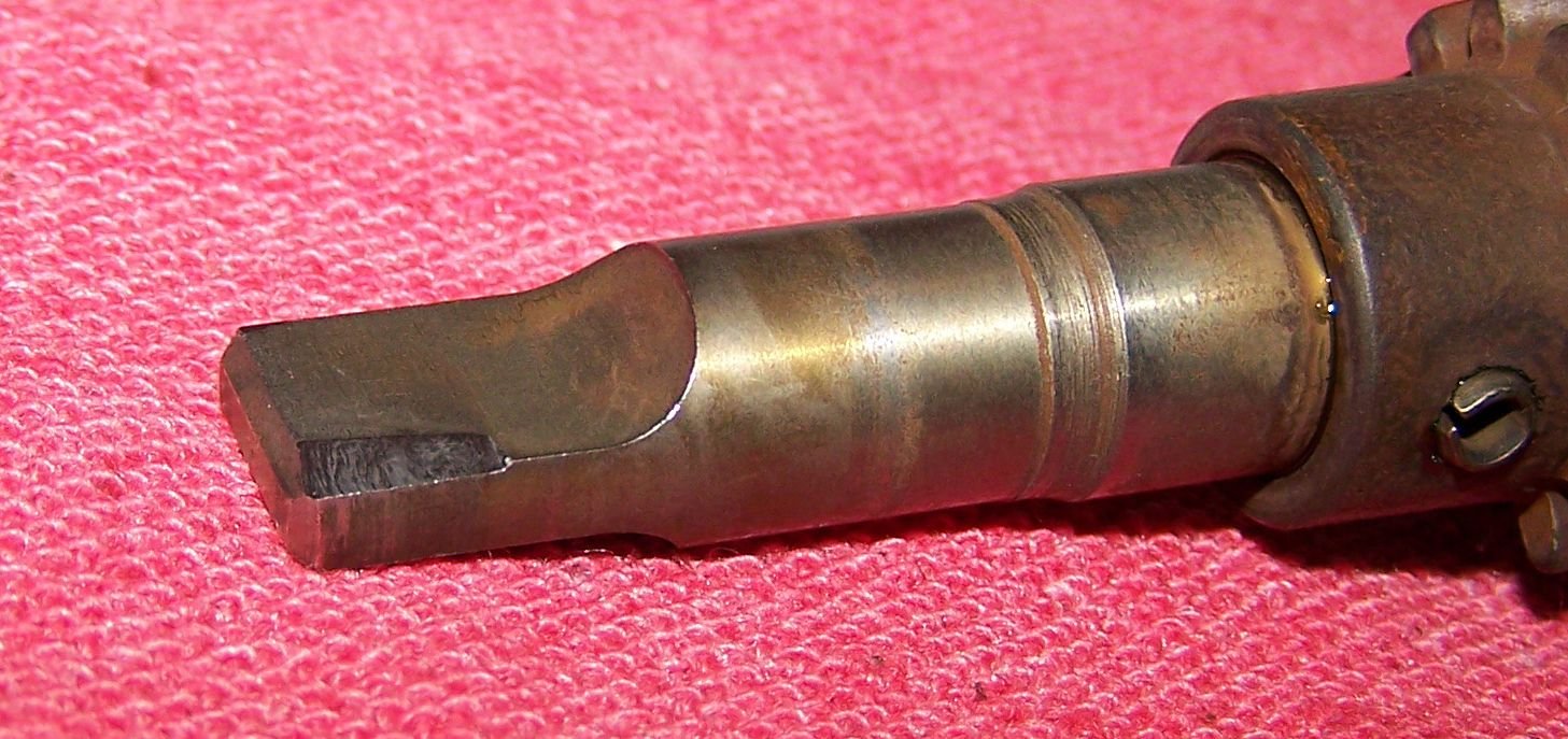

Well I have two possibility I may be off one tooth or distributor is bent twisted.
At tear down I noticed the oil pump had lockup at one time pump was chewed up inside so was distributor oil pump blade/shaft Im thinking distributor shaft got twisted so timing is messed up.

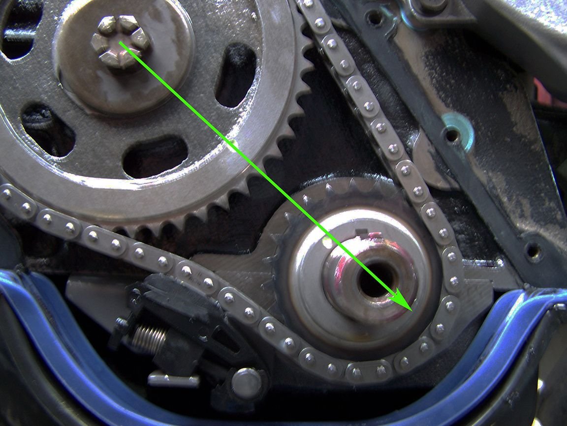

I just check my timing marks and thats perfect the service manual says to check count the chain rivets 20 its good like in the pic.
So I ordered a new distributor I will see if thats the fix.
