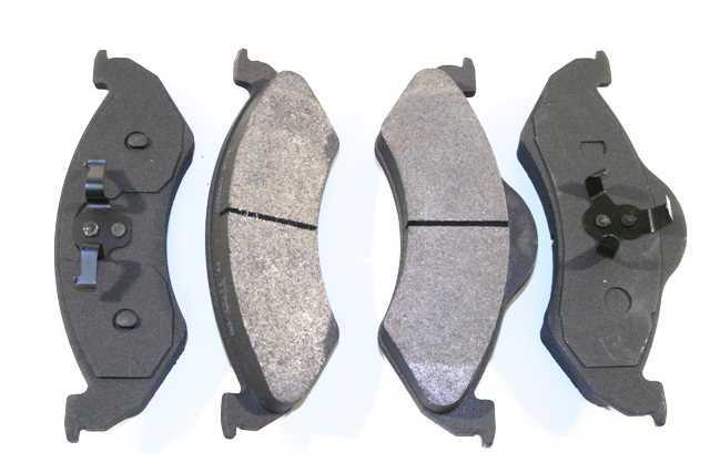

After changing pads an rotors many weeks later i noticed that after i come to a complete stop when backing out in a turning mode ,there is a pop..
I wiggled wheels,no play at up an down motion ,or in left to right either.
New vertical sway bar parts too.
Do these pads with the push in clips on em SHIFT ,or maybe caliper moves?
It is pretty tight with everything new.
Are the pads / caliper possibly making this noise?
What else should i look at or try testing when driving?
