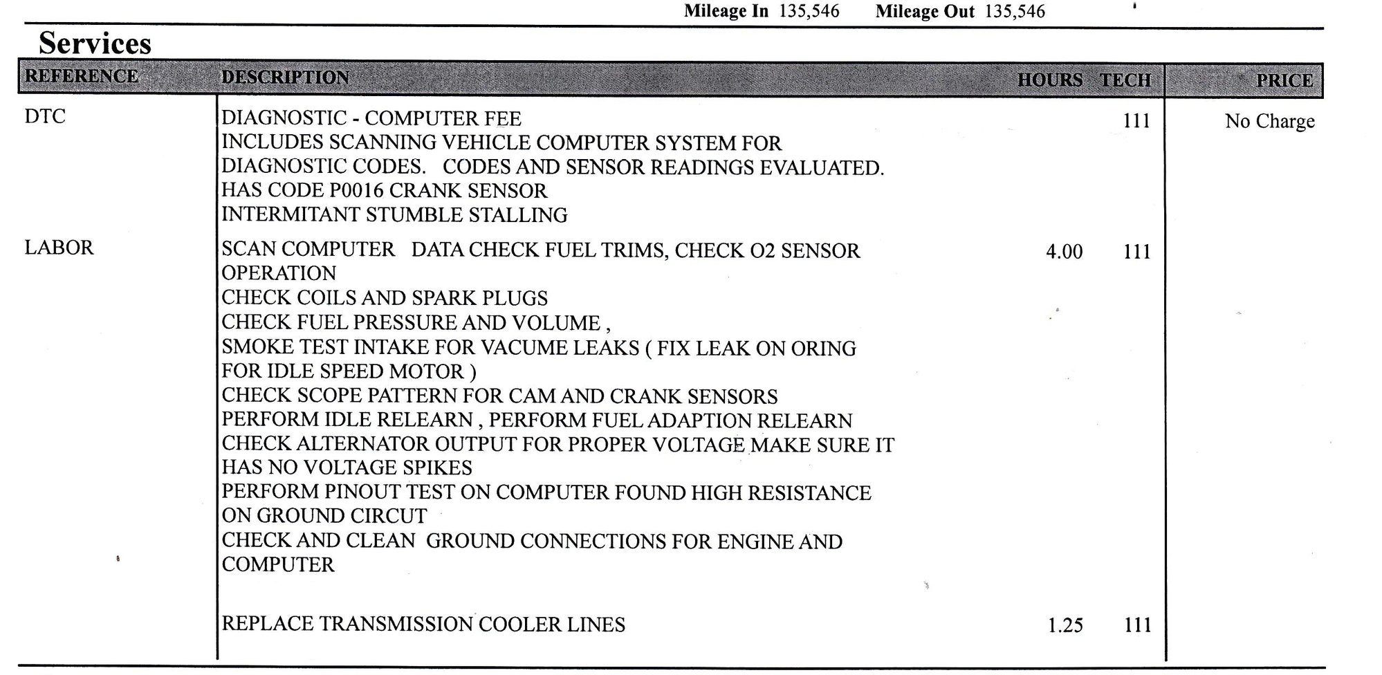

So just to post an update, my truck is FINALLY running right!
We have determined that a corroded ground was causing the idle issues, and was most likely related to the misfiring, or camshaft sensor code the new PCM read. Im enclosing a snapshot of all that we did to finally conclude this matter, (hopefully). Again thank you for the responses and helping this Dakota out.

That's not a terrible bill at all.
Yeah, that whole "No Charge" thing is pretty nice. Wonder what the rest of the bill looks like.
I meant the 4 hours for electronic troubleshooting. It's not terribly bloated for what is listed.

The diagnostic charge ($75) was paid previously when we determined that the PCM was not picking up obvious codes like misfire, etc. My replacement PCM cost me $170.
