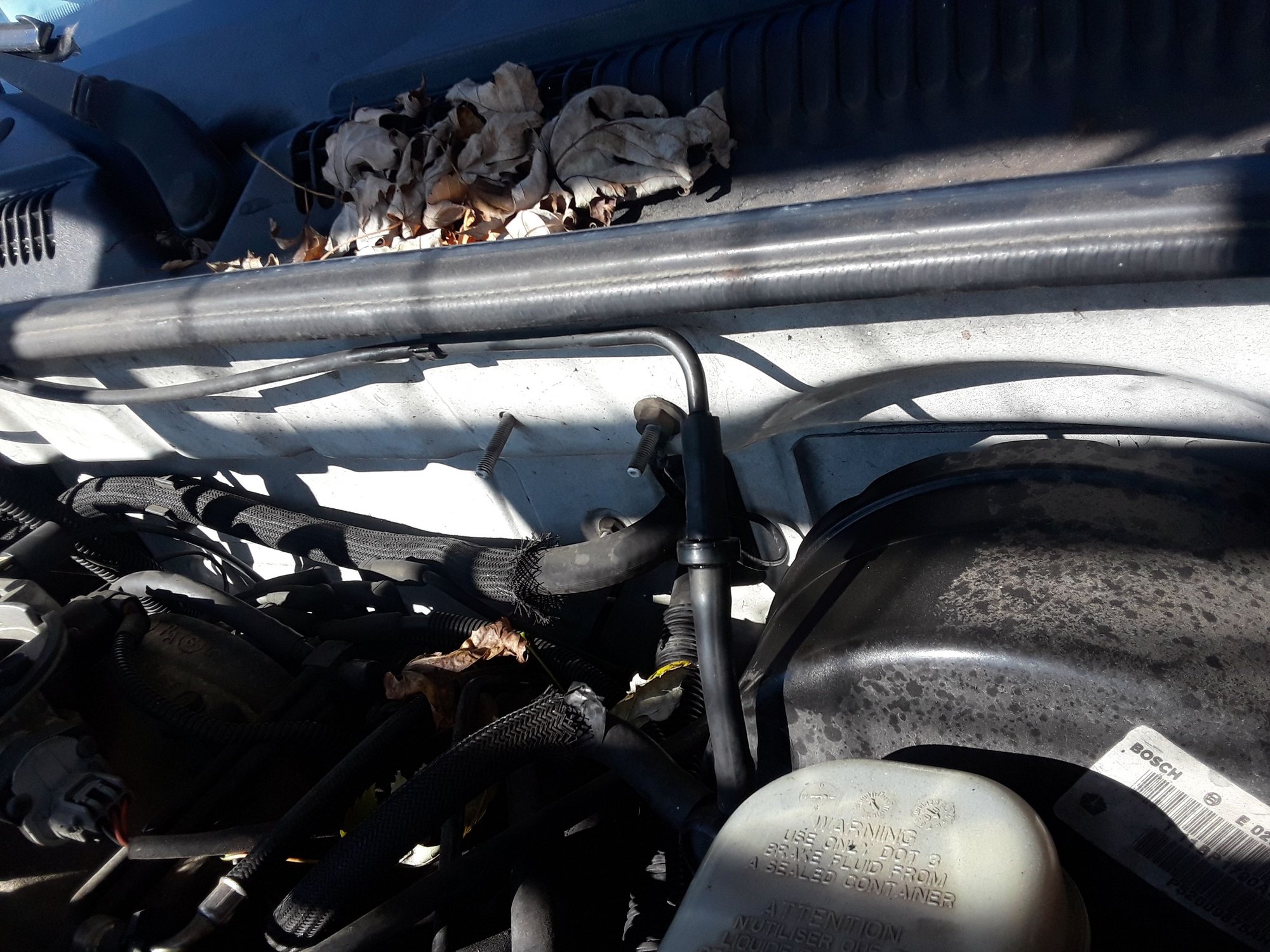

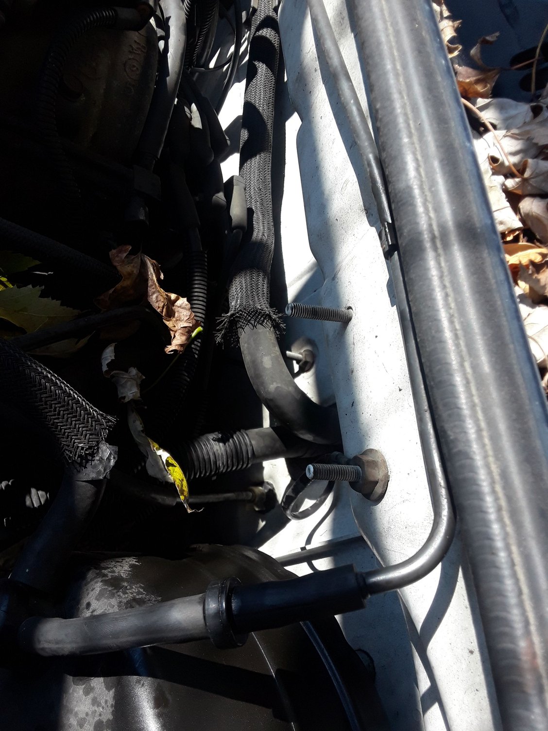

I wanted to know also if this check valve has anything to do with air output it's at brake booster..

Yeah, check valve will maintain some vacuum in the booster, should the engine stop running. You get one or two presses of the pedal before all assist goes away. (then it's like stepping on a rock.....)
