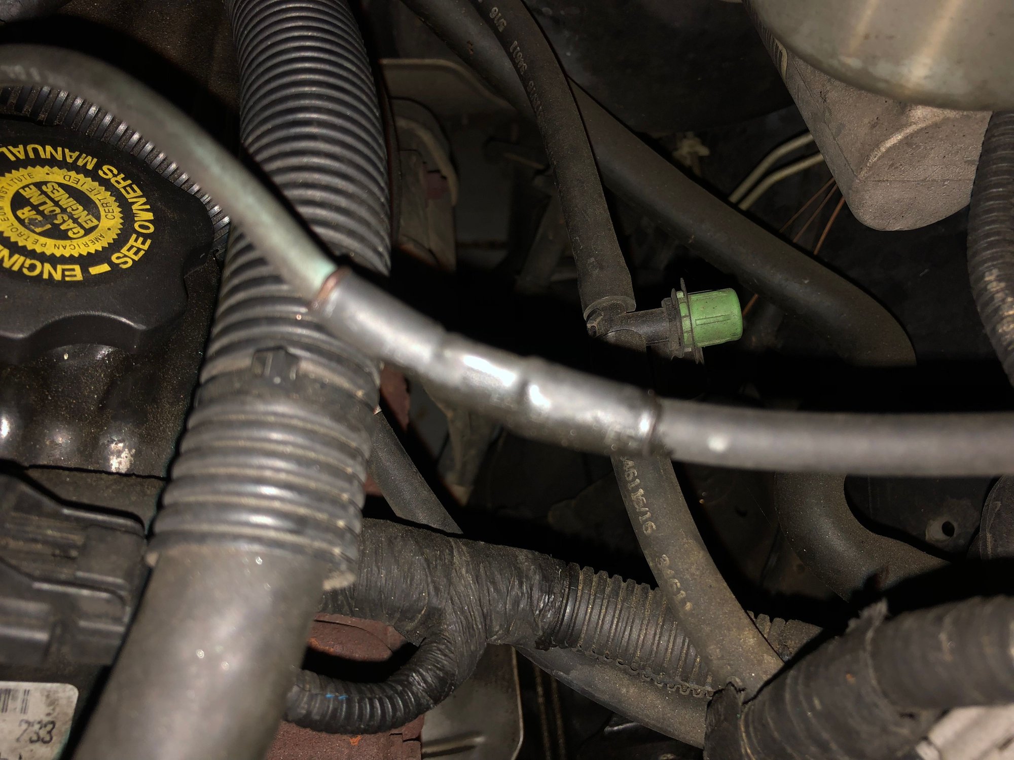

I have the exact same fusible link in my 3.7 it's definitely not stock,, possibly a recall repair.
