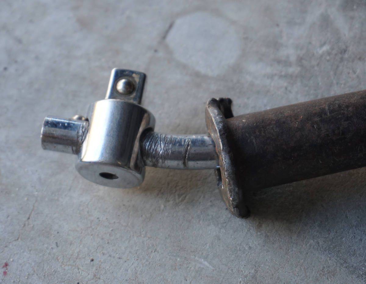

Ah Chineseium. what a marvelous mysterious metal you are!
It's like they put chrome on a noodle.
