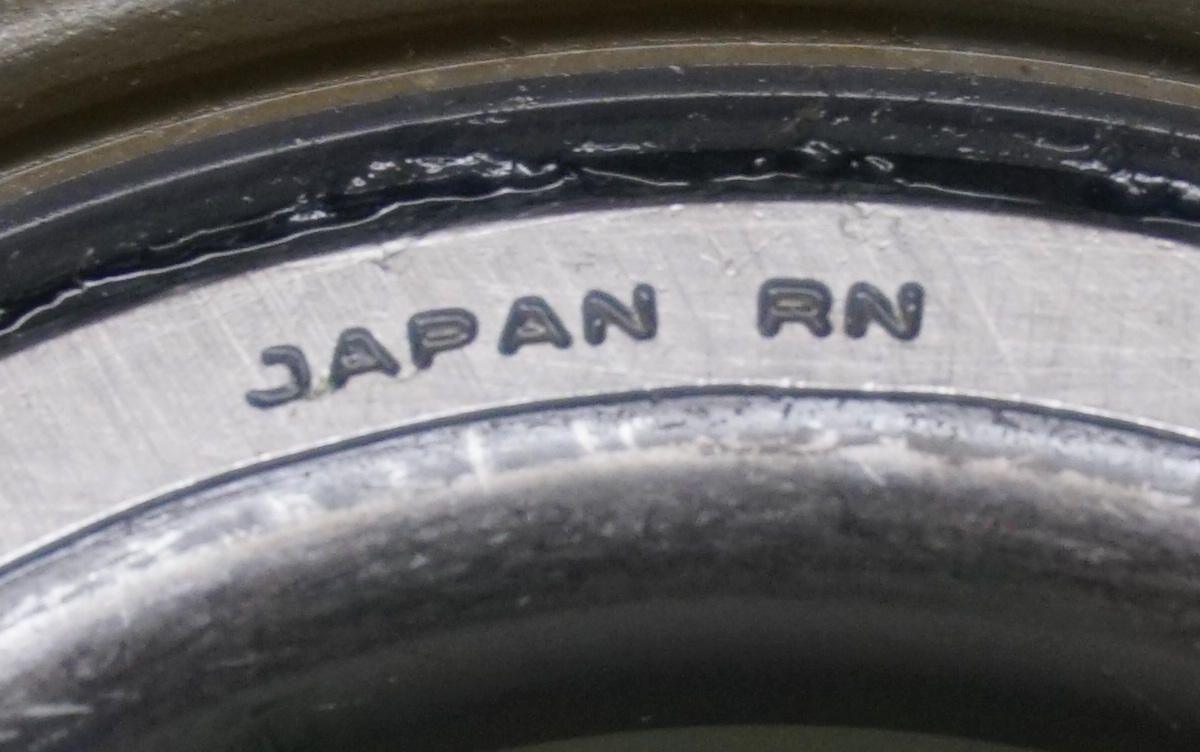

The bearing itself seems to be made by NTN out of Japan. I prefer the Japanese bearing over Chinese or Taiwanese bearings simply due to the fact that Japanese companies on average seem to take great pride in precision. HOWEVER that being said, i am somewhat discouraged that the outer wiper on the bearing seal is not contacting very well on the inner race. Although im sure the inner seal wiper is.

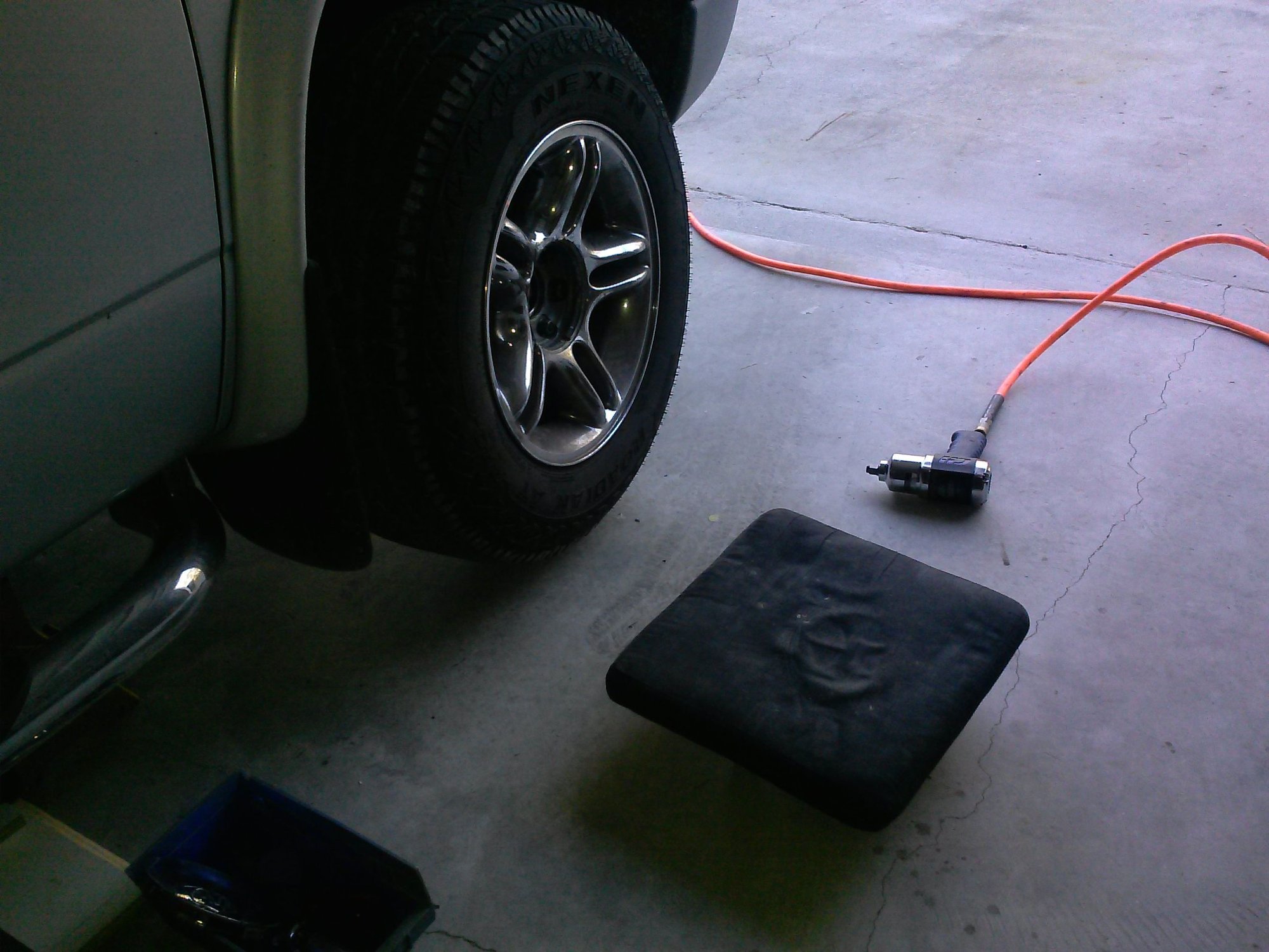

Getting ready for the attack, nice flat surface to work on. Parking brake on?...Check!

Butt Scooter in position ready to begin
