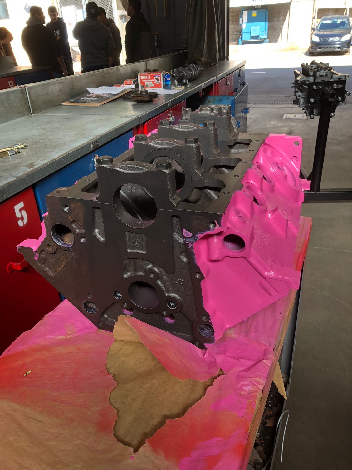

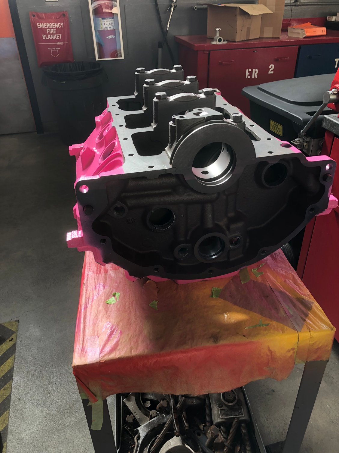

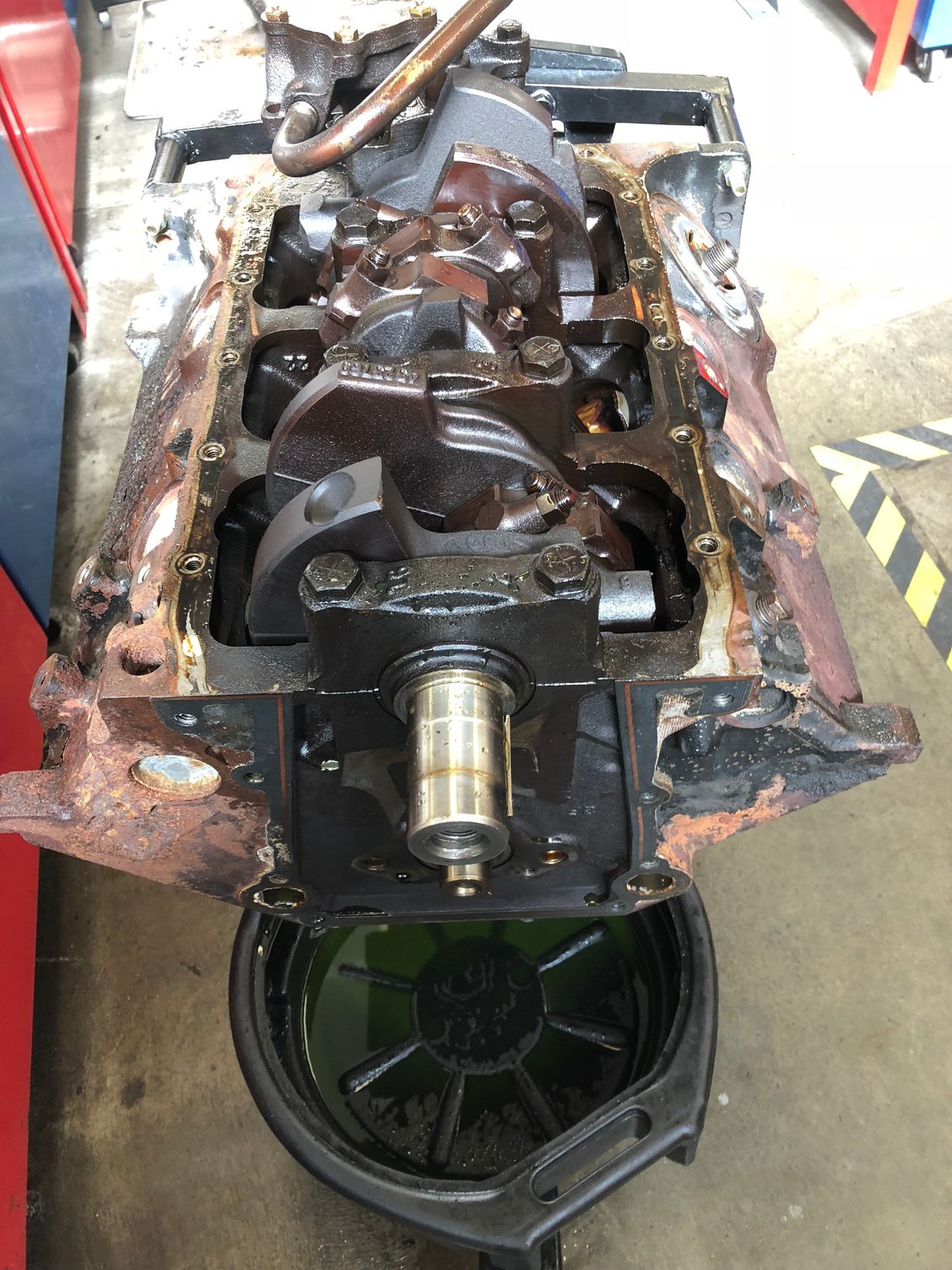

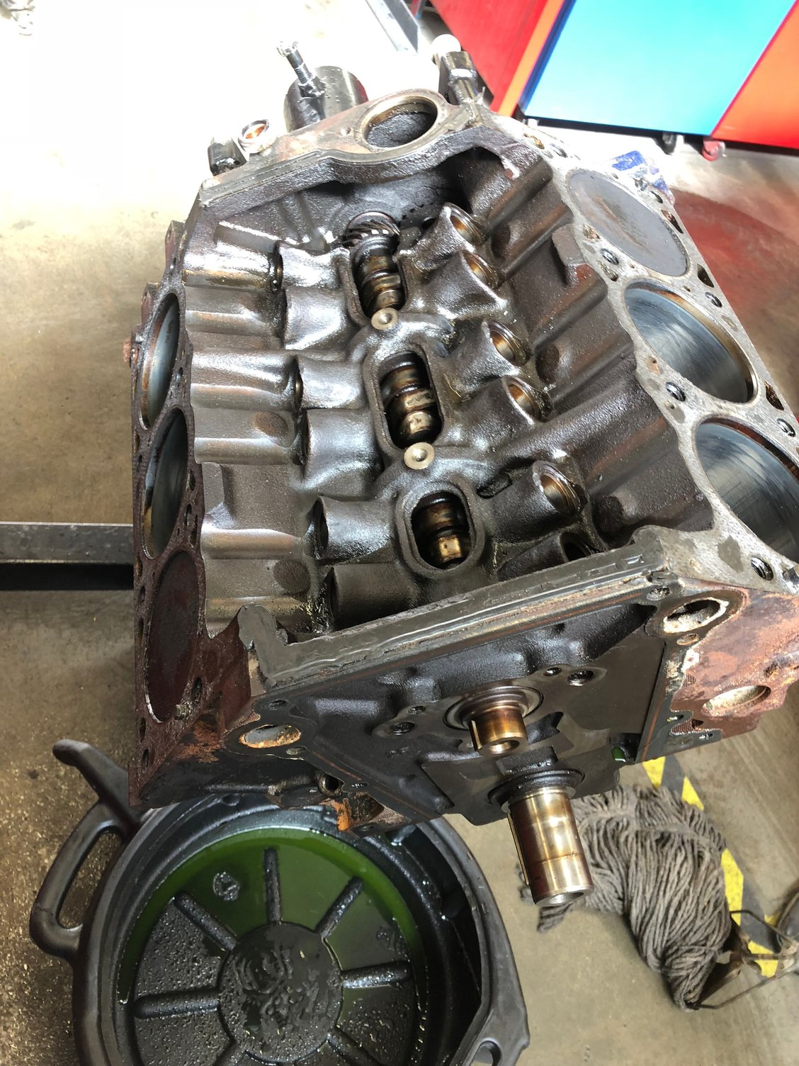

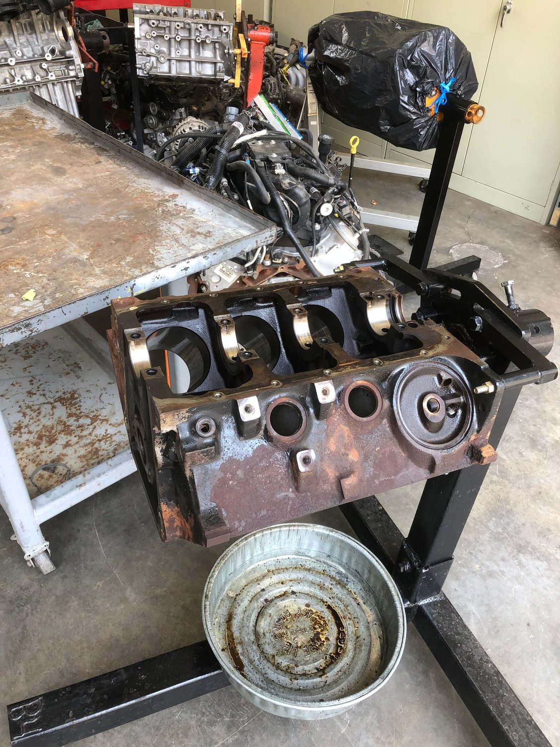

I am taking a class on rebuilding engines. This engine is from a 2001 Dodge Dakota: a 3.9 L V-6. I have a 2000 Dodge Dakota with the same engine. The previous engine owner didn’t change the oil very much and the cam shaft is wrecked. Bolts on upper assembly components were Metric, lower components were SAE. Currently chasing the threads and cleaning before I start my measurements

Pictures are a little out of order. I bought the engine off of E-Bay. Figured once I finish it I will drop it into my 2000 Dodge Dakota and then rebuild the 2nd engine. Still working on my build sheet for it.

Pink?? What prompted that choice?
Have fun with it!

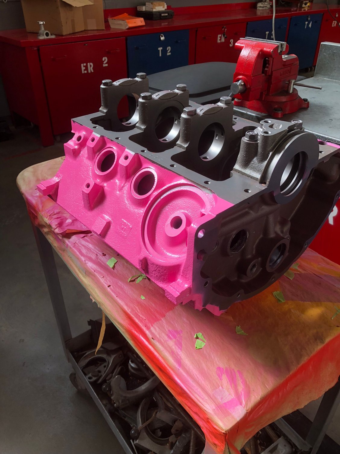

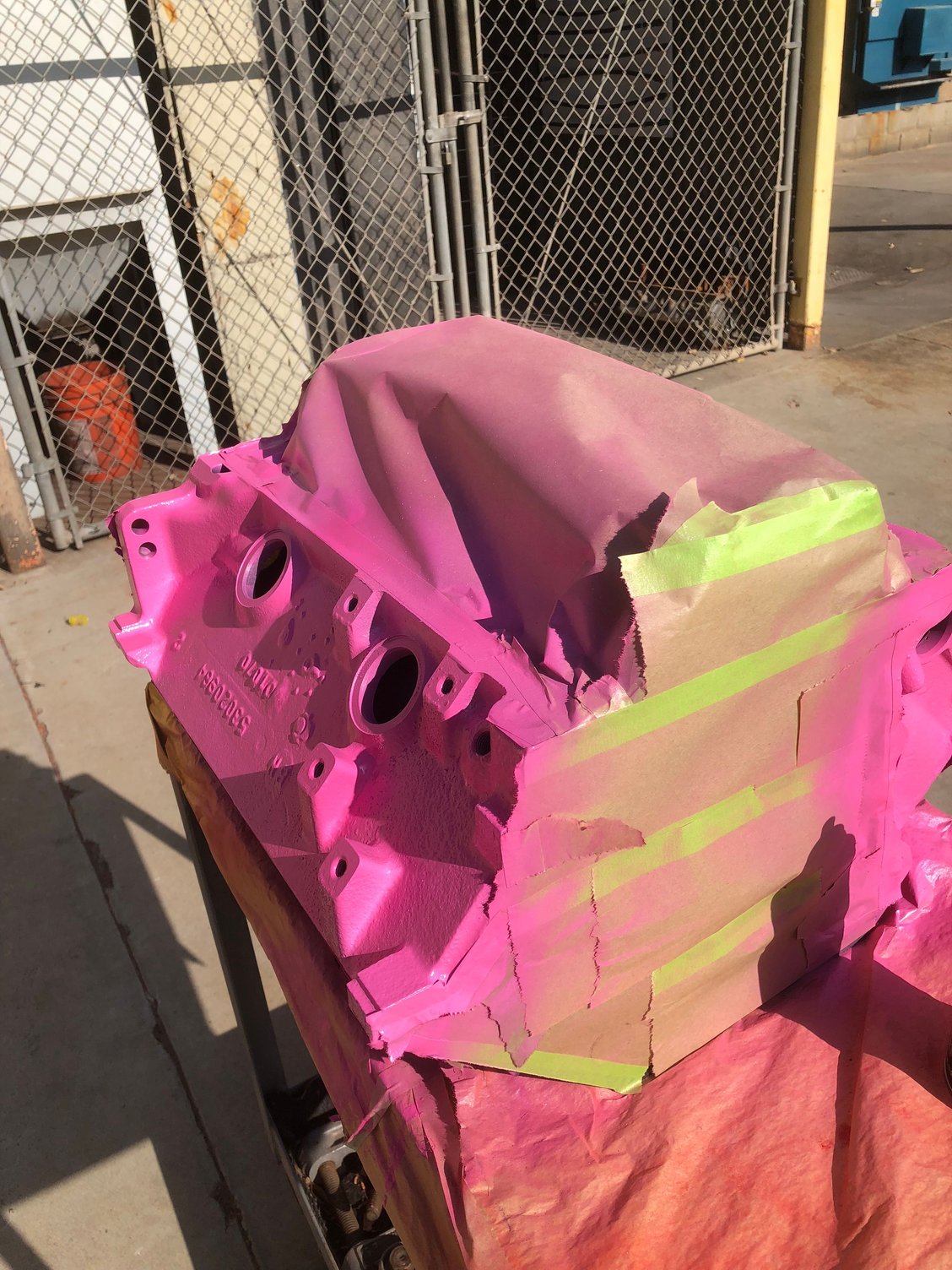

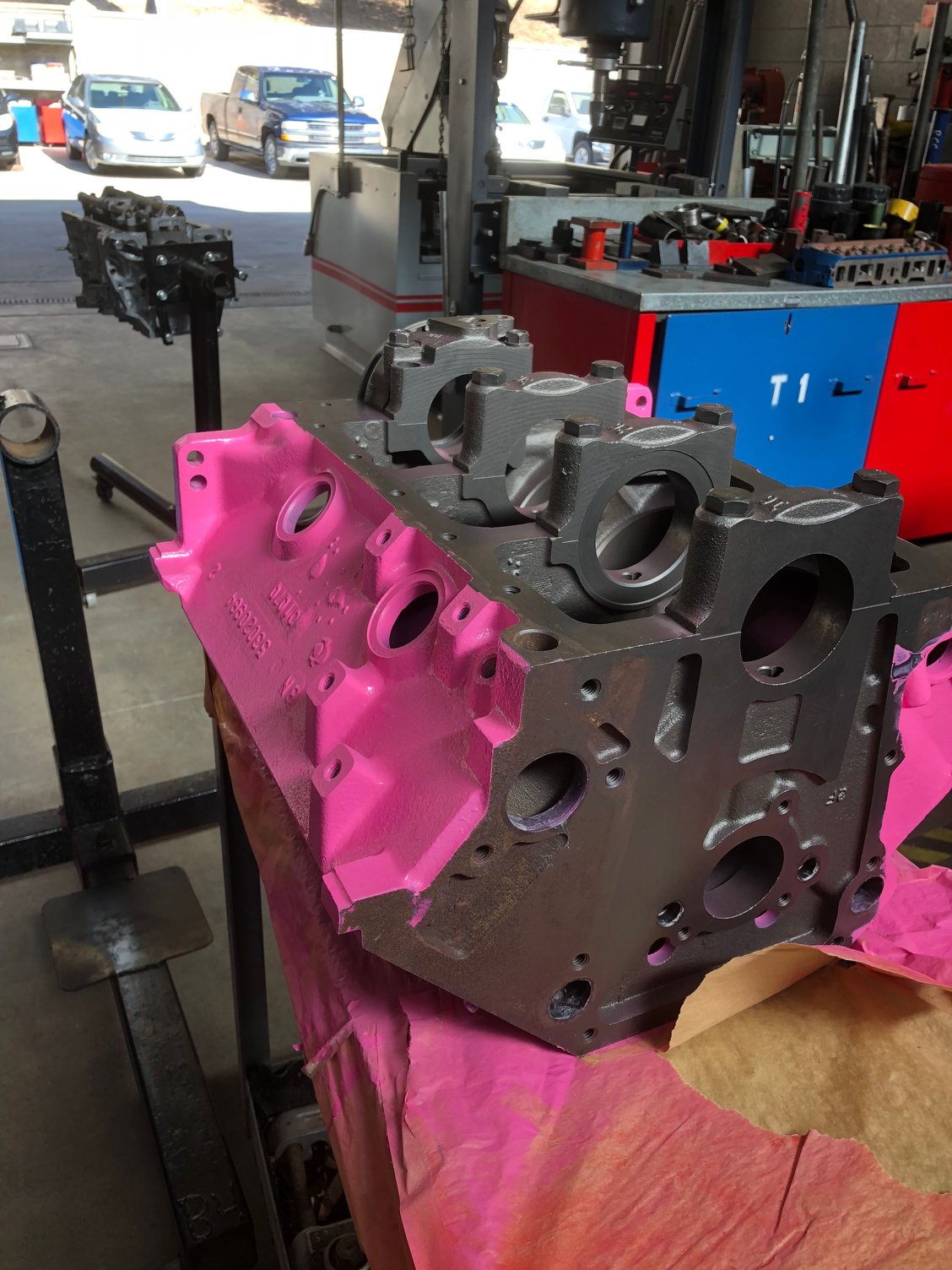

Thought I would making look like a Toy since it is powered like one....reliable little beasty though....it is going to be pink, blue, fuschia, black, but the fan is going to be yellow...I was thinking of painting a Hello Kitty somewhere on it....and maybe a rainbow and a unicorn on the beer keg intake manifold...

LOLOL. I like the Hello Kitty idea, and the unicorn is mandatory.

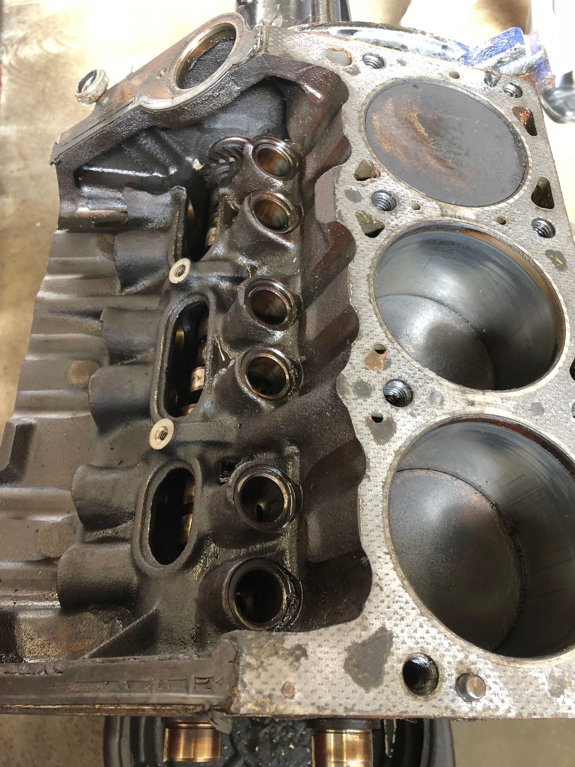

So forgive my ignorance but, that cam damage,,, is that roller failure or simply not enough lash adjustment on that cylinder or a slightly bowed cam??

Typically chunks missing from the cam is poor oiling combined with high heat (again, lack of oiling...) and high pressure. Hydraulic lifters don't exactly have 'lash' but rather 'preload', which is static set with factory valvetrain. Once hydraulically pressurized, there is also pressure exerted on the ca lobe itself, even on base circle.
This differs from manufacturing anomalies, which appear in hundred of miles with missing chunks (or lobes altogether), not thousands of miles with pieces missing.

According to the folks I bought the engine from it had 145K miles. It took me a good hour or more to work out the lifters, that old oil had turned into tarnish, and I kept spraying them with PB Blaster penetrating oil and working them back and forth with my fingers before I could get them out.
