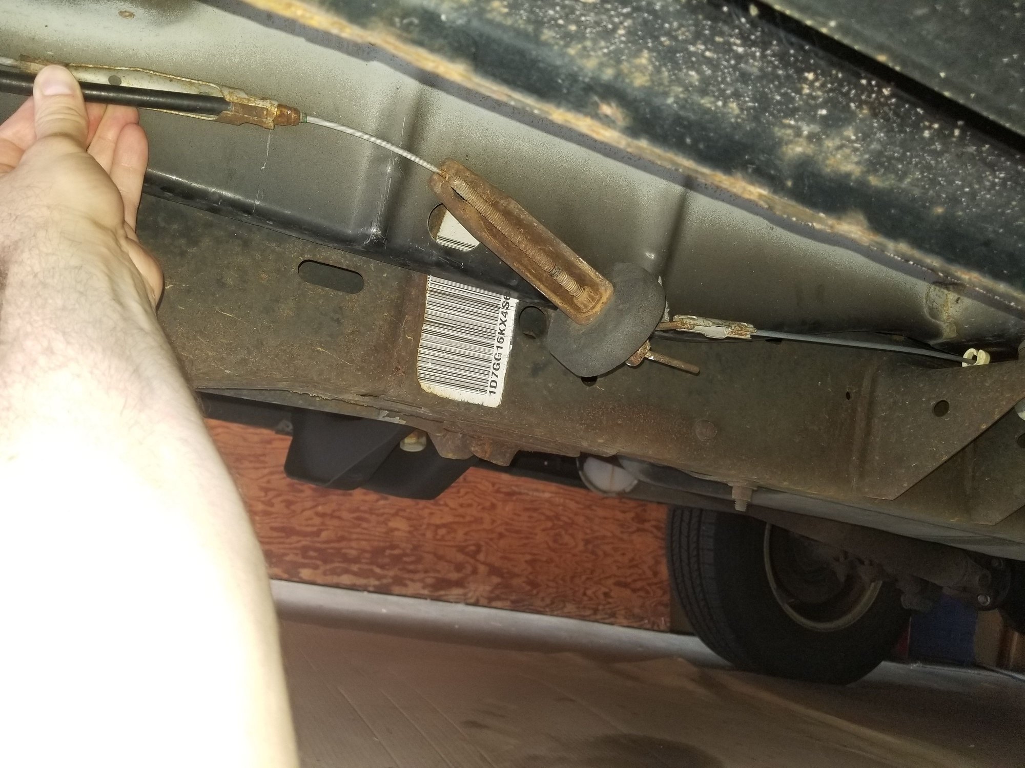

Originally Posted by soccerguy136
Awesome! Thanks so much for the pics! That helps a lot.
Is that resting or locked position?
Either way, it's clear that one, or both, of the cables have stretched beyond repair.
That is locked (this is my race truck, it doesn't have park, just reverse/neutral/forward). But even when released, it's very little difference.
I've not heard of the cables stretching before. I'm also not sure if there is any adjustment in the pedal.
Look at where the threaded adjuster is, inside the rubber snubber. Slide the snubber forward, see if that threaded rod is fractured or if you can thread it in any.

The threaded rod is not fractured and the nut is threaded all the way to the bottom. It was about halfway before I started the adjustment and then I tightened it in the hopes that it could take up the slack.
I don't think there is adjustment at the pedal either, but I will check when I get a chance.
Since everything is connected and the pedal still tightens everything, just not enough, stretched cables are the only thing I can think of.

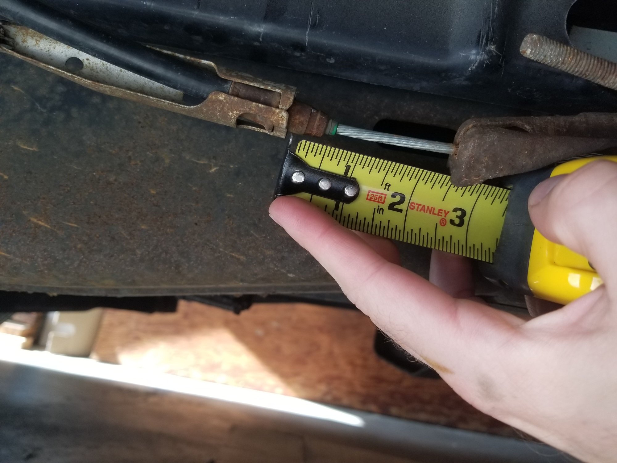

Just to rule it out, here's some measurements I just took. Keep in mind, this is with the brake applied.
On the 4th one, the end is even with the crimp, it just doesn't look like it due to perspective.

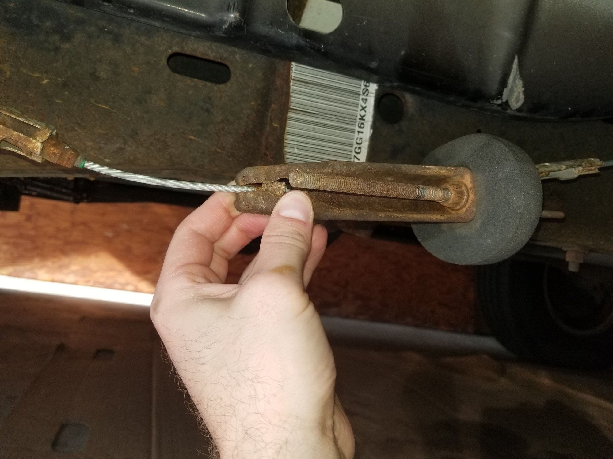

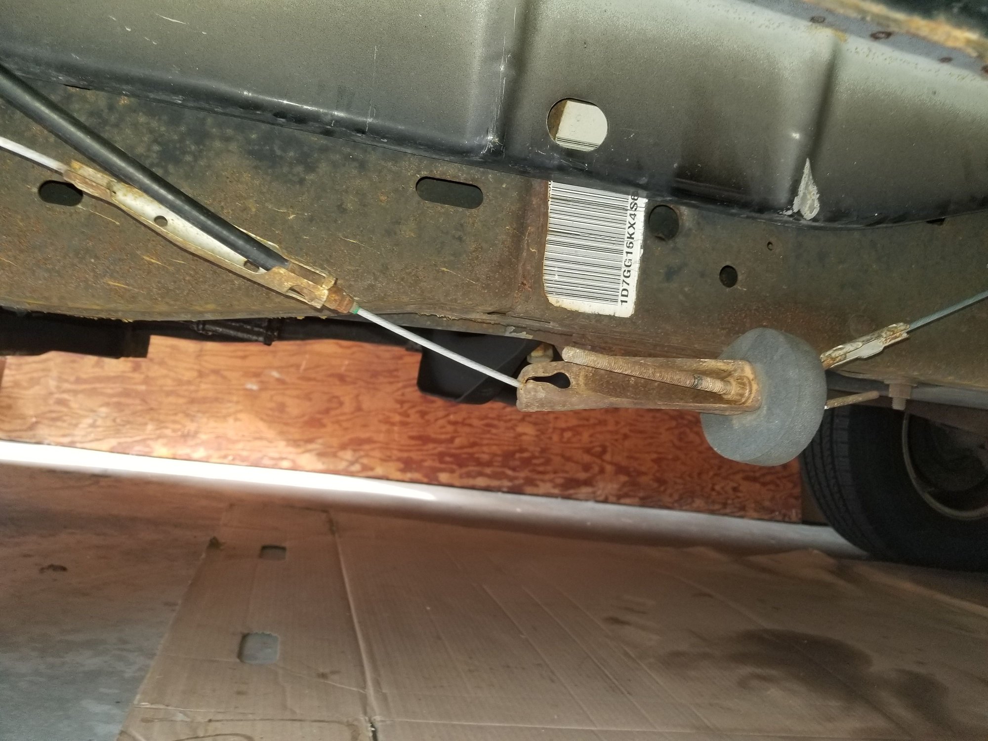

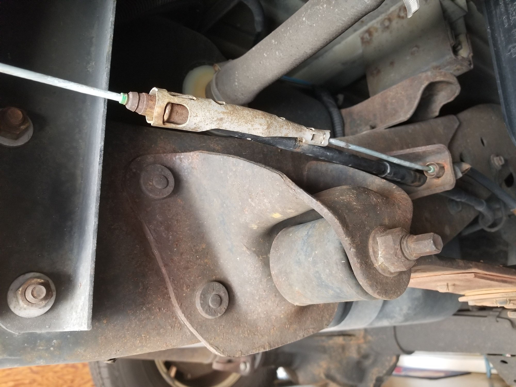

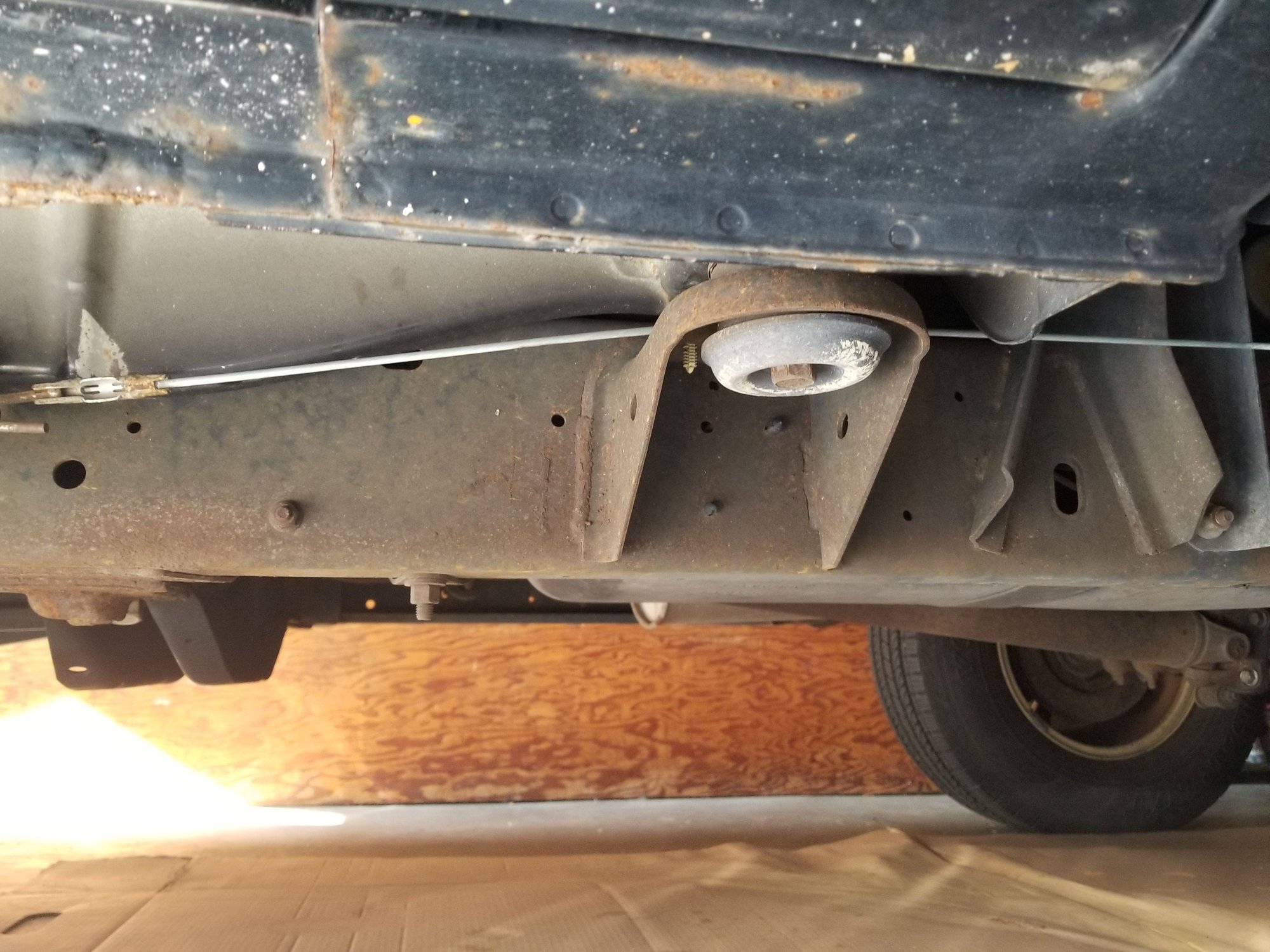

Hey, sorry it's been a while, but I've been slammed.

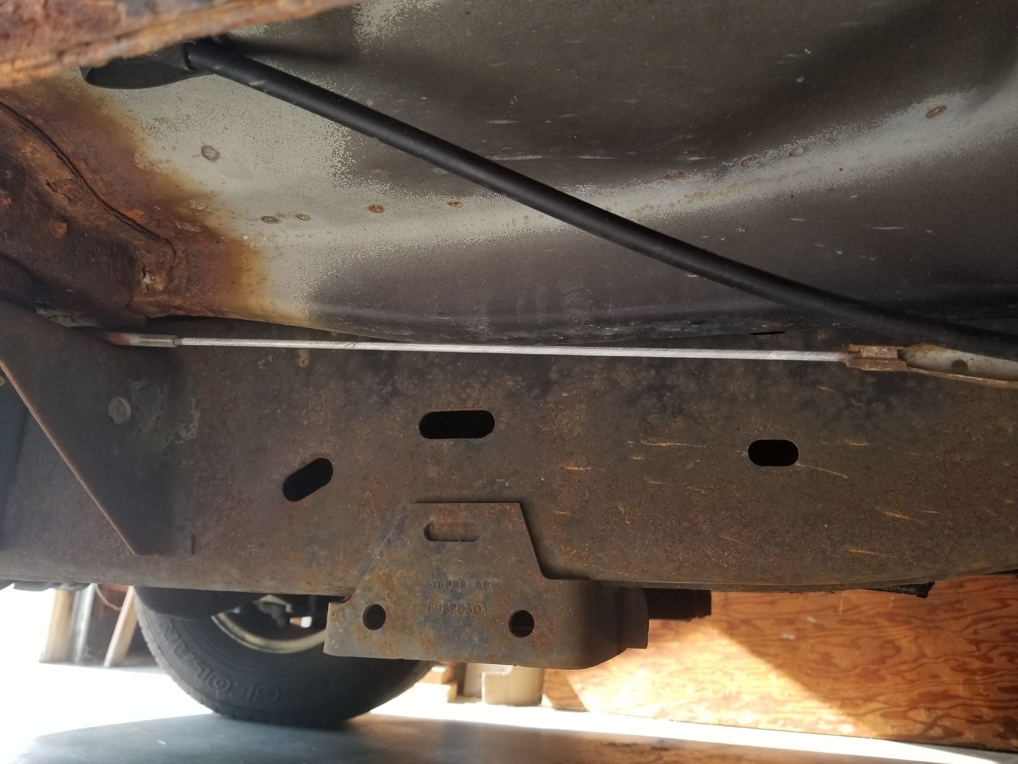

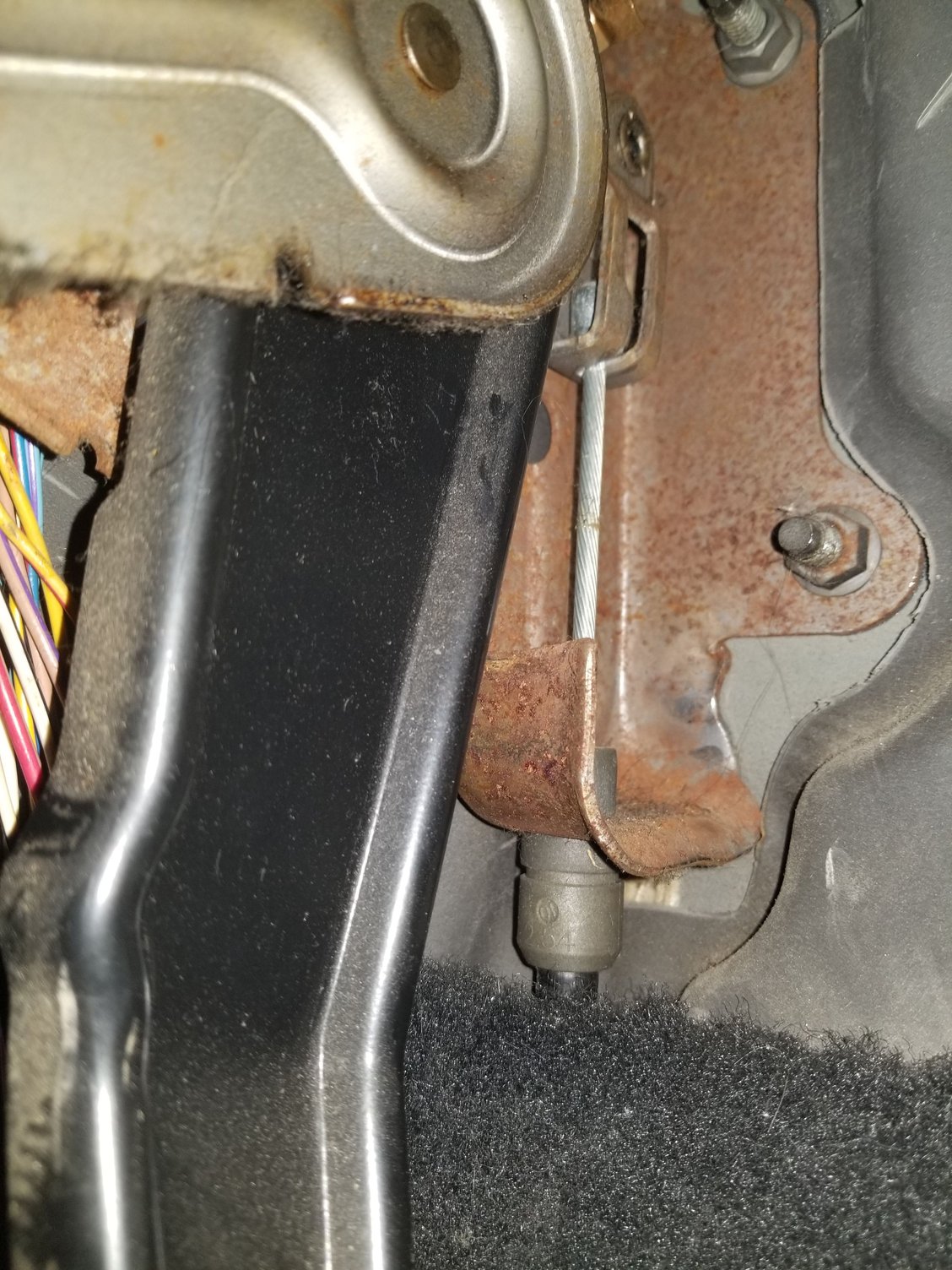

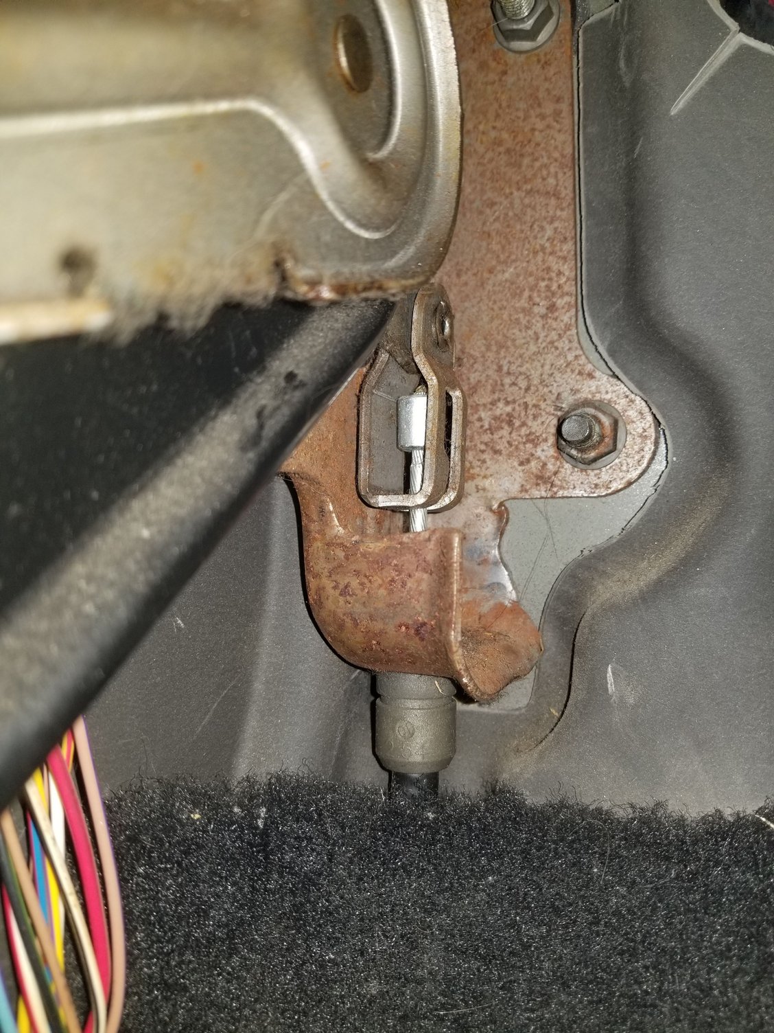

First thing, it looks like you have an intermediate cable that I don't have. I only have 4:
1. Pedal to tensioner
2. Body to tensioner
3. Tensioner to rear passenger
4. Tensioner to rear driver
So here are the pics I was able to take. From what I can tell, the fault lies with either number 1 or number 3. Number 4 doesn't move, but it could be due to the slack in the rest of the system.
This is with the pedal fully depressed.
This is with the pedal all the way up. Seems like there is a lot of slack.
This cable seems fine imo.
This is with the pedal fully depressed. As you can see the tensioner is all the way adjusted as well.
Pedal fully depressed.

Old Jul 31, 2019 | 08:01 PM
soccerguy136's Avatar
soccerguy136
Joined: Jul 2019
Posts: 12
Pedal Fully depressed
Pedal all the way up

It's tough to tell which cable is at fault, maybe that's because both are? The rear definitely seems to not be pulling as much as it should, which I could see causing the front not to seem as tight.
