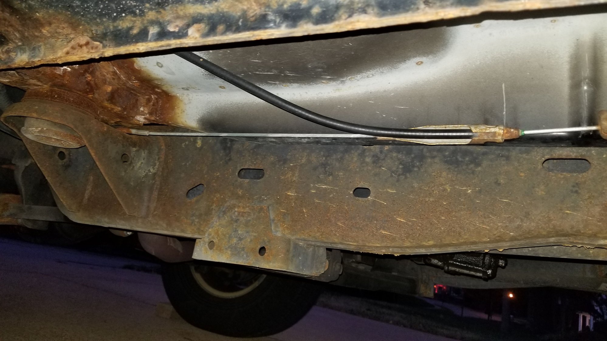

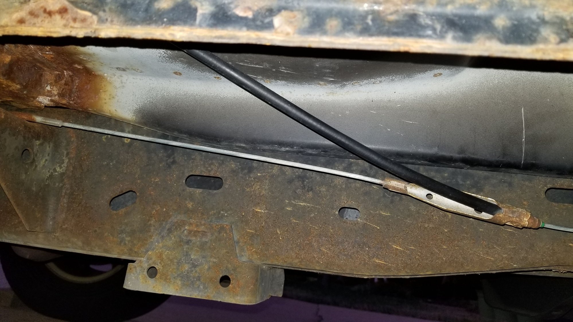

So it's been a few months but I was finally able to tackle this problem. It was both rear cables, with the main problem being the longer passenger one. Changing those out has brought the adjustment back into much more reasonable territory, as you can see from the pics.
One last question for anyone reading, I tried the adjustment method in the manual, with a 1/4" white marking you see in the picture, but it didn't seem to be changing. So I ended up just adjusting it until I couldn't move the truck by pushing anymore and that seemed to be good enough. I didn't want to overstretch the new cables either.
Has anyone followed the FSM way and had it work out?
