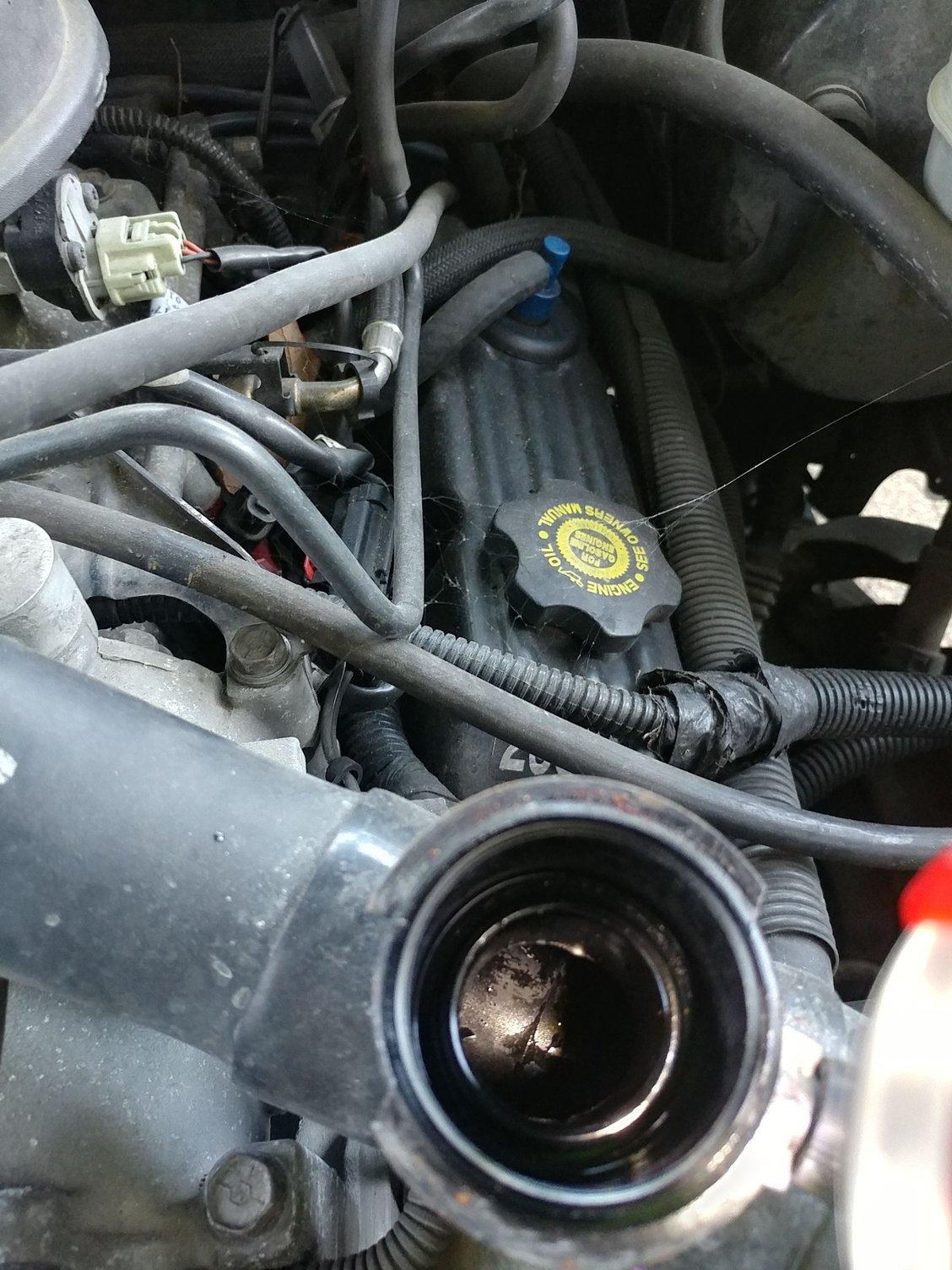

Yes that is what the engine looks like. Even the color of the truck 😂 there is no coolant in that hose when I take the cap off when it's cold. It was suggested to me to get a new cap and I did. I got what was recommended. I'm trying to do this myself and learn and this is appreciated. I will take a pic and put it on here. I'm learning this site also. The small hose is tbe original and I have tried to get it off with no success

This is thr cap
It is dry so does that look like the right cap in the photo above. I hate getting parts because most of the time (as being a women) i feel they would just sell me anything. Idk if that true but...and the small hose is not the original sorry about that. It is newer
Old Jul 19, 2019 | 09:07 PM
Posts: 87,483
If you add coolant there, does it all just disappear? Or will it stay there for a bit, and then be gone the next time you look?
