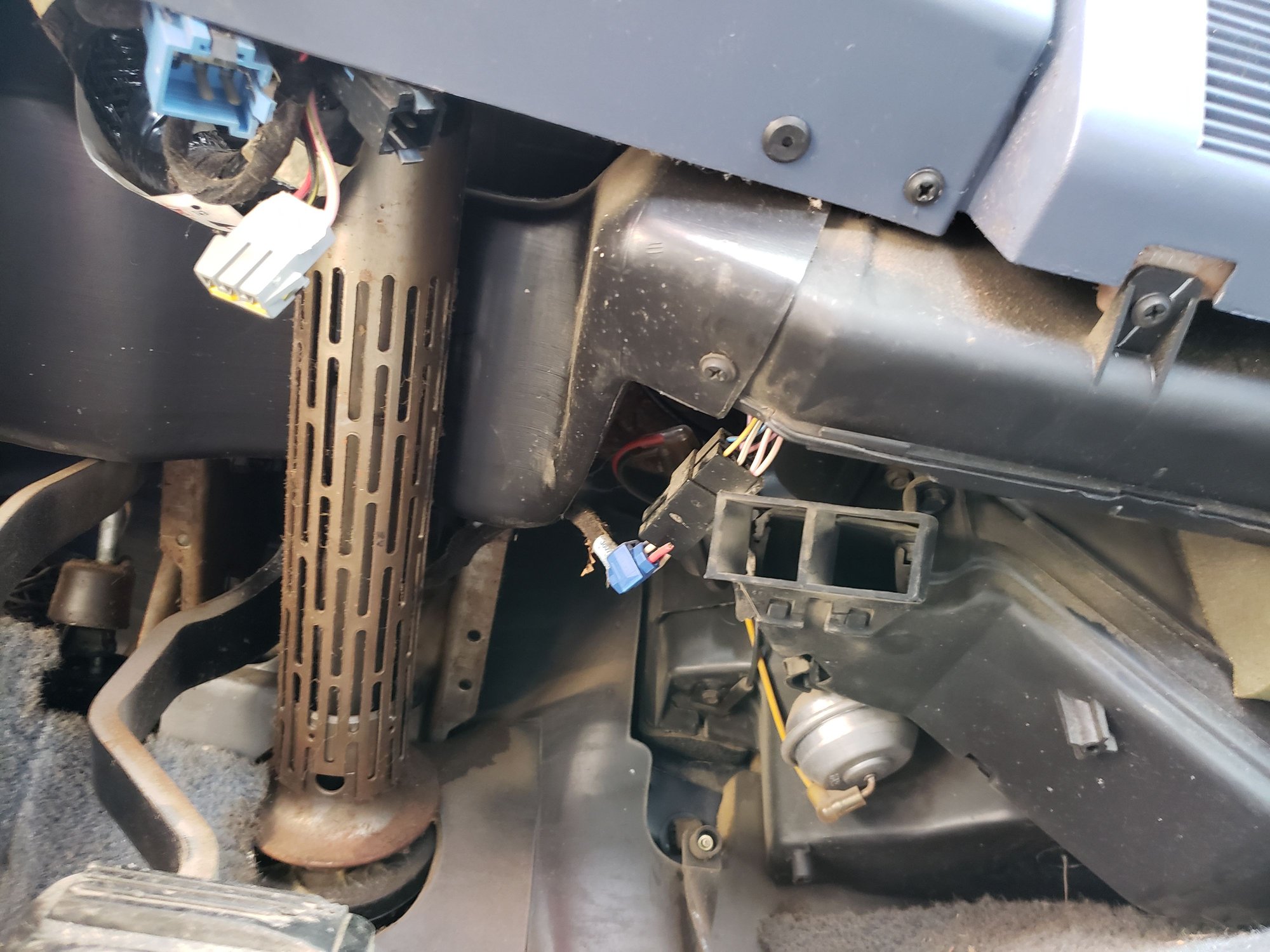

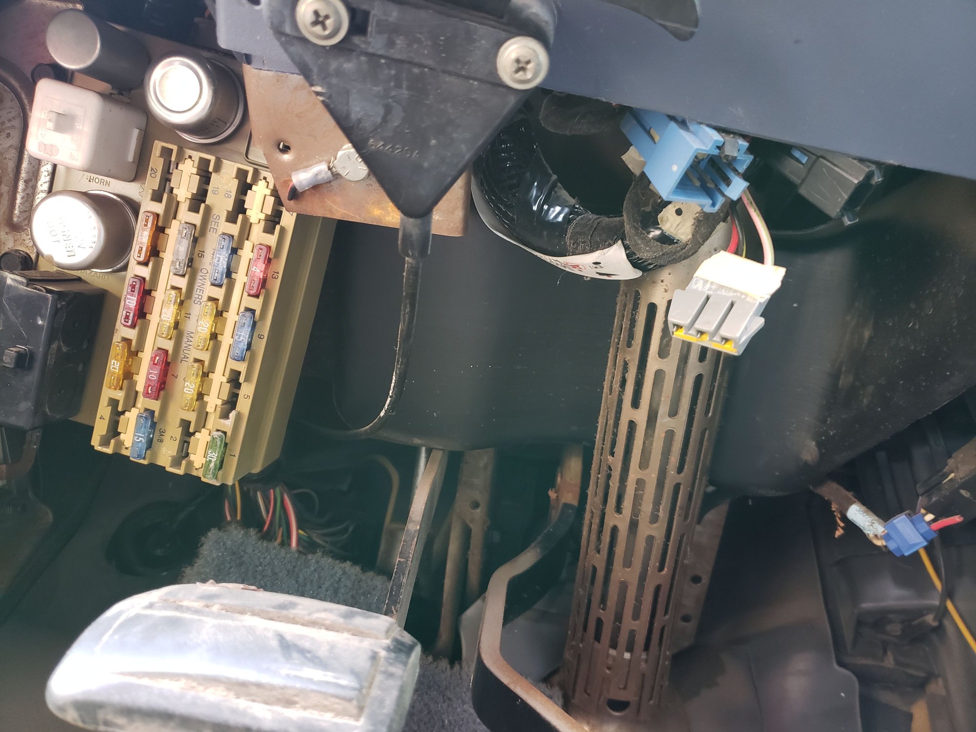

I have looked all over the internet for the code reader port on my 1996 Dakota V-8 4WD. It is not on the left side by the emergency brake lever....or anywhere's under the dash that I can see. I have also looked in the engine compartment and do not see anything that looks like a code reader. The key dance does not work either. Any help would be deeply appreciated.
I see nothing to plug it into
Nothing that fits
