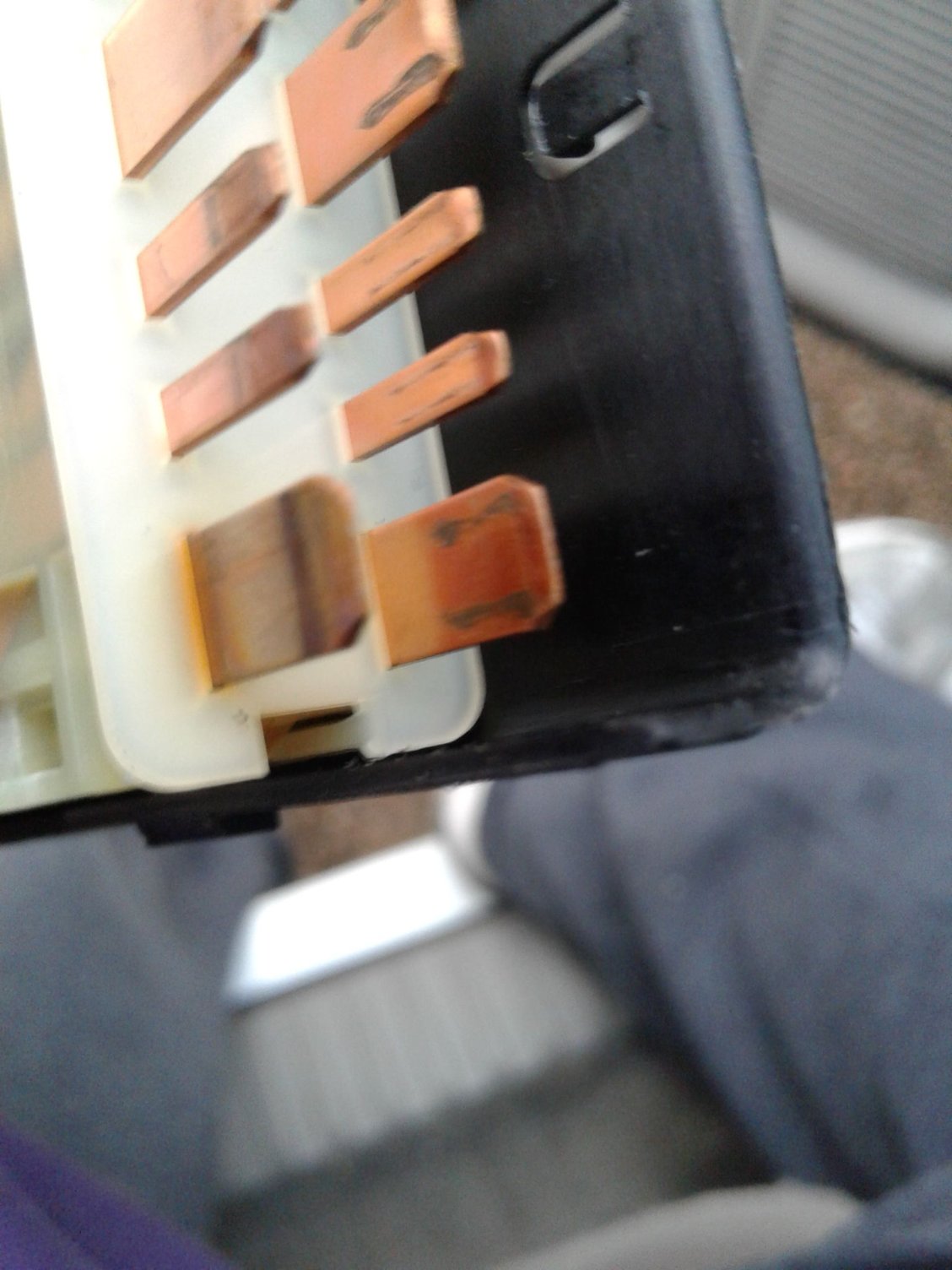

Keep in mind the contacts on the ignition module can wear down an cause it too..Mine was corroded .

You saying it can cause the blower motor to basically run itself out?
